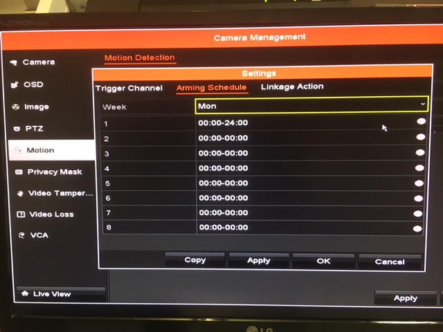

I put my sensitivity up to 60 for the camera and now it is recording events every two minutes. I was wondering if I kept it at 40 and put an intrusion line would this be possible? Can I do that with this NVR?

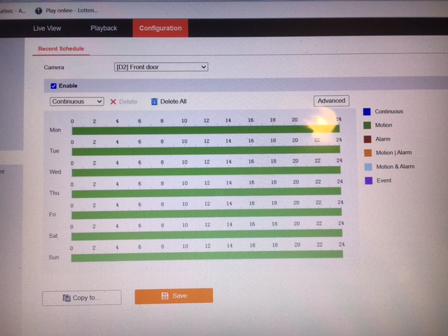

This is a picture of the setting. Not sure what to do with the arming schedule or what it does.

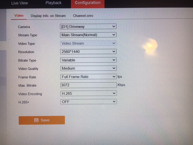

Also, when viewing any event via the hikvision app it freezes and then jumps a few seconds. Is there something I can do for that?
