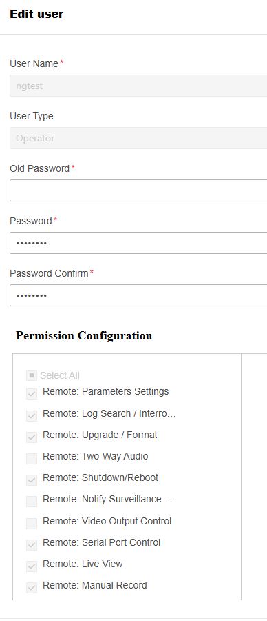

When you manually create the "ngtest" user on the camera as a normal user with any permission, and afterwards manage it through the Operation function from the NVR the user gets overwritten and gets all the permissions that you can see on the screenshot below. After you manage the camera throughe NVR you cannot log in with the "ngtest" user, even when you change the password of that users on the camera itself.

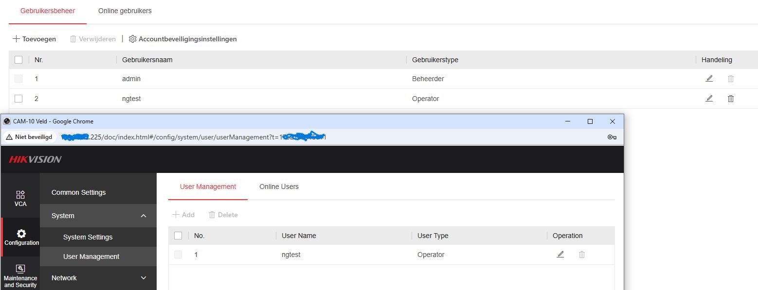

The front windows is the pop-up window when you manage a the camera from the NVR (it's the camera that you manage) .255 is the IP of the NVR, The window behind it (dutch) is the webinterface directly from the camera itself, showing the created users and the local admin.

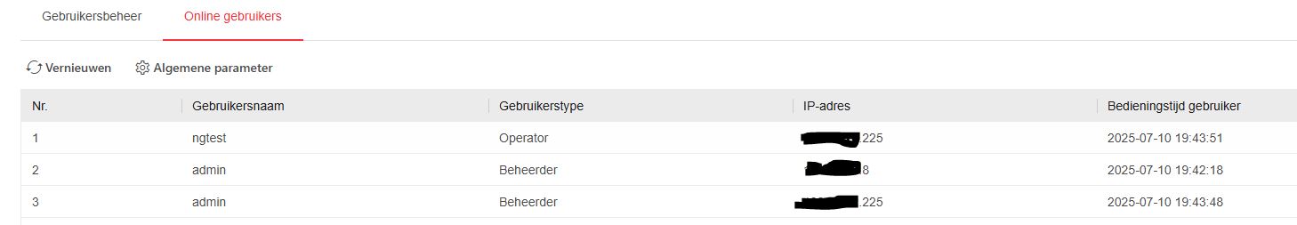

This is the online users list when accessing the camera directly, it is showing the "ngtest" user as "online".
These are the permissions the user has on the camera itself:
