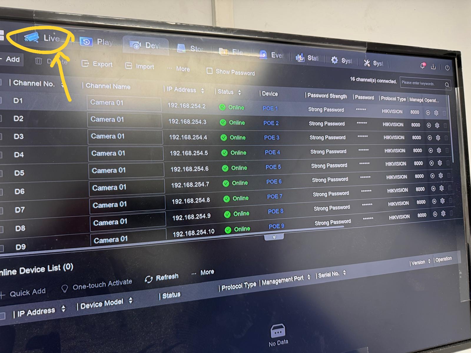

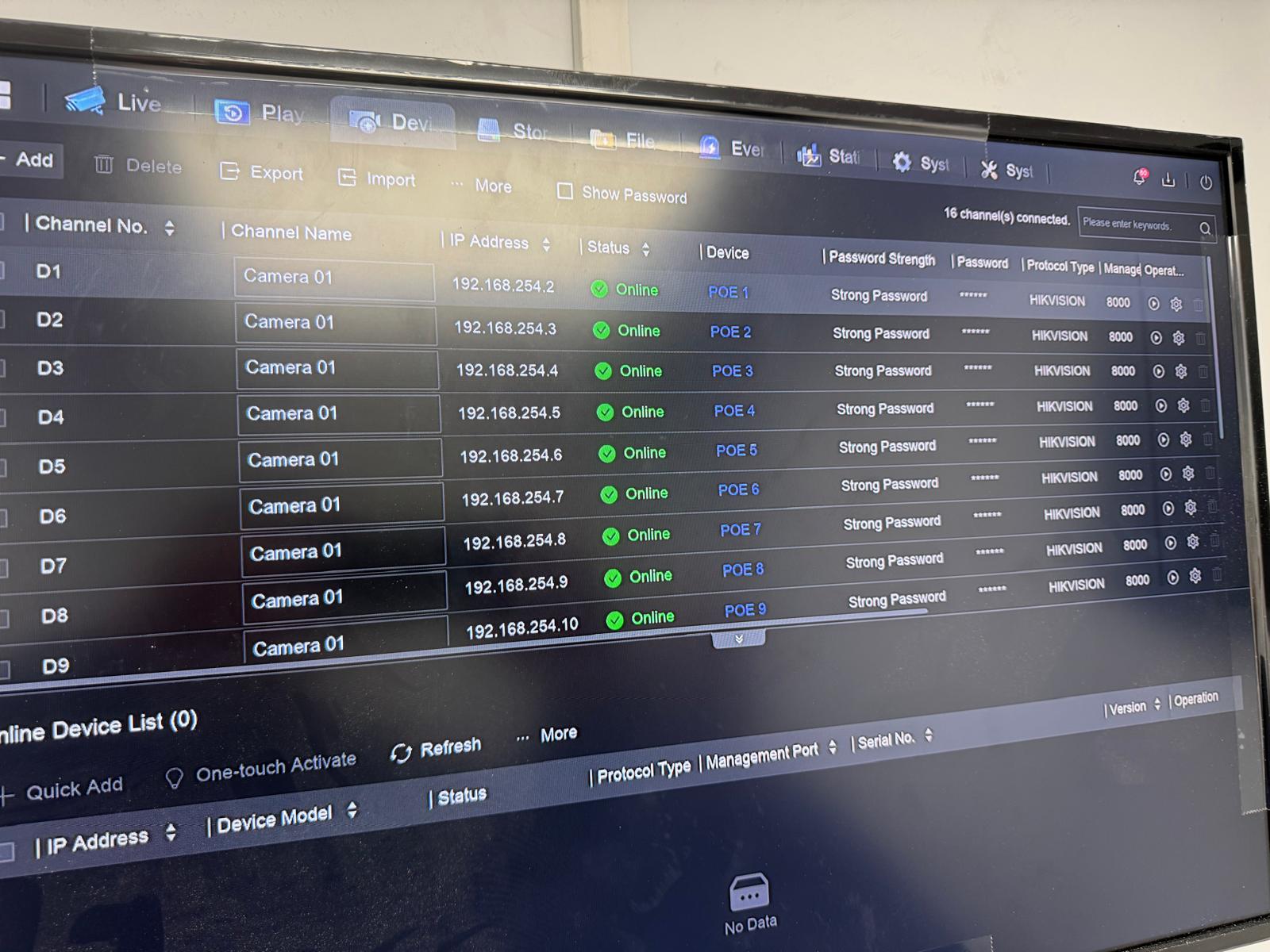

Hi there,
We just installed 16 IP cameras. We tested each cable before we set up the cameras; all was good,
but we had some issues. When we turned on the NVR, it wouldn't display any camera live on the monitor,
but all cameras were online, cause I checked them, and each one was showing online. Also, I can view one device operation,
which is plug & play. I never saw that before
I will upload the menu from NVR so they can show it online.
So please anyone have same issues with this NVR ..
Regards Nick

Hi @NickSM ...
Clearly, everything looks good on that "Devices" page... can you post a picture of the "Live View" page:

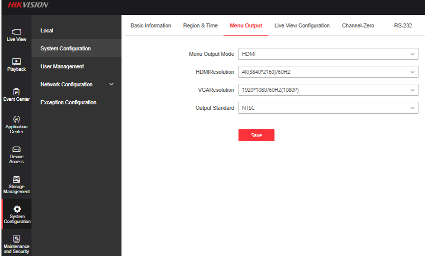

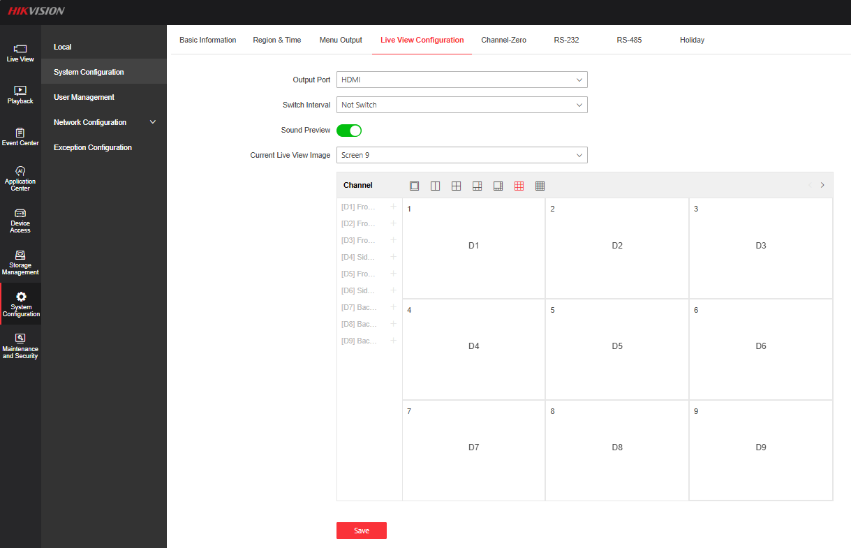

Also, if you can log into the NVR web GUI using a browser, can you post screenshots of the "Menu Output" and "Live View Configuration" screens:

Morning @johnfitzy
Thank you for quick respond literally the NVR are plug and play configure ,
Output mode it was auto ,Then I change to HDMI and reboot the NVR, Seems same issue
Live View Configuration I didn't check it was late last night tired raining and wet , should display straightway on monitor to be honest , Maybe any glitch etc
Anyway I will go this morning and have look again and I will upload screenshot from Live View configuration ,

It's likely you need to configure the Liveview page by adding what cameras you want displayed to each "box".

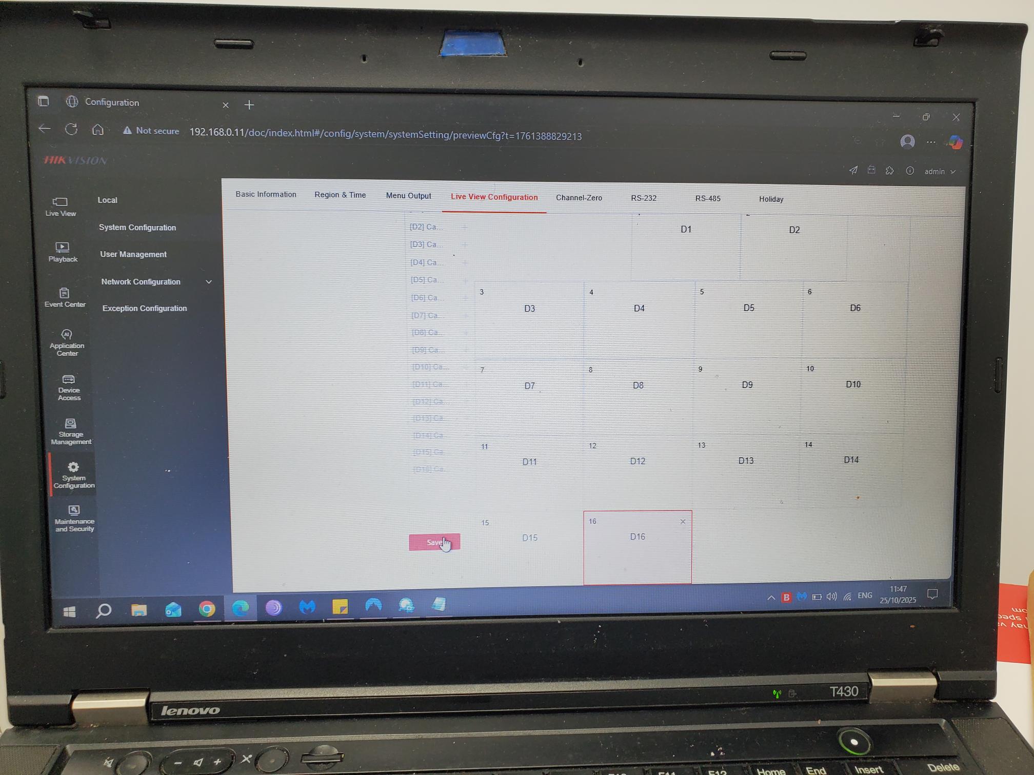

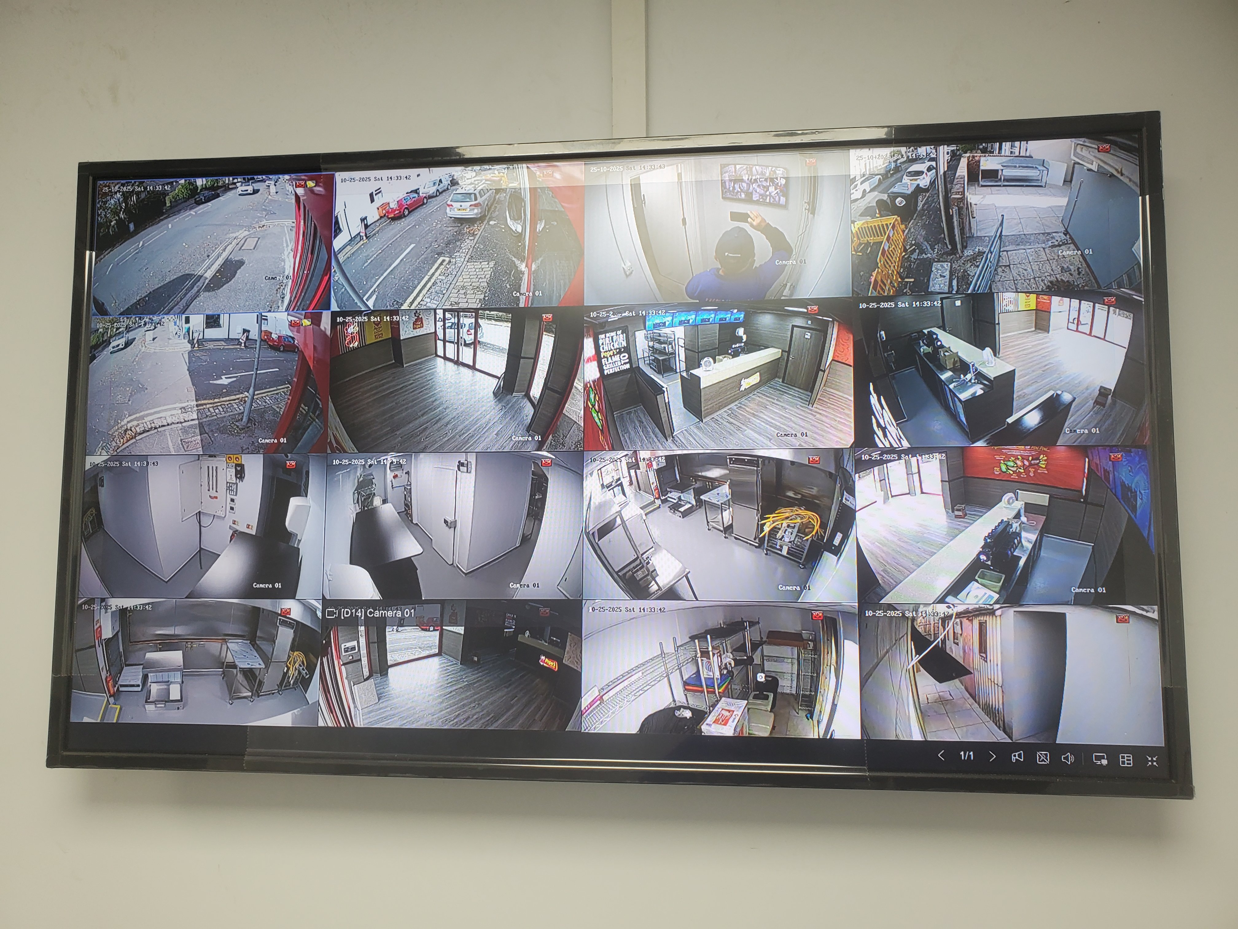

Hi John.
You were right
I have to go to the NVR main menu, "Menu Exit" and "Live View Configuration" and add the cameras one by one,
I thought they are factory default,
Thank you very much, have a nice weekend
Regards, Nick
