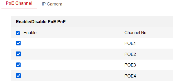

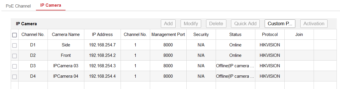

Yes, we would recommend checking the camera firmware, if all the cameras are plugged into the PoE ports on the NVR you can enable a feature called Virtual Host which will allow you login to each camera directly. You should then be able to see the current firmware and update the firmware in the maintenance menu (the same way as you did for the NVR firmware).
If you need help identifying the latest firmware, just post a list of the camera models you have and the current firmware versions each is running and we will link you to the correct latest firmware.
Hi Dan
I have two cameras both the same, model DS-2CD2335FWD-12.8mm
How do I get to see what current firmware is running?

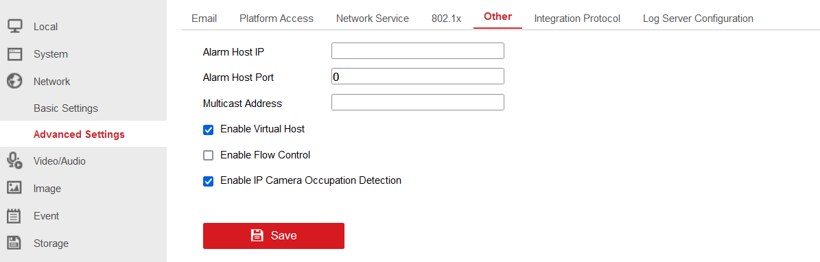

I mentioned Virtual Host in the above comment but didn't link you to the instructions on how to set it up, see below:
Virtual Host creates a link that allows you to log in to each directly connected camera, you will need a camera password to login to each camera and if the cameras were activated via Plug & Play when you first connected them to the NVR they should be using the same password as the NVR.

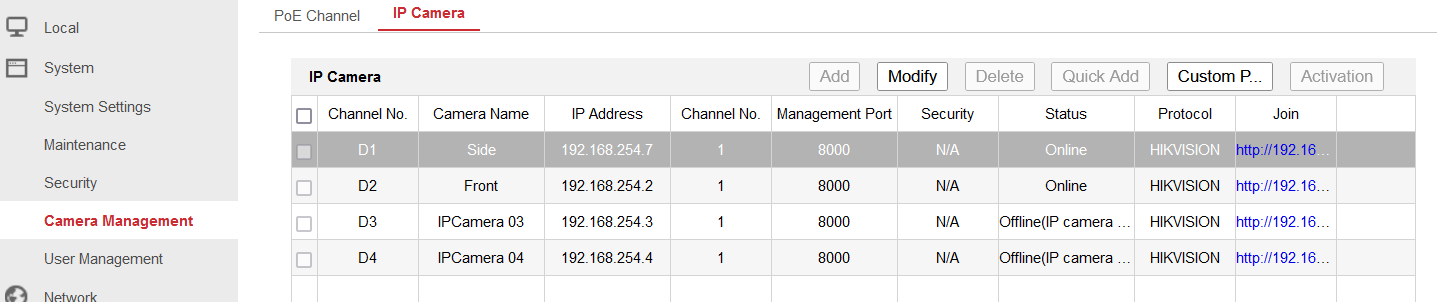

Hi Dan, following your instruction I can now see the camera IP addresses but cannot get by the Camera login. I have tried the NVR User and password and Hikvision default password “admin” “12345”. But still cannot login to the cameras. I am not sure if the CCTV installation guy set a password to the cameras or not.
The NVR IP is 192.168.1.64
Camera 1 IP is 192.168.1.64:65001
Camera 2 IP is 192.168.1.64:65002
The only thing I noticed when I ticked Enable Virtual Host the NVR did not reboot. So I rebooted at the NVR.
Any help would be appreciated

okay,
It sounds like your installer set a different camera activation password when they set up your NVR.
Are you able to access the NVR with a direct VGA/HDMI monitor?
This would be the easiest way to find out the password(s) of the directly connected cameras because you can go to the Camera menu, Click "Show Passwords", enter the NVR admin password, and the camera passwords should be displayed.
