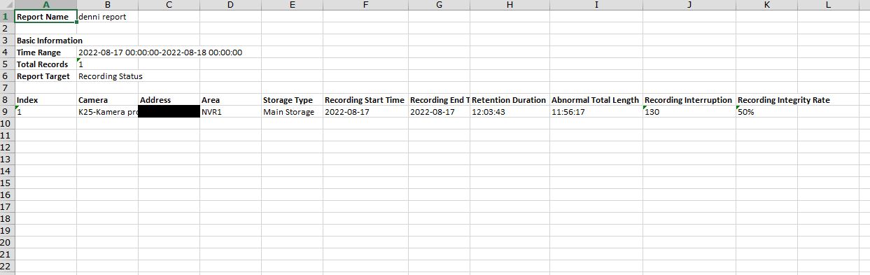

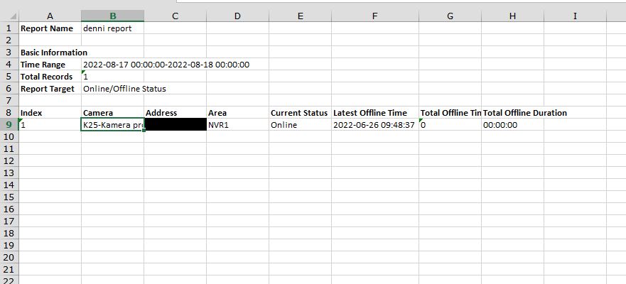

Hi, thanks for getting back to me. Here are screenshots of the following reports :
ResourceLogs_daily(hour)_RecordingStatus_20220817.xls
ResourceLogs_daily(hour)_OnlineOfflineStatus_20220817.xls
Reports are sent by separate emails, the same way as the people count report. Email account for reporting is setup in Hikcentral.

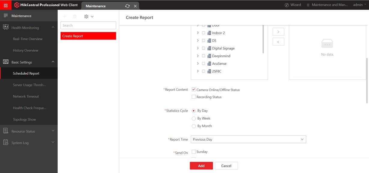

can I ask you to check the following section on HCP to see if you have any unwanted reports?
If you find any, you should be able to just delete them.
Hopefully, that should sort your issue.
Let me know if this doesn't help and I will ask for some more advice.
Hi, thanks a lot; It was exactly that!
I just deleted the report set up in the Maintenance and am assuming that'd be the end of it. More importantly now I know where it is.
