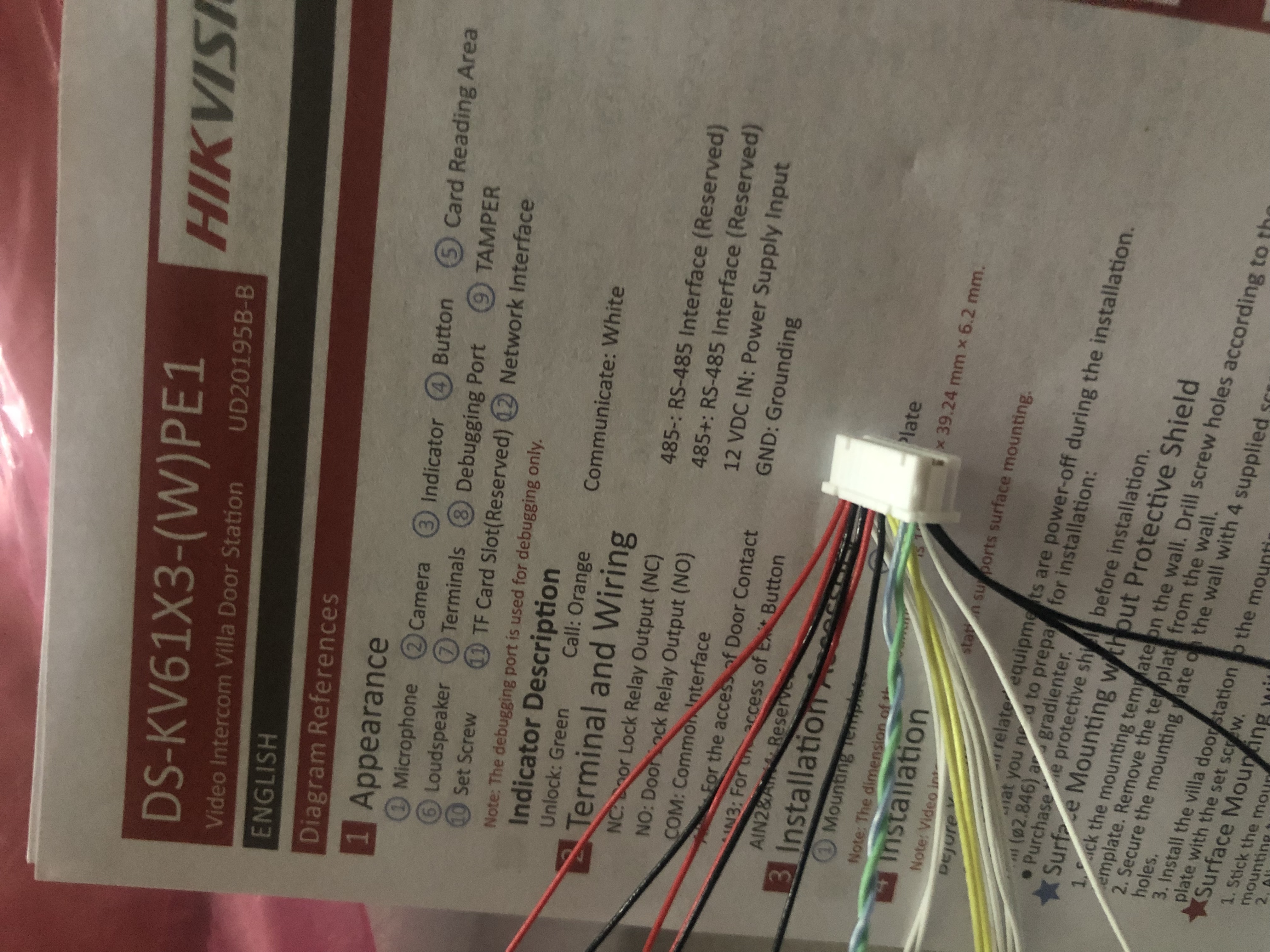

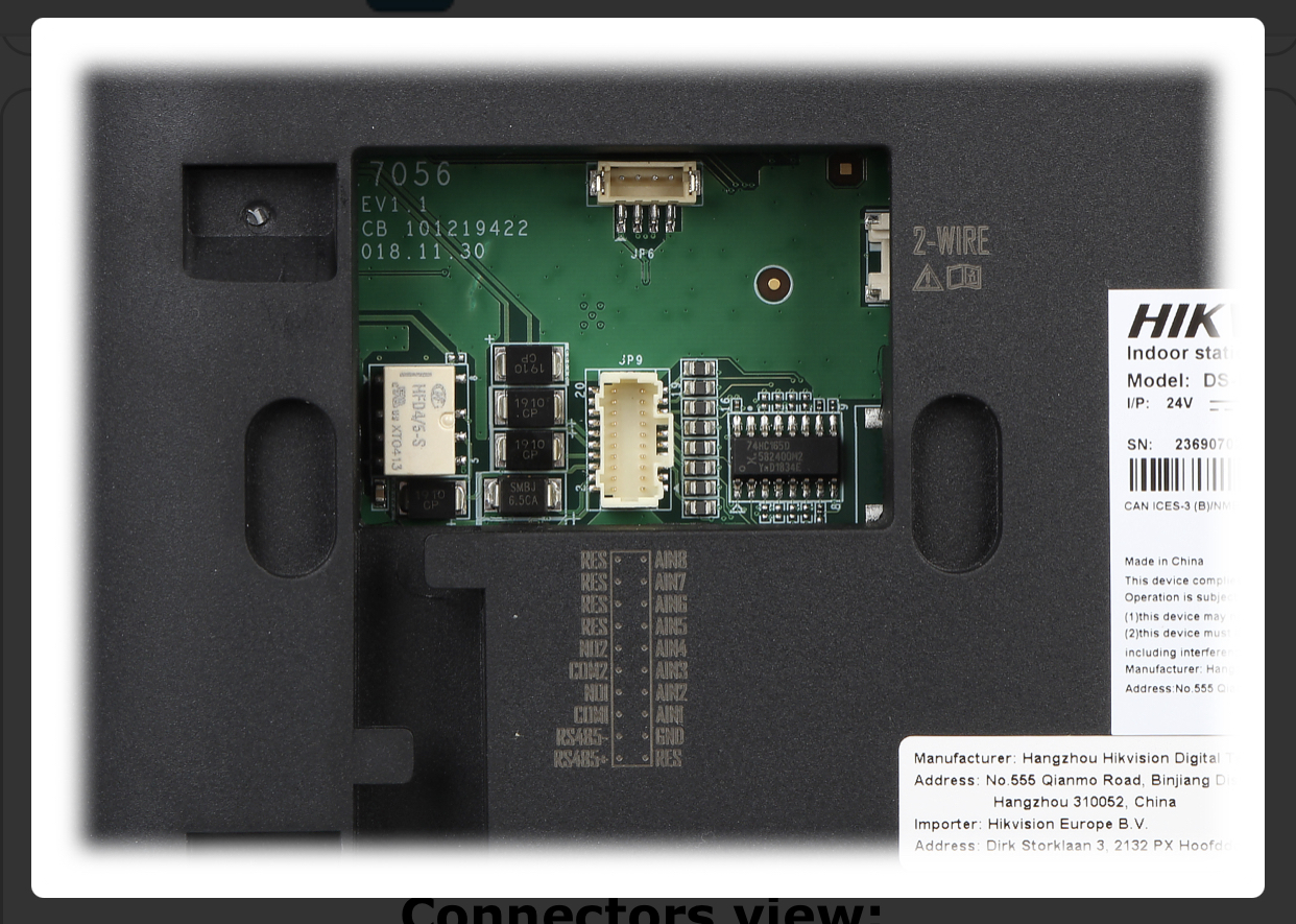

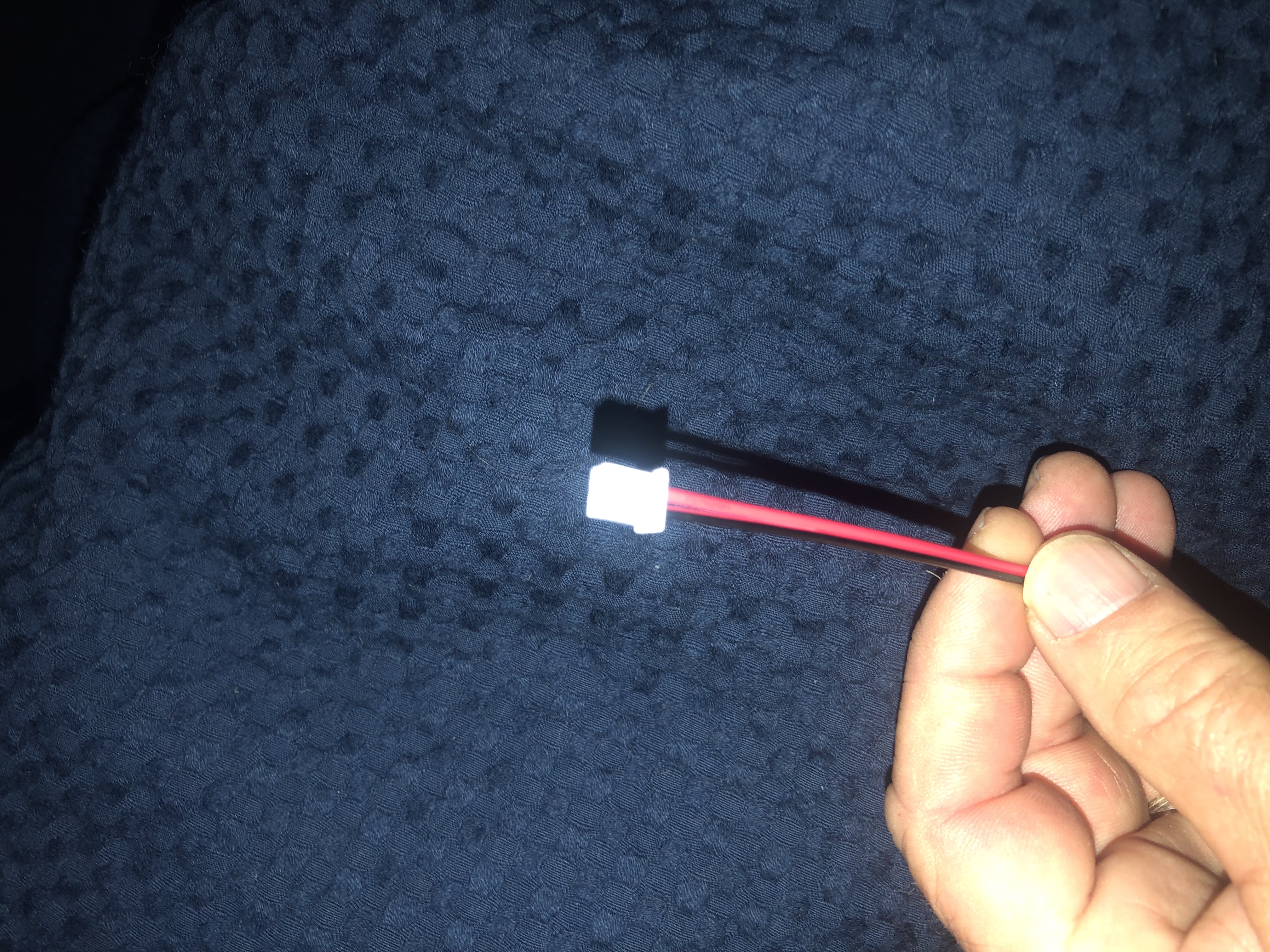

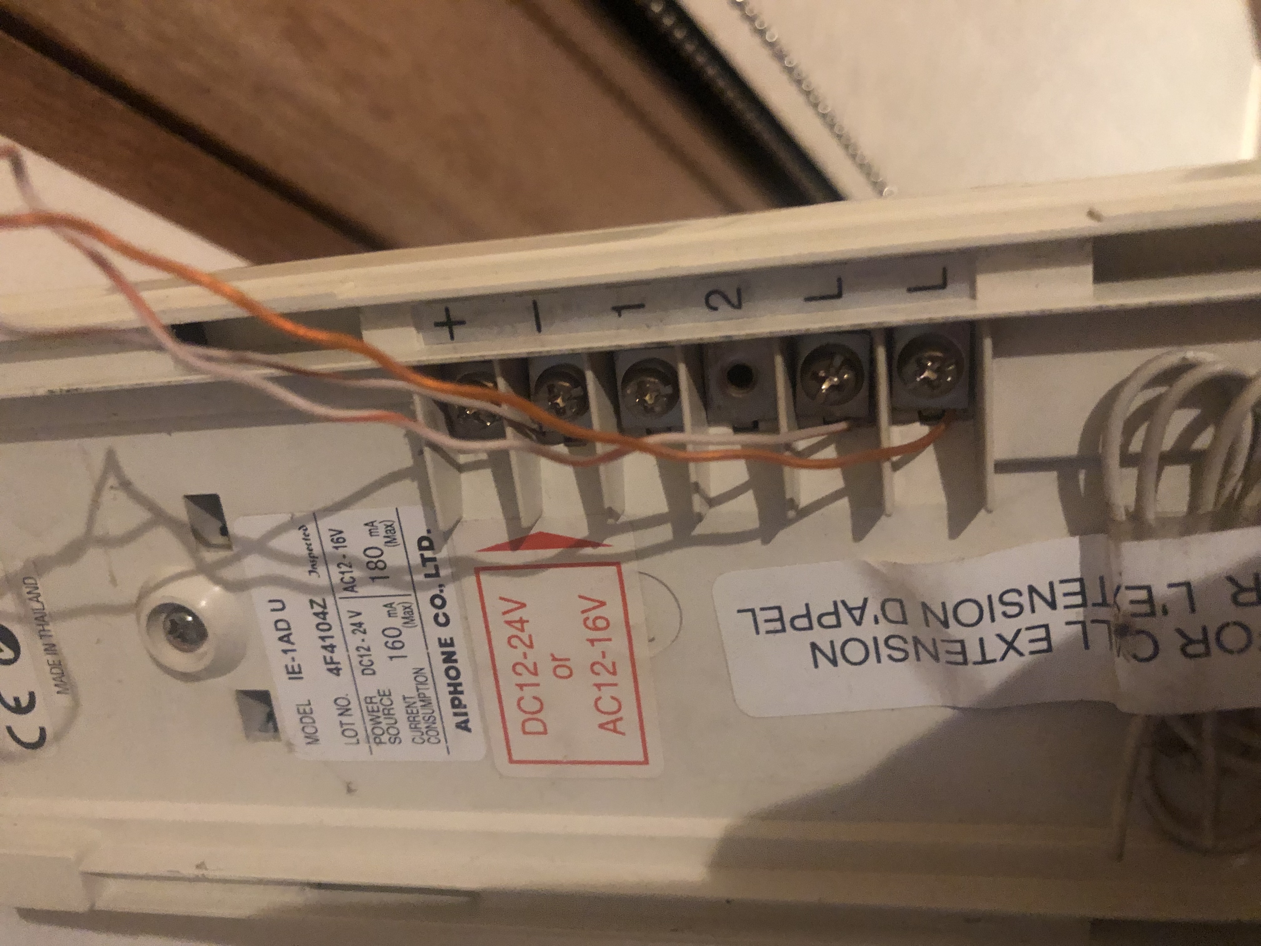

Hello Phil, which wires do I use to connect the gate to the hikvision indoor monitor ds-kh6320. I have the L & L wires from my old aiphone handset
