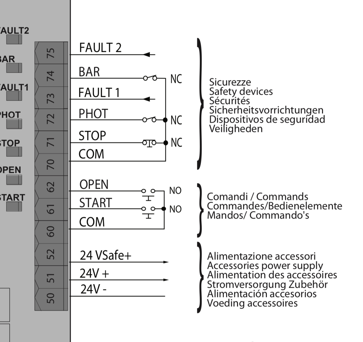

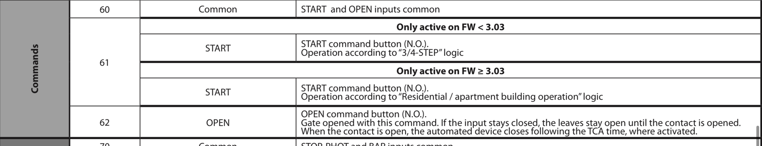

Hello,
Wondering if anyone can help - was working with my gate automation installer to connect up my Hikvision Intercom (DS-KD8003-IME1 unit to a BFT A600 sliding gate motor.
We can’t seem to get this working - tried NC1 and COM on the back of the intercom to 60+61 on the gate motor
Don’t suppose anyone knows where we are going wrong?

Sorry for the lack of response, did you work something out?
Does Gate installer knows how does opening triggers on device he sold you?
All i know NO COM on will give short for X amount of time configurable
and NC COM will stop short for X amount of time configurable
Play with short wire on gate motor and see what actually triggers it, once u find out, then you connect intercom
