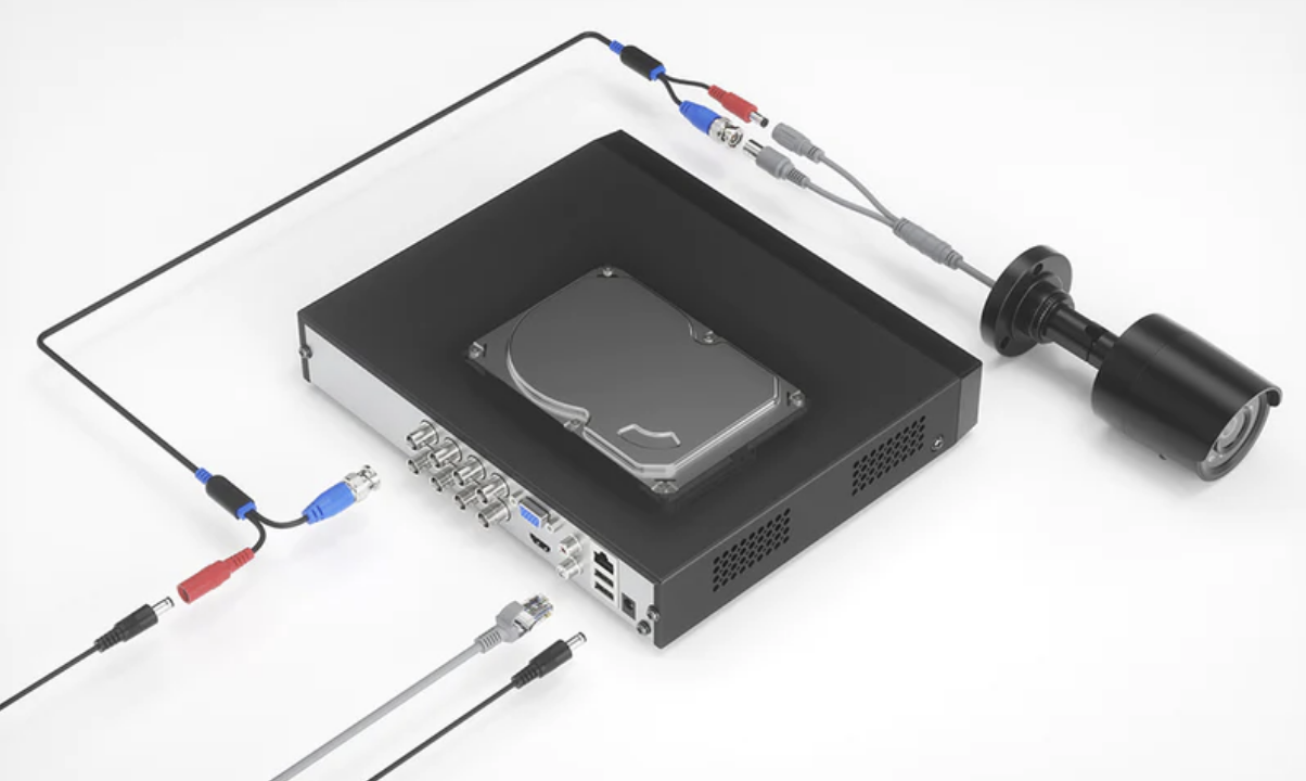

We don't have a huge amount of experience with analog kit, but looking at the below diagram from the Annke website for your DVR model it looks like the analog cameras need to receive power from a separate PSU.
I think this is pretty standard for most modern DVRs/Hybrid DVRs as most current analog cameras support either PoC (Power over COAX) or powering via a separate PSU.
