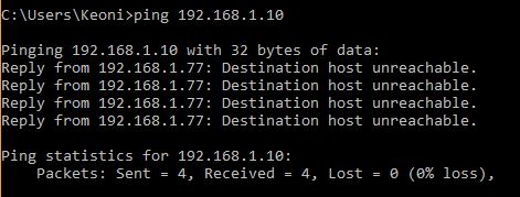

The final number of your camera/NVR's IP address is not set in stone like the other 3 and so you can set it to any number, from 1 to 254, now as most homes and workplaces have a lot of internet-connected devices you may want to double-check that the IP address you want to use is not already being used by another device on your network as IP addresses can't be used by more one device at a time. So to check an IP address you will want to re-open Command Prompt and type - ping {IP address} - and hit enter on your keyboard. (below are examples of an IP address that is already in use and a free-to-use IP address)
Successful ping (IP address is in use by another device)
Unsuccessful ping (IP address is free-to-use)
If the IP address is free-to-use then you can follow the steps that your camera/NVRs manufacturer asks you to do and assign the device the IP address that is available.
