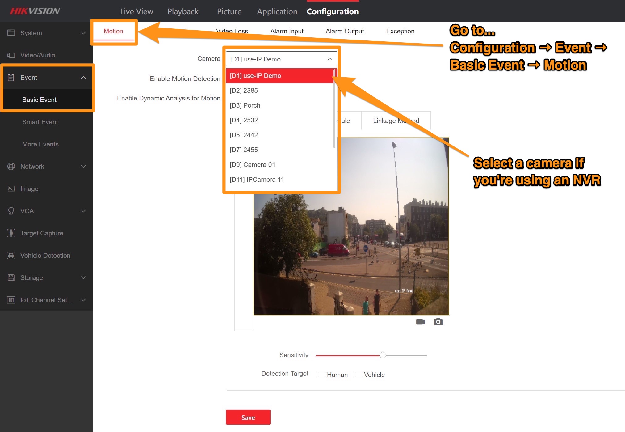

Once you’re in, navigate to:
Configuration → Event → Basic Event → Motion
If you’re using an NVR, select your camera from the "Camera" dropdown.

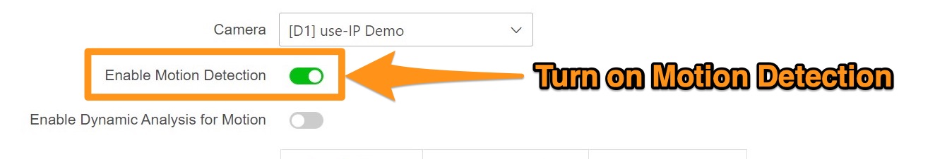

Tick the "Enable Motion Detection" box.

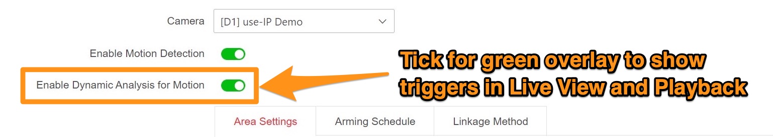

Decide if you want to enable "Dynamic Analysis for Motion". When this is turned on, green squares will show on anything that triggers motion detection in the camera's feed, which can help with identifying exactly what has triggered the event.
Note - Cameras usually determine what is 'motion' in your scene by detecting pixel changes in the image, as a large amount of pixel change usually indicates movement. However, if there is lots of visible noise in your image due to gain control in low light, you will probably see a high number of false alerts on the camera. Using one of the more advanced event types, or the camera's built-in LEDs to illuminate the scene, will help here.

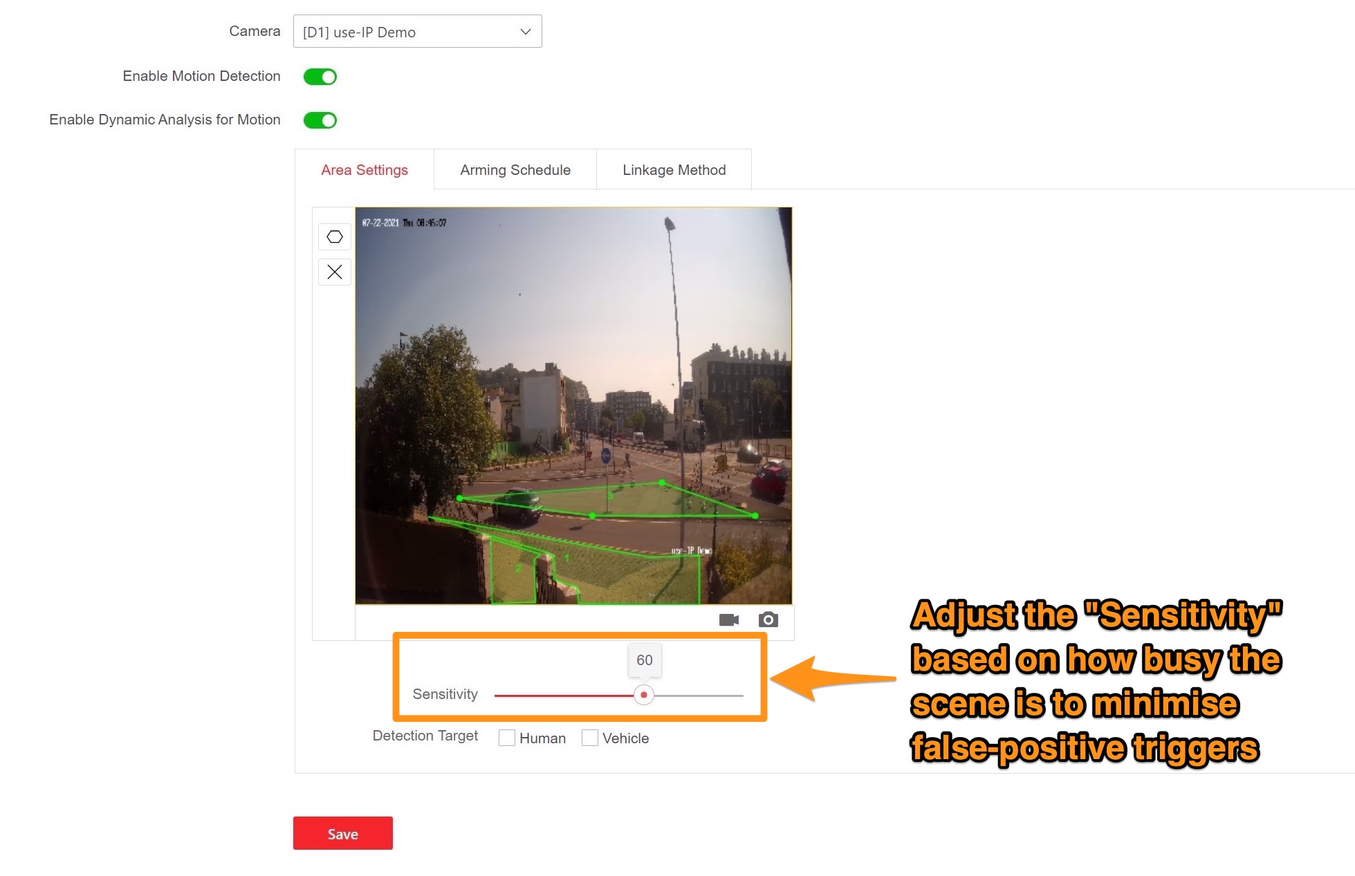

Once you’re happy with the view of your scene, click on the hexagon or "Draw Area" button in "Area Settings", which will allow you to use your mouse to draw the area within which you would like motion detection to be active.
On Easy IP 3.0 and earlier cameras, These areas will be indicated by a red grid or polygon that appears when you click on part of the scene.
The newer cameras will get you to draw one solid shape for each of your detection areas by left-clicking to set each point of that shape. When you have set all the points that you need, right-clicking will complete the shape and allow you to draw any others that you need.
To clear your zones, just click the cross or "Clear All" button.

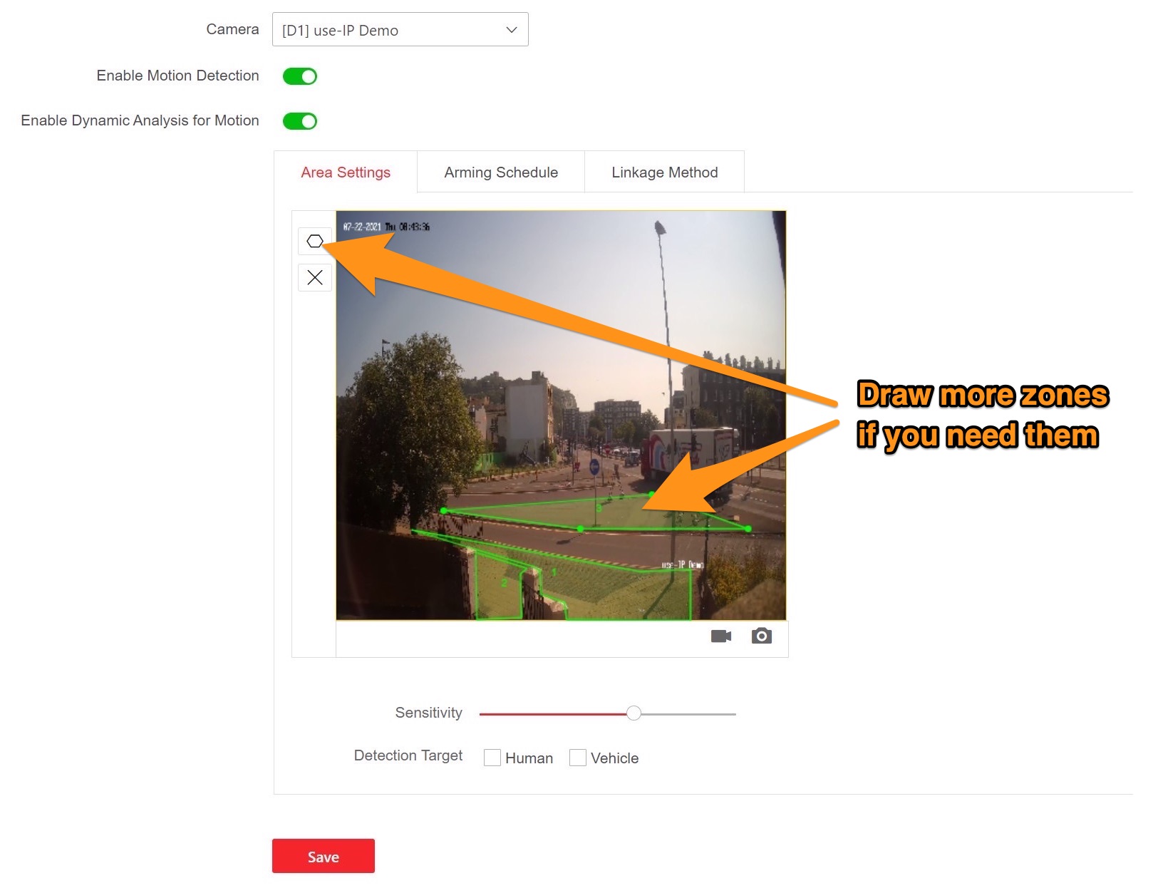

If you're using an EasyIP 4.0 camera, draw any more detection zones that you need by repeating step 5 above.

Adjust the "Sensitivity" bar if you need, which determines how sensitive the detection is to pixel changes. The higher the sensitivity, the more easily motion detection is triggered, meaning you will receive more alerts as a result.
A good starting point for the sensitivity is 60, but you will likely need to tweak this yourself over time to identify the optimum setting for your scene.
If there is lots of activity in your scene, then avoid setting the sensitivity too high so that you don't receive lots of false-positive triggers.

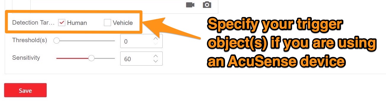

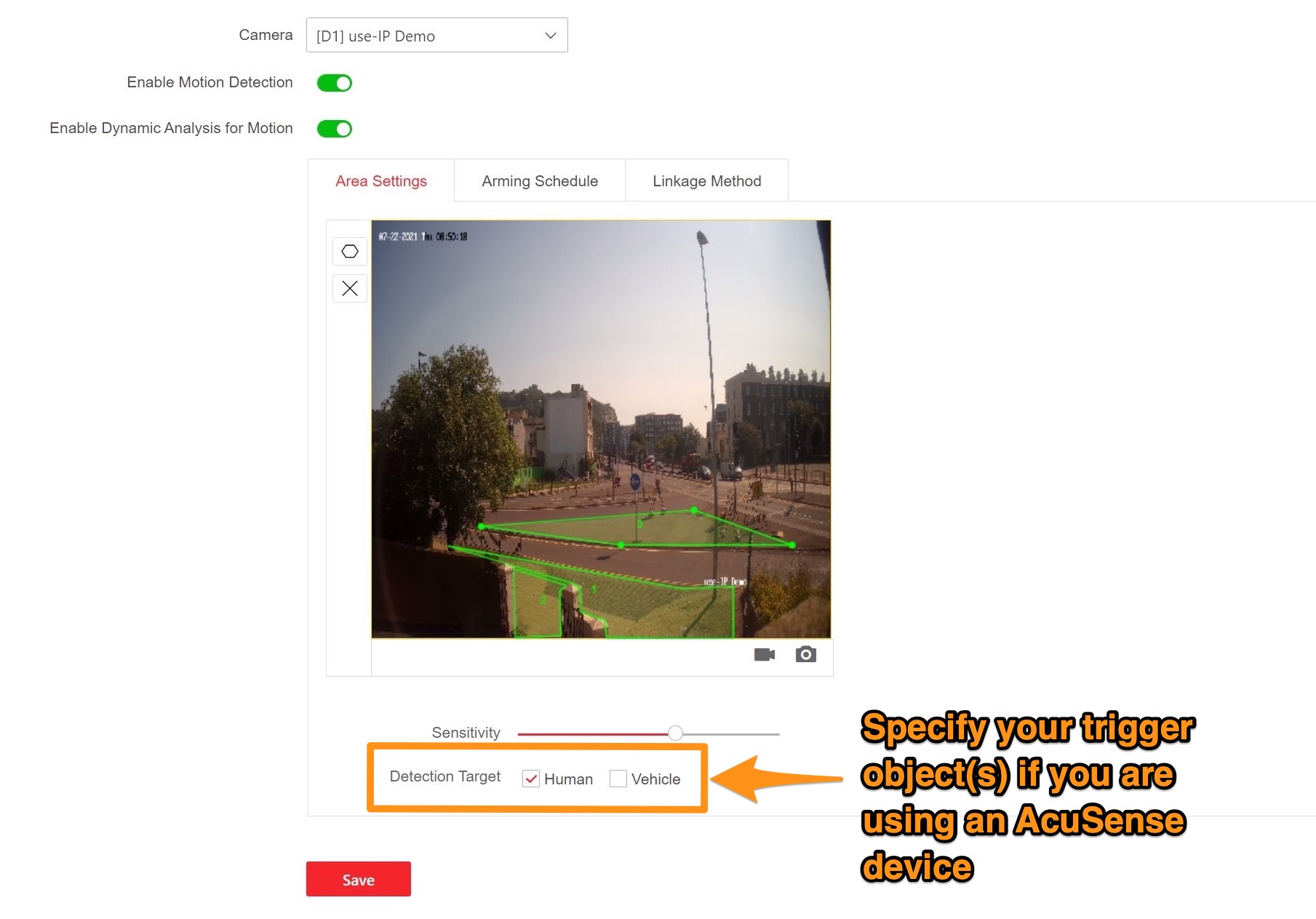

If you're using AcuSense features, then use the "Detection Target" boxes to specify what you want to trigger the event. You can select both "Human" and "Vehicle" here if you are interested in both.

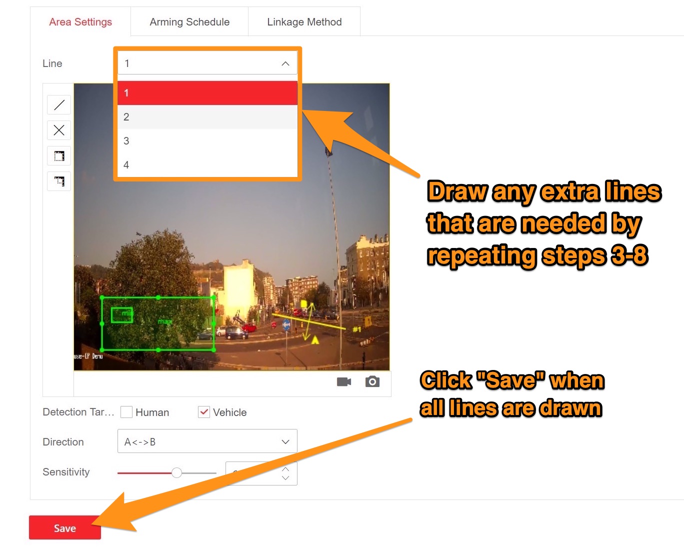

Section 2: Setting up line crossing detection
Step 1:
In a web browser, go to:
Configuration → Event → Smart Event → Line Crossing Detection
If you're using an NVR, select your camera from the dropdown at the top of the page.
Step 2:
Tick the "Enable Line Crossing Detection" box.
Step 3:
Click on the line button or "Draw Area" to draw your line on the video feed - you can move, rotate or resize however you like.
Step 4:

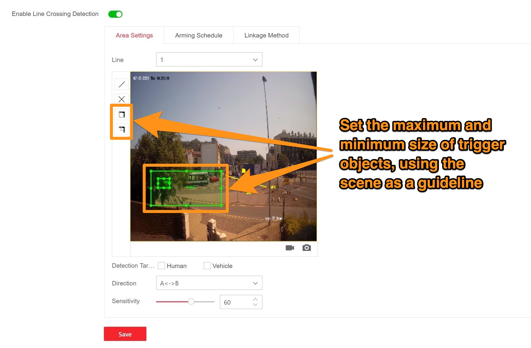

Set your maximum and minimum target sizes by clicking the size filter buttons, and drawing these on the camera preview.
Anything that crosses your line and is smaller than your minimum box, or larger than the maximum box, at the point of the line, will not trigger the event.
You should use objects or vehicles in the scene to guide you here. For example, I have set the minimum target size to be slightly smaller than any car that's near where I'll draw my line, and the maximum to be slightly larger than a large HGV.
Note - It doesn't matter where boxes are on the feed. Also, these boxes will only be visible on this event page, and will not show up on your footage in the live view or playback pages.
Step 5:
If you're using an AcuSense camera or NVR, then specify the "target(s)" that you would like to trigger the event by ticking the box. There is no issue with ticking both "Human" and "Vehicle" here.
Step 6:
Specify your "Direction", which refers to the direction from which an object much cross your line to trigger the event. The different options available are explained beneath:
A<->B - Any object crossing from either direction will trigger
A->B - Any object crossing from side "A" to side "B" will trigger (In this case, from left to right)
A<-B - Any object crossing from "B" to "A" will trigger (In this case, from right to left)
Step 7:

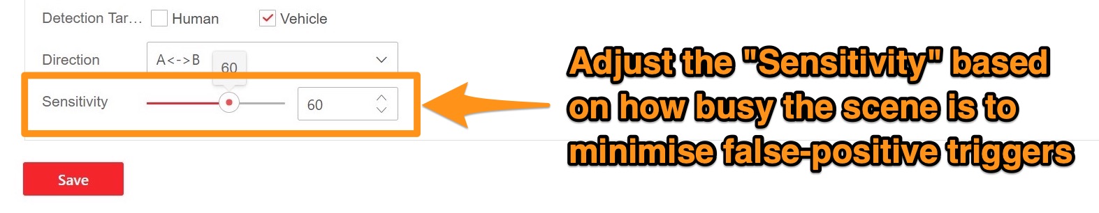

Adjust the sensitivity bar to suit your needs. Setting this high will reduce the amount of an object that is needed to cross your line before this is triggered. This will, of course, result in more triggers. As the optimum setting here depends on how busy your scene is, we recommend starting at 60 and then adjusting the bar over time until you find the best results.
Step 8:
Use the "Line" dropdown to select and draw any more lines, repeating steps 2-8 above.
Step 9:
Click "Save" at this point so that you don't lose these settings.
You'll now need to go to the "Arming Schedule" and "Linkage Method" pages to set when you would like the event to be active, and what you would like to happen on triggers.
Please refer to sections 4 and 5 below for instructions on how to set these things.

Adjust the sensitivity bar to suit your needs. Setting this high will reduce the amount of an object that is needed to enter your zone before the event is triggered. This will, of course, result in more triggers. As the optimum setting here depends on how busy your scene is, we recommend setting this to 60 and then adjusting the bar over time until you find the best results.

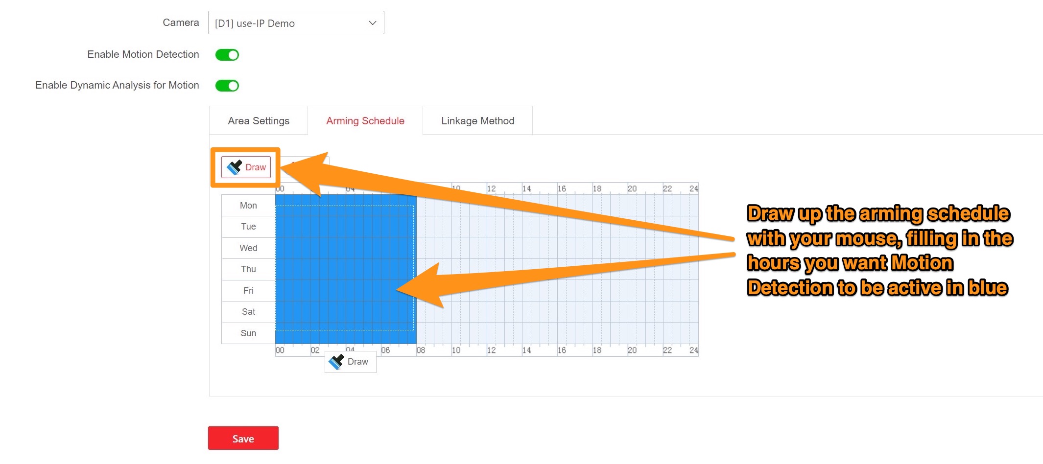

Section 4: Setting the Arming Schedule for your events
Now that you have set your "Area Settings", click on the "Arming Schedule" tab to set when the event will be active.
This will bring up a timeline with the week broken up into days and hours - depending on the device that you are using, it might look different to the grid below. If a period is filled in blue then the event will be active (or "armed") for that hour; If the period is white, the event will be off.

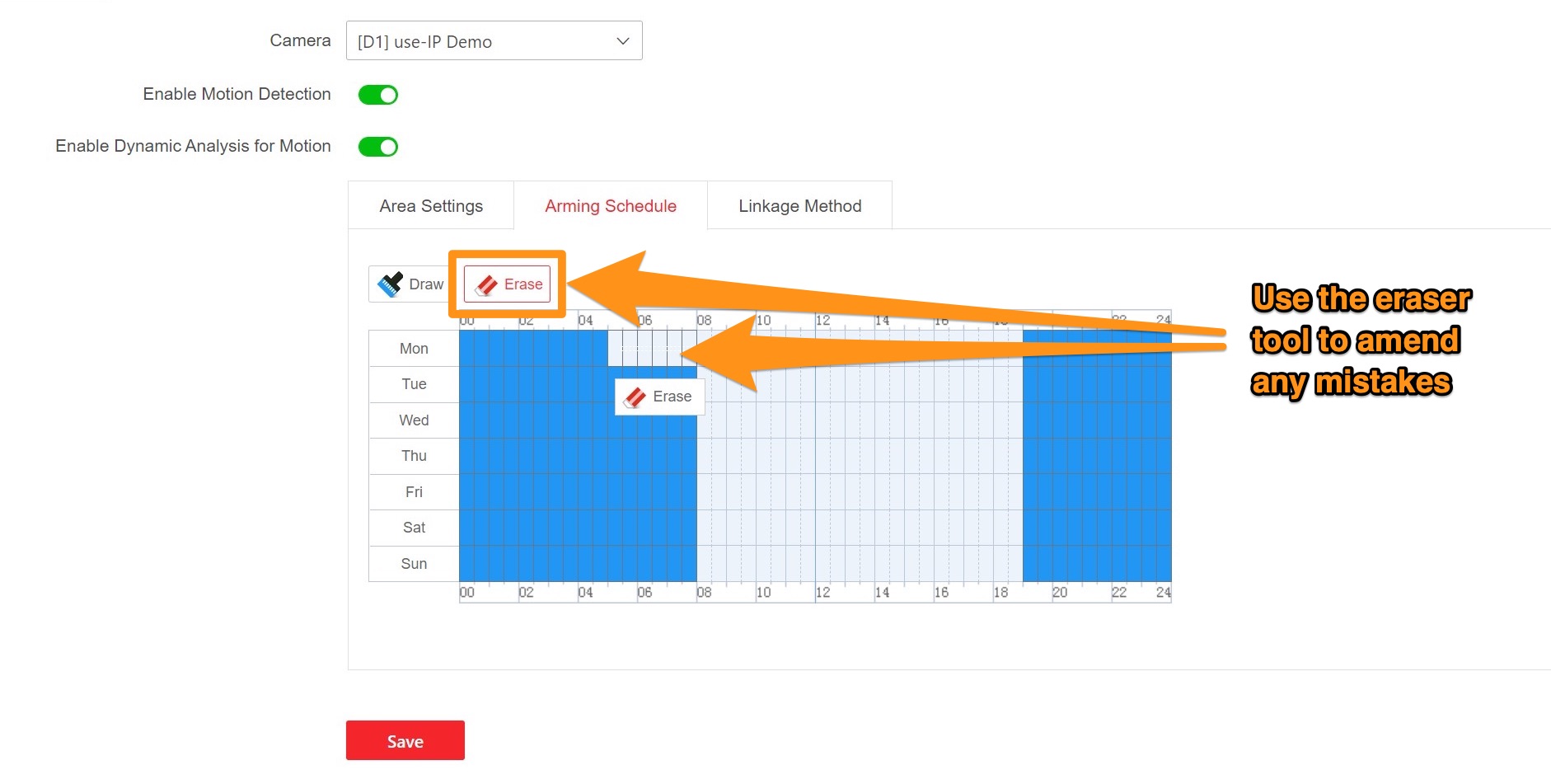

Use your mouse to draw up the weekly Arming Schedule that suits. You can also use the popup box that appears when you click on any blue period to finely adjust the start arming times:
Clicking on the "Erase" button and then a blue period will allow you to clear the arming:
When you’re happy with this schedule, click "Save".

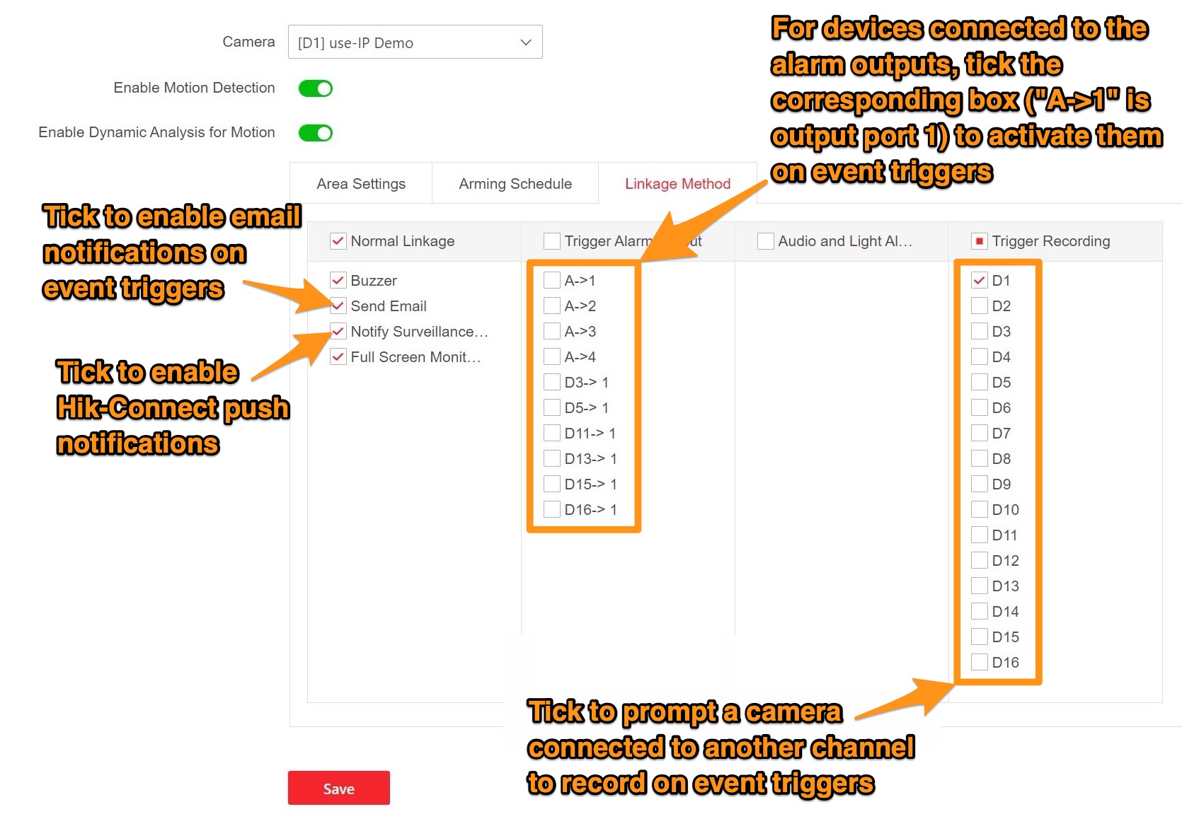

Section 5: Setting up email & push notifications for your events
Click on the Linkage Method tab on the event's page (shown above), which is where you will set up your email notifications, as well as other alert types.
The different options are explained below:
Audible Warning: This will cause the NVR / browser to bleep when on event triggers.
Send Email: This will set the NVR to email you on event triggers, with a screenshot of the camera’s view at the time.
Notify Surveillance Centre: This refers to Hik-Connect and needs to be activated in order to receive push notifications in Hik-Connect.
Full Screen Monitoring: This will get the NVR to automatically throw up a camera’s live feed in full screen during a trigger for an event set on that camera.

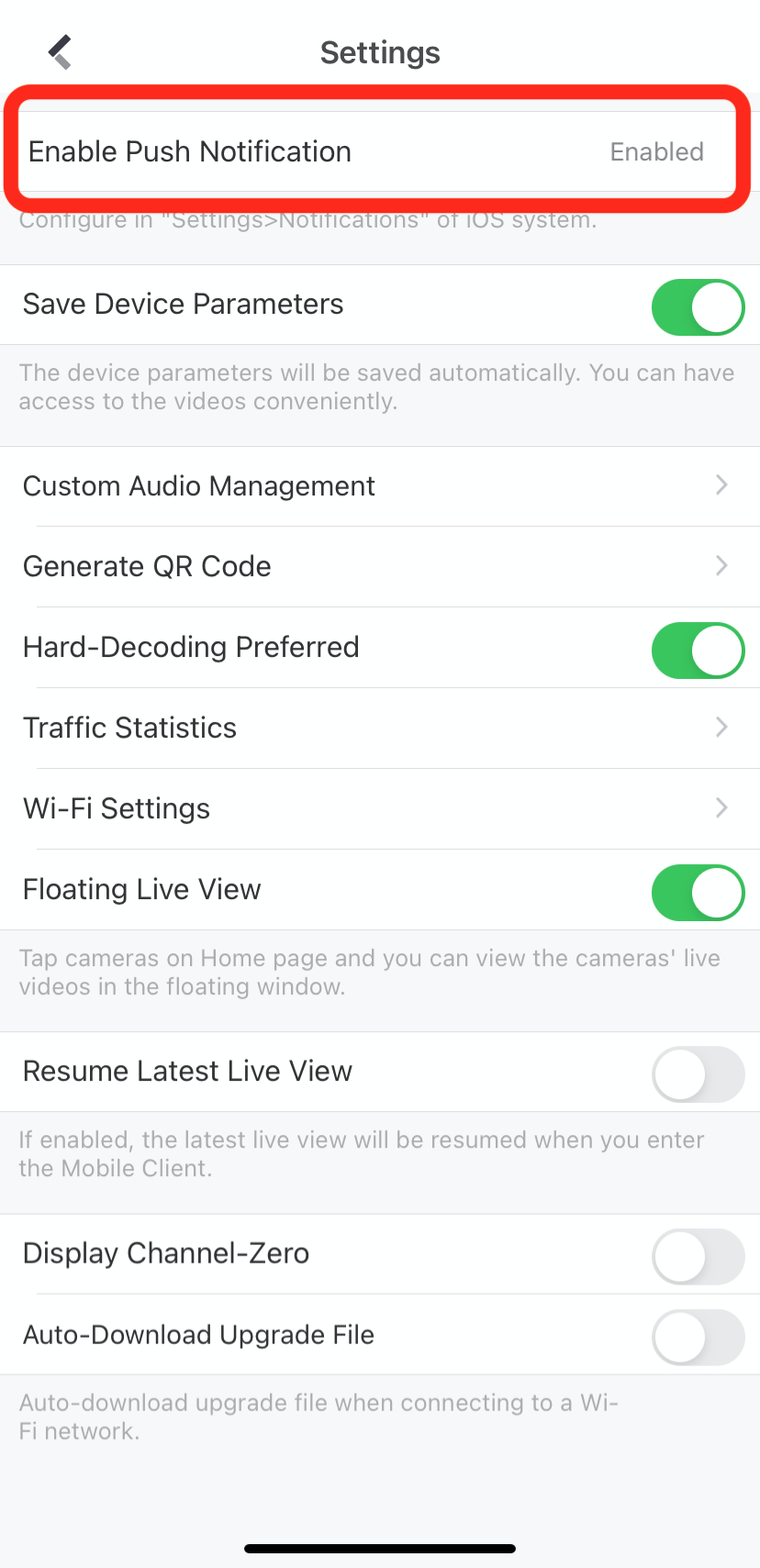

To enable Hik-Connect push notifications:
To set up push notifications, you need to make sure that Notify Surveillance Centre is ticked as a "Linkage Method".
You also need to make sure that push notifications are enabled for Hik-Connect in your phone's settings. To enable them via the app, go to:
More → Settings → Enable Push Notification
NB - Please see here for instructions on getting a device added to your Hik-Connect account and using the app, which you will need to have done for push notifications to work.
