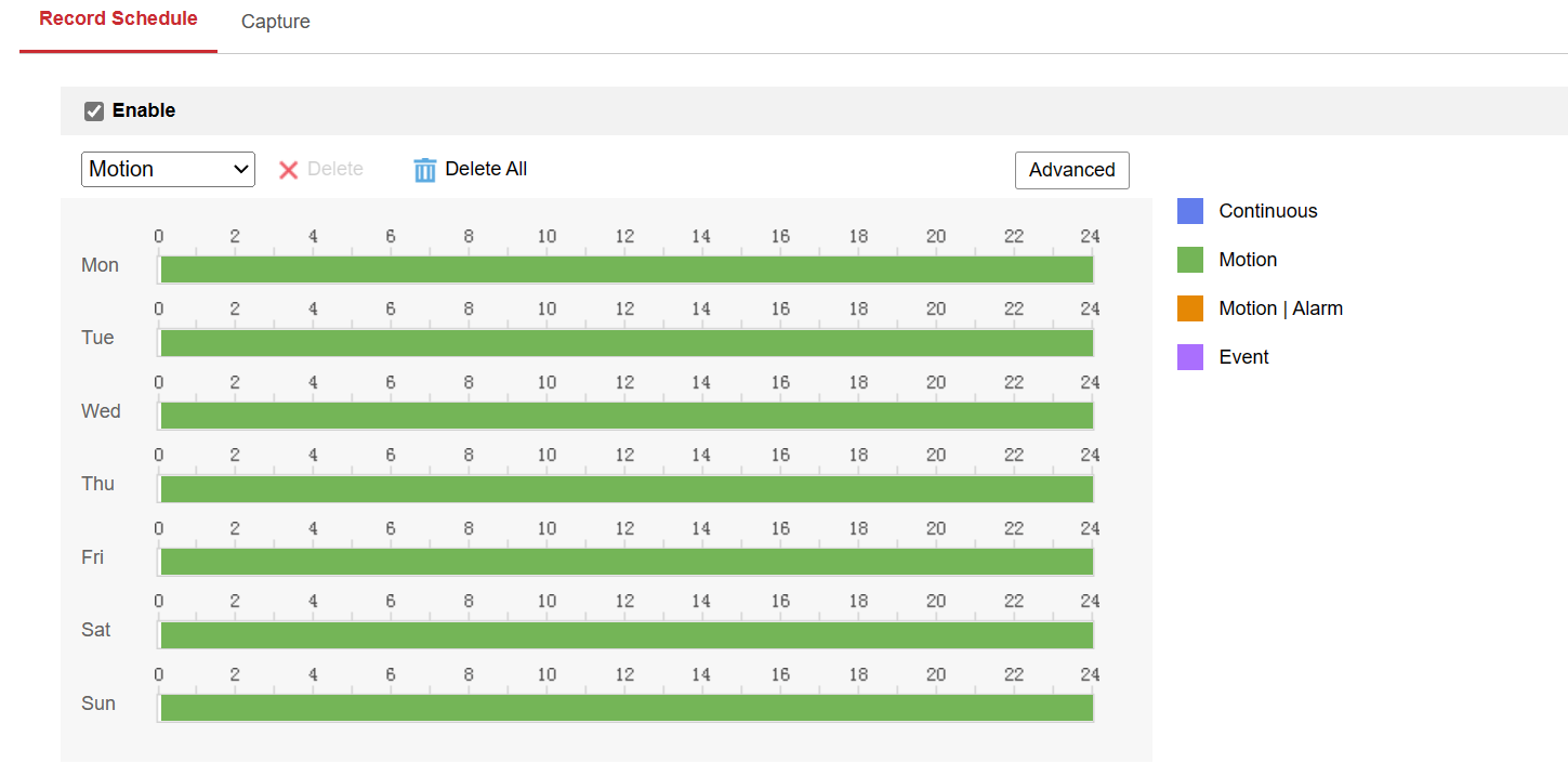

Thanks for testing that - there may be another event enabled that is causing footage to be saved for all types of movement.
Make sure you only have motion detection enabled, as well as one smart event (line crossing or intrusion detection).
Then, in Storage>Schedule Settings>Record Schedule, set the schedule to "motion" for the whole week (so that every day is filled in green), like below:
In Storage>Schedule Settings>Record Schedule, I do not configured with "Motion" but with "Event".
From what I understand from the User Manual :
Continous
The video will be recorded continuously according to the schedule
Motion
When motion detection is enabled and trigger recording is selected as linkage method, object movement is recorded.
Event
The video is recorded when configured event is detected.
So for my understanding, "Motion" has to be used only when we want to record for basic event "Motion detection".
Others point, in my configuration I have
-Motion detection enabled
-Intrusion detection enabled
-line crossing enabled
-Region entrance detection enabled
-Detect scene change enabled
