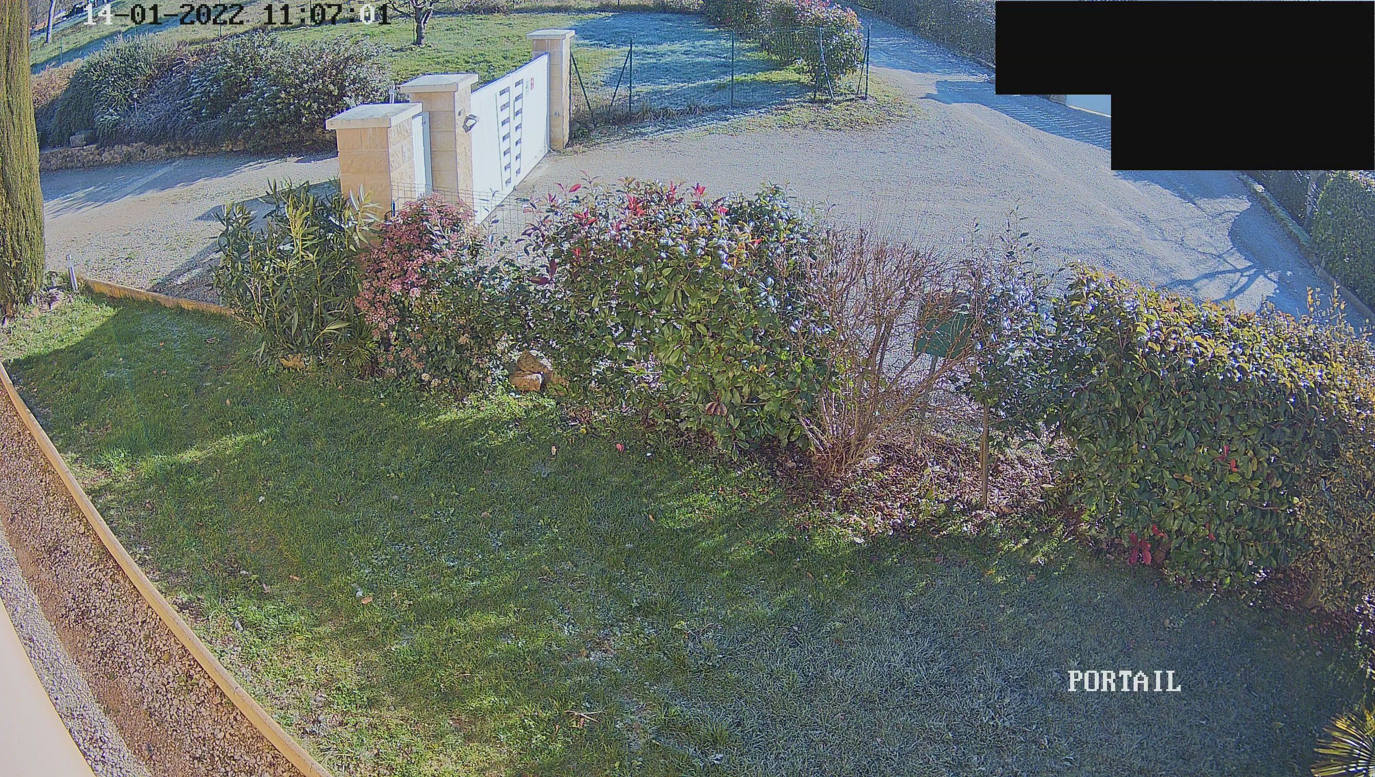

I try to adjust my image with HLC because the white portal dazzles the camera a little.
i have enabled HLC but it makes the picture a bit smooth, you see?
how to perfectly adjust this image?
do you have an idea?
Hi @JulioFr1ch
The other settings we would recommend trying are WDR and increasing the exposure time (e.g. 1/50, 1/100, maybe more).
Both these settings should give some reduction to the brightness of this hotspot you are seeing, but you have to be aware that all adjustments you make will affect the whole image and may have negative effects on other parts of the scene. Perfecting the image settings is really a balancing act and sometimes you have to decide to lose detail/clarity in one part of the scene to gain better image results in the most important part of the scene.
