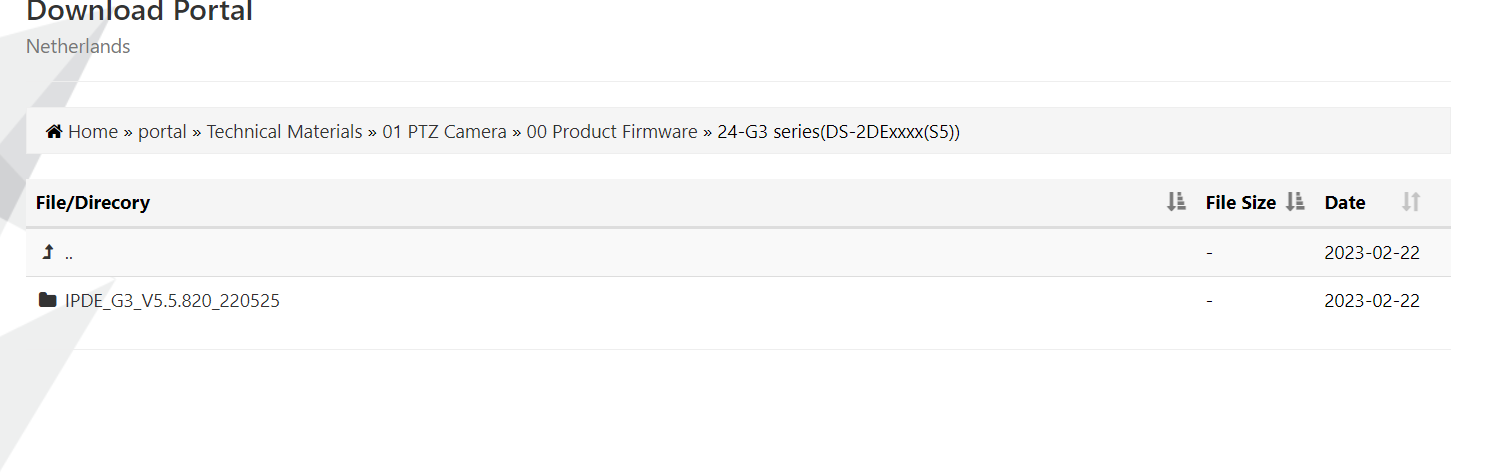

Hello,
i´ve downloaded the firmware from the download portal europe ( see pic below ) and installed it. After that the camera was dead. After about 2 months, I thought I'd try to see if anything was working at all, so I disassembled the camera a bit. I saw that the led in the camera lit up parallel to the led on the laptop and thought I'd look on the web to see how I could possibly make contact with the camera. I came across Hikvision TFTP loader...that was the first time I saw that the camera was still communicating. However, I could not load the firmware with the TFTP programme because the file is too big. So I found the method with python and after 3 days of desperate work it worked.

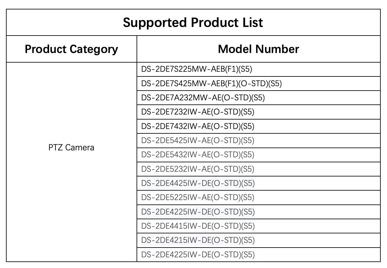

That explains it then, that firmware is for specific DS-2DExxxx(S5) models and if you look at the release notes from that folder you will see the below table of cameras that use that firmware.
Your model is not supported by this firmware because although your part code does start with DS-2DE, your model actually uses a specific DS-2DE3Axxx(S5) firmware which can be found HERE
You will see that firmware that you are currently running is actually newer than the firmware in the download portal, this suggests that either your camera was shipped with a newer firmware already installed or it has a custom/region-specific (e.g. non-UK/EU) firmware installed.
The confusion is not your fault, as Hikvision has rolled out more new models and upgraded versions of existing models (e.g. S5, S6, T5) the number of firmware versions and firmware families/categories has increased and become more and more specific to a smaller number of models (e.g. that firmware I've linked to above is only applicable to the 2 or 3 Hikvision ColorVu PT cameras).

at the EU ( Netherlands ) Download Portal you can´t find any Firmware for DS-2DE3A400BW-DE(F1)(S5) (B). I found that Firmware_V5.5.803_211112 at the Philippines ( English ) site. I thought it is a newer Version, so i upgraded it and all works fine ( NOW ).
