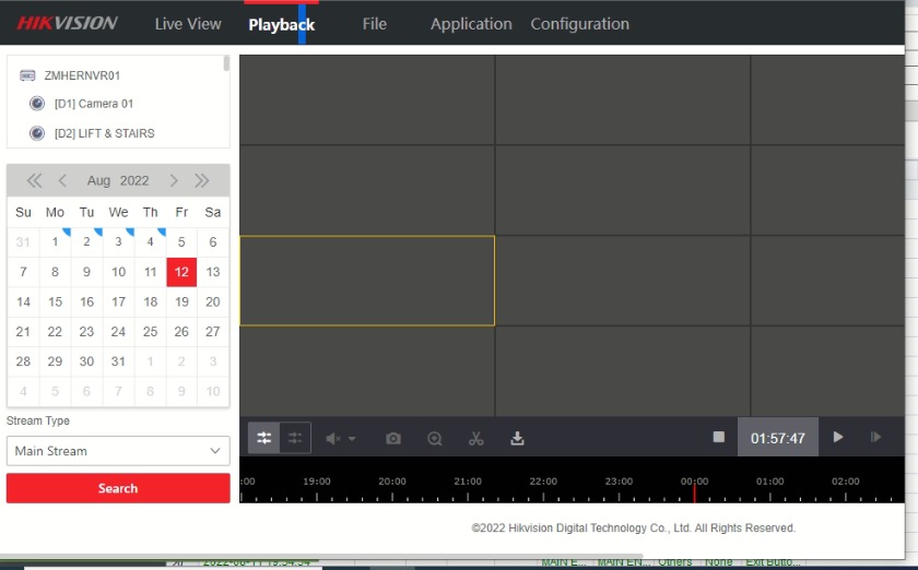

Firmware is V4.61.101 Build 220527, i upgraded it yesterday but still no change, i even reset all the recording settings this morning.
Perhaps share a screenshot of the storage / overwrite settings?
Yes, and can you also confirm that you have checked playback to confirm the recording has stopped? Can you share a screenshot/photo of your playback menu? Are there definitely no recordings showing today?
screenshot.
Hi @Nimrod
You have posted the same image in response to both questions.
It does look as if recording has stopped.

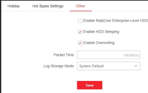

Can you share a screenshot that shows that overwrite is ticked please?
if you are unsure where to find the overwrite setting it is under Configuration > Storage > Advanced Settings > Other
