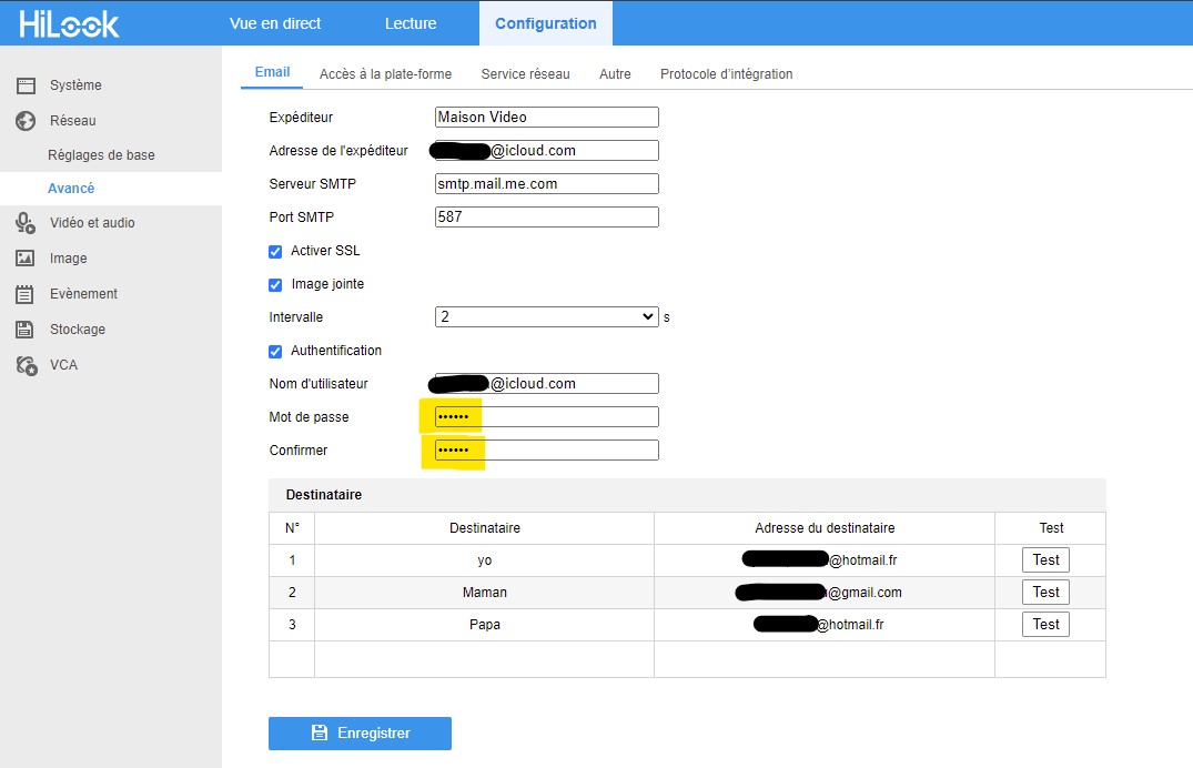

Hello,
Here my config to received mail form DVR

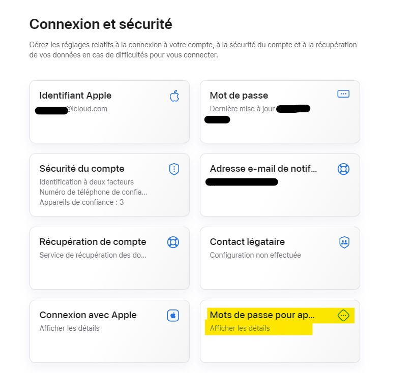

Mail From apple
Yellow highlighted is the APP password , You have to create an APP password from icloud
iN black highlighted it's my personal adress
