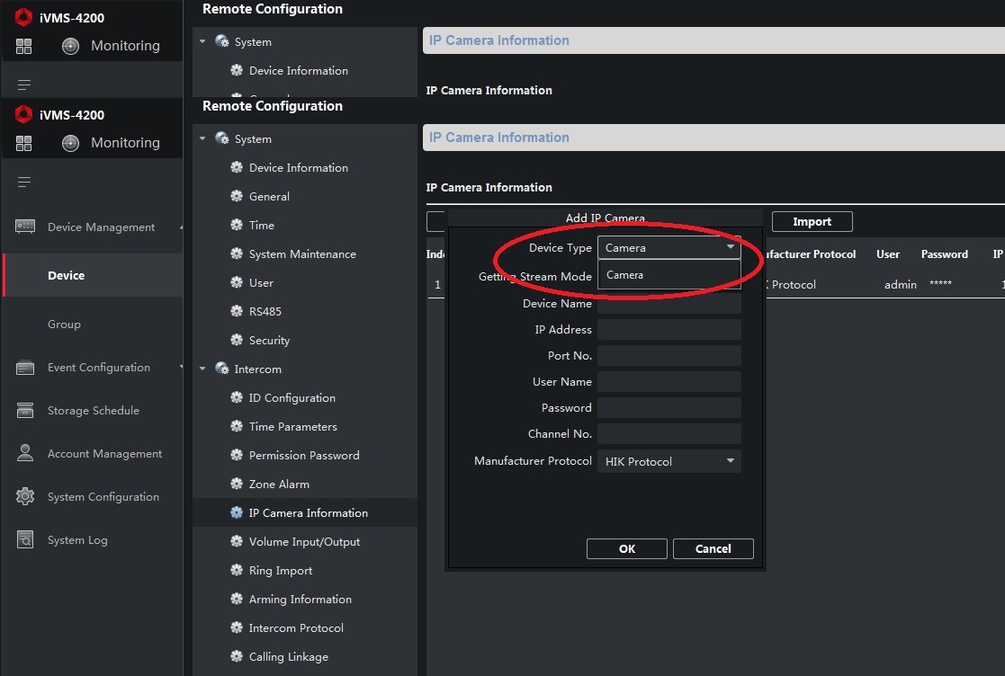

I have a problem with adding external cameras to my intercom. I have three Poe Cameras connected directly to the NVR DS 7608NI-K2.
In Inrercom options there is no option to add nvr, only camera option (screen). I have added one camera by giving ip address of NVR and it works but how to add more? The cameras are connected to NVR so they do not have their own IP. Changing the channel disconnects the connection to the NVR and it does not work.
Does anyone have several external cameras from NVR connected to Intercom? Is it possible to add several cameras? what am I doing wrong?

I don't know about intercoms, have you tried enabling the virtual host on the NVR?
Then try adding the cameras using the NVR IP address and the camera port number.
example NVR IP 192.168.1.123
Camera 1 192.168.1.123:65001
Camera 2 192.168.1.123:65002
Camera 3 192.168.1.123:65003
etcetera....
Thx for your response. I have this option turned on, I tested it again but unfortunately it doesn't work. Only one camera works after port 554. Any ideas?
You need to enter NVR's IP adress trought port 554 and under channel write port of desired camera.
That camera must use H264 encoding and substream must for 640x380 or lower.
