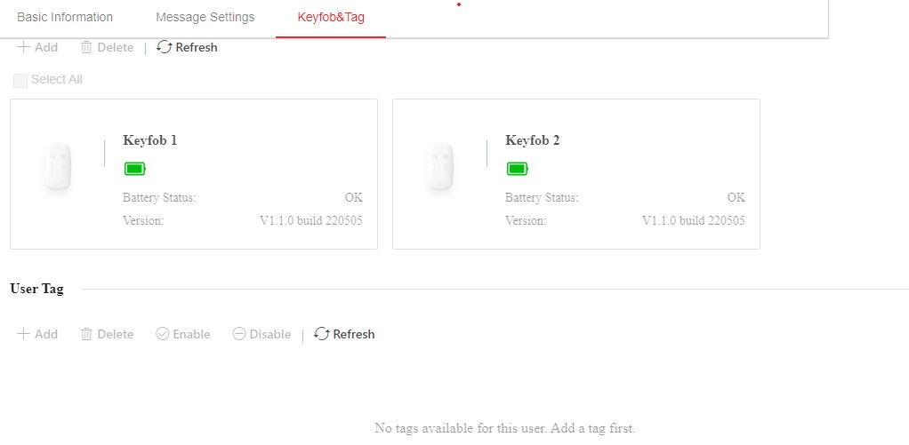

Hi, I have an AX Pro alarm system DS-PWA96-M-WE V1.3.0 build 241224 and I am unable to add the three tags that came with the system, it the hik connect app the add button does nothing and using a web browser the add tag is greyed out (see the attached picture)
I might be adding the tags in the wrong place but I cant find anywhere else to add a tag.
They do beep and say unrecognised tag when I place them on top of the main box.
Does anyone have and ideas how I can add them or what is up with the system?
Its not the end of the world that they don't work but if I can get them working I would have them as a spare device in the even the fobs stop working.
Thanks in advance

I believe that you can only add tags via the app and I think it may be because you've not updated to Android 15.
We've checked our main hub, and the add tag button is also greyed out in a browser.

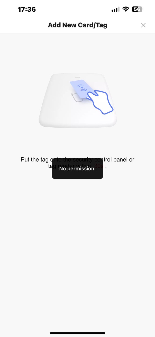

But, on the latest version of Hik-Connect (on iOS), if you go to User Management > [select a user] > Tag > Add Tag, it takes you to the Add New Card/Tag page where it tells to you place the tag on the reader - are you getting to this page?

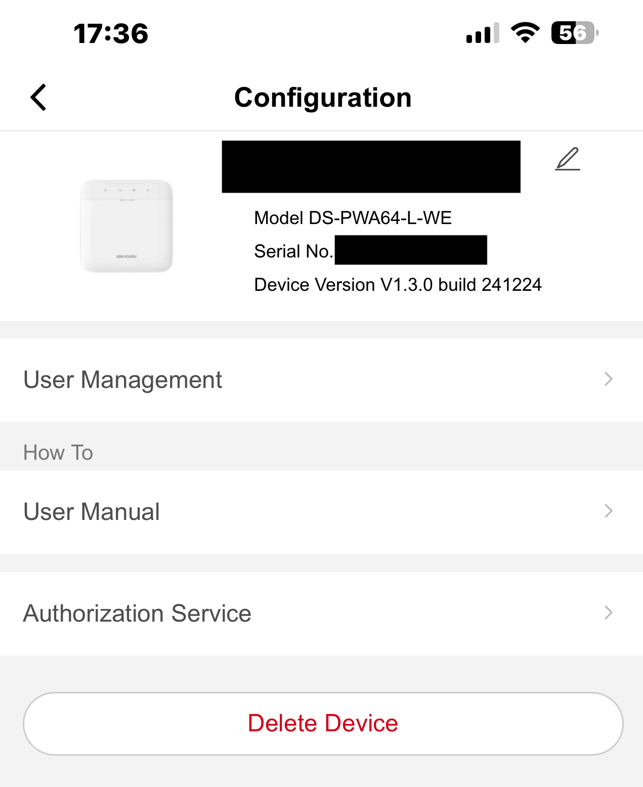

Hi there I joined the forum as I am having the exact same problem. I am an installer and I installed an AX Pro to my office.
So I have done this on iPhone 13 using latest version of Hik Connect (iPhone also latest version of iOS):
Main screen>tap 3 buttons next to alarm name>settings>user management>tap my name>tap tag>add
Then I just get a "no permission" prompt.
I have tried to go into the Hik pro connect app and change permission (as installer) for the end user (my personal account) with no luck.
I am on the verge of contacting Hik support who are usually very good. I have also logged into the panel as the installer on the web browser and cannot see any option.
If I go to a different end user, I can add the tag, it puts the reader into tag discovery mode and works fine, so I know there is no issue with any hardware. I also double checked the pros tag was working as when I present it in ordinary working mode, it shows that an unidentified tag has been presented.
Any help greatly appreciated!

Yes, I'm wondering if V1.3 has broken the built-in readers on the mid-level hubs - our light-level hub is using V1.3 and works normally, but it may be because we're using a separate card/tag reader...

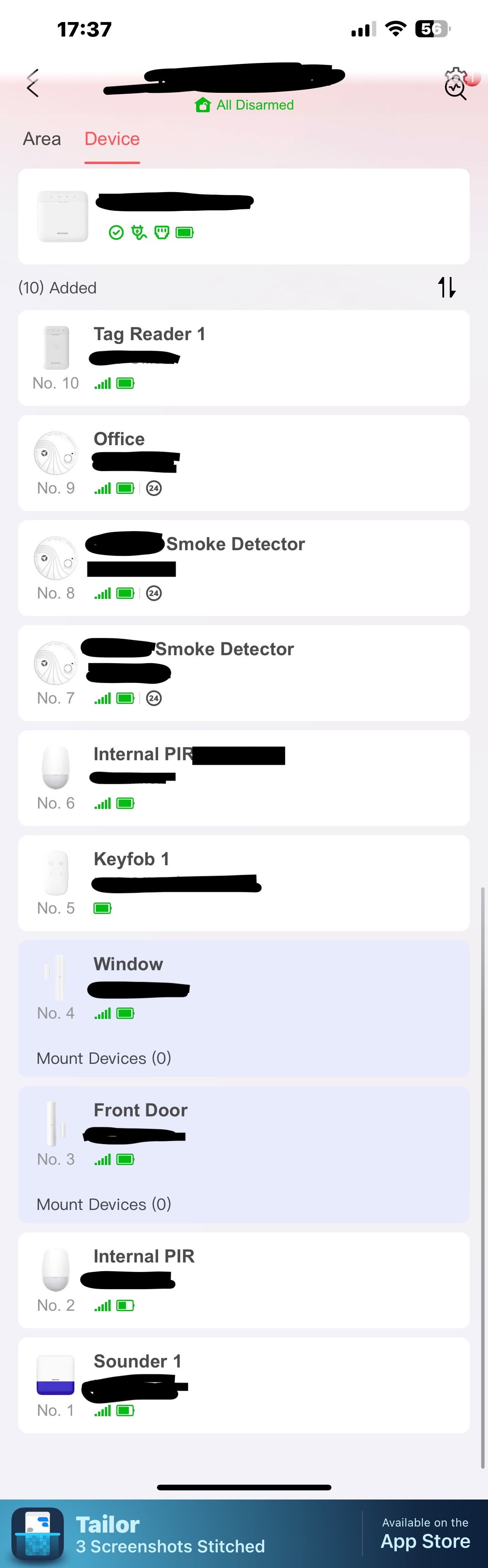

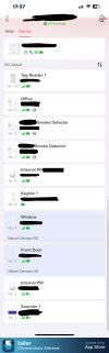

Hi guys sorry for late response... I'll add some screenshots...
Sorry I uploaded the same image twice, the third one is just showing that I have no permission when I in fact do!
I am no further along with the issue, i dont want to downgrade as everything works apart from the tags that I don't really use.
