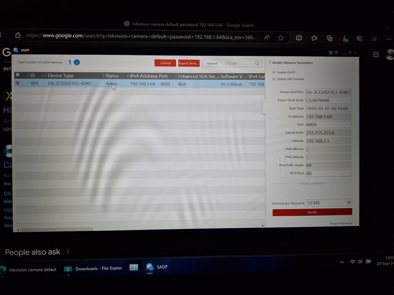

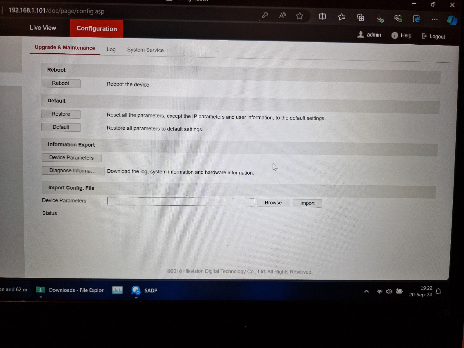

I try to upgrade my IP Camera 2CD2021G1 IDW1 firmware, but there is no option in Maintenance Window to do that.
Any idea why this is happening and how can I perform the upgrade?

Try a different browser. Alternatively add the camera to iVMS-4200 and then access the config from there (that usually gets around all of the browser quirks)
