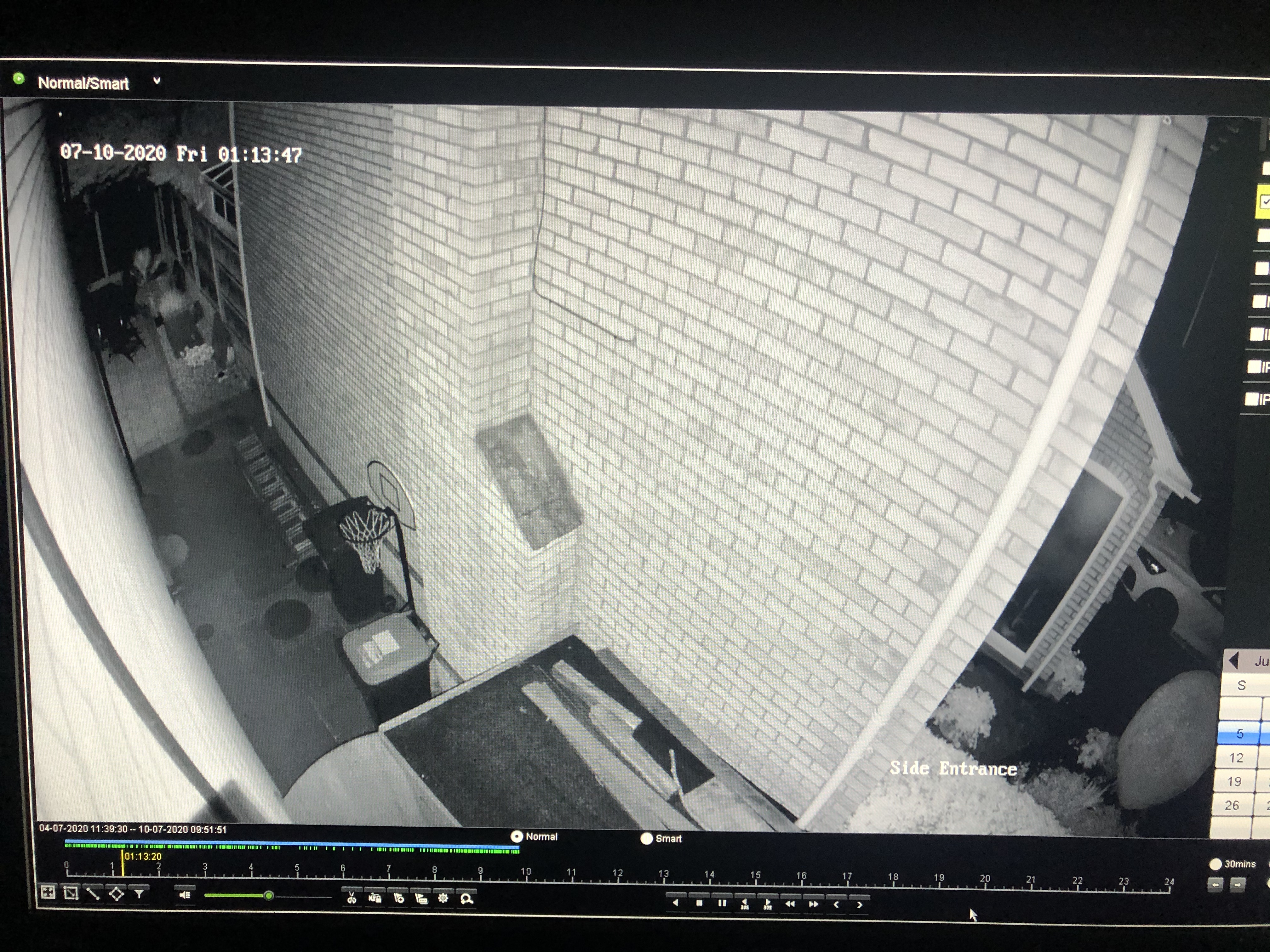

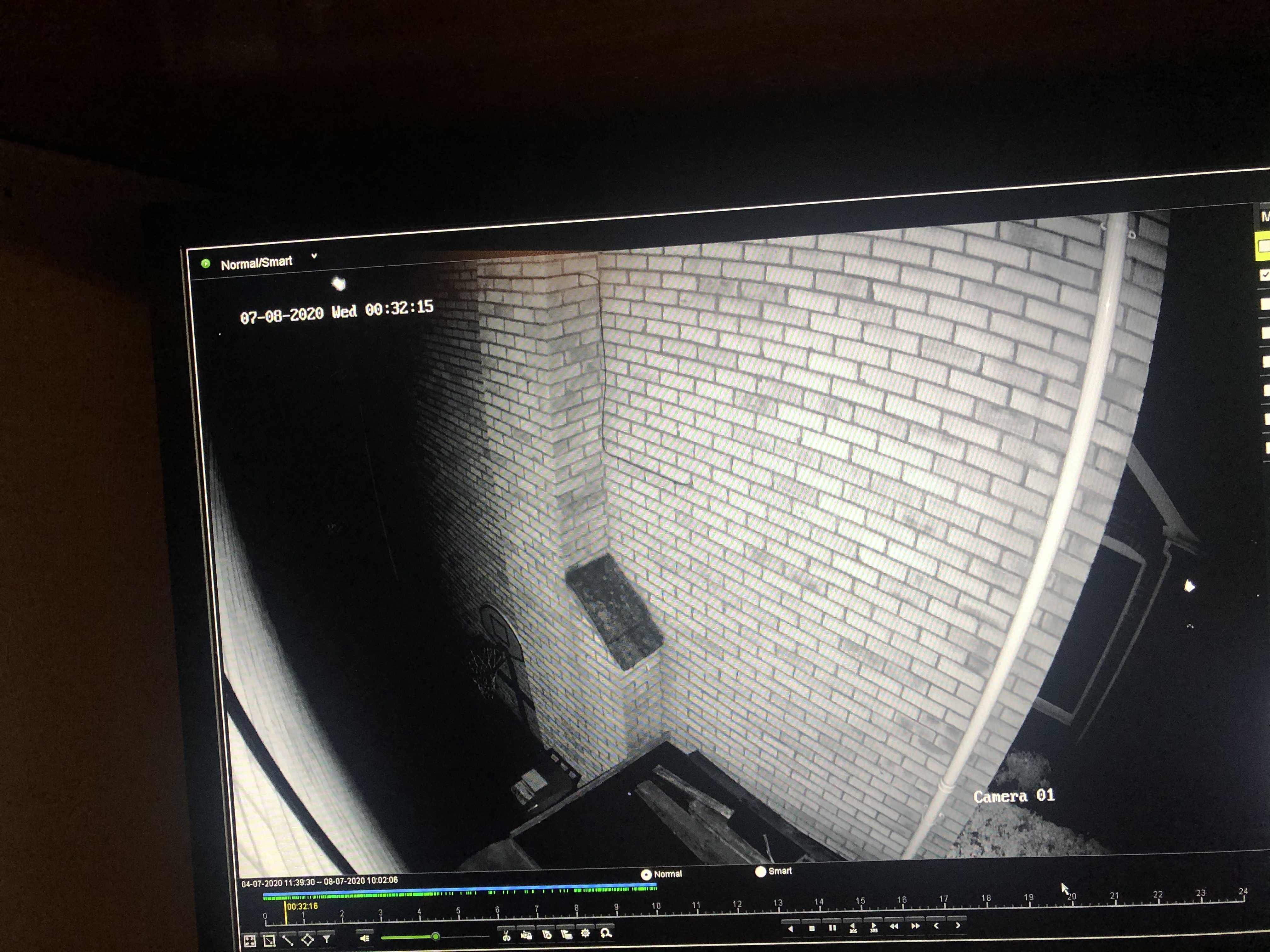

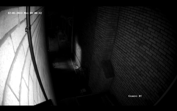

Hi All,
Newbie here so go easy! Just completed my first home CCTV installation, Hikvision DS7608NI-K2/8P and x4 2CD2385G1-I
Cracking bit of kit, minor problem I am having with one camera is down the narrow side of the house the night vision function is poor, I have attached a few photos. Believe the camera was too close to the wall and maybe the light was bouncing back, I moved the camera angle and it was much better but still poor, almost like it hasn’t the depth.
I believe the camera and wiring are fine, could it just be it’s such a dark narrow area? Is light reflecting? Any settings I can mess around with?

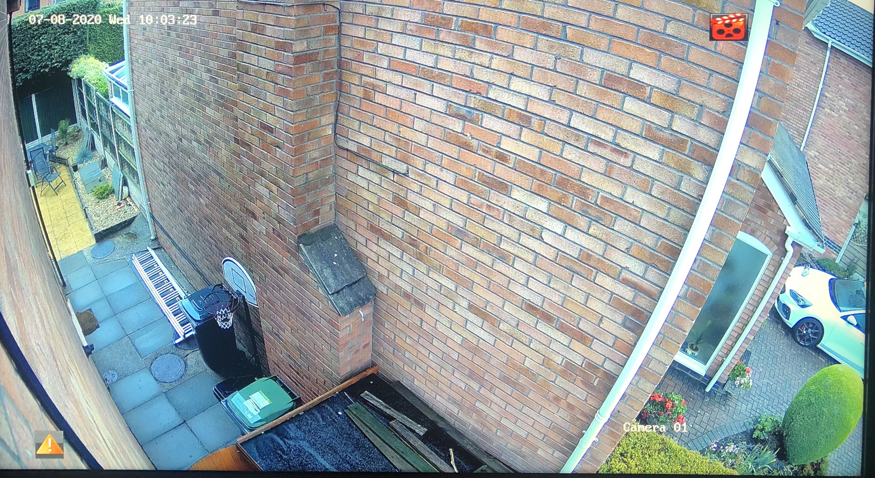

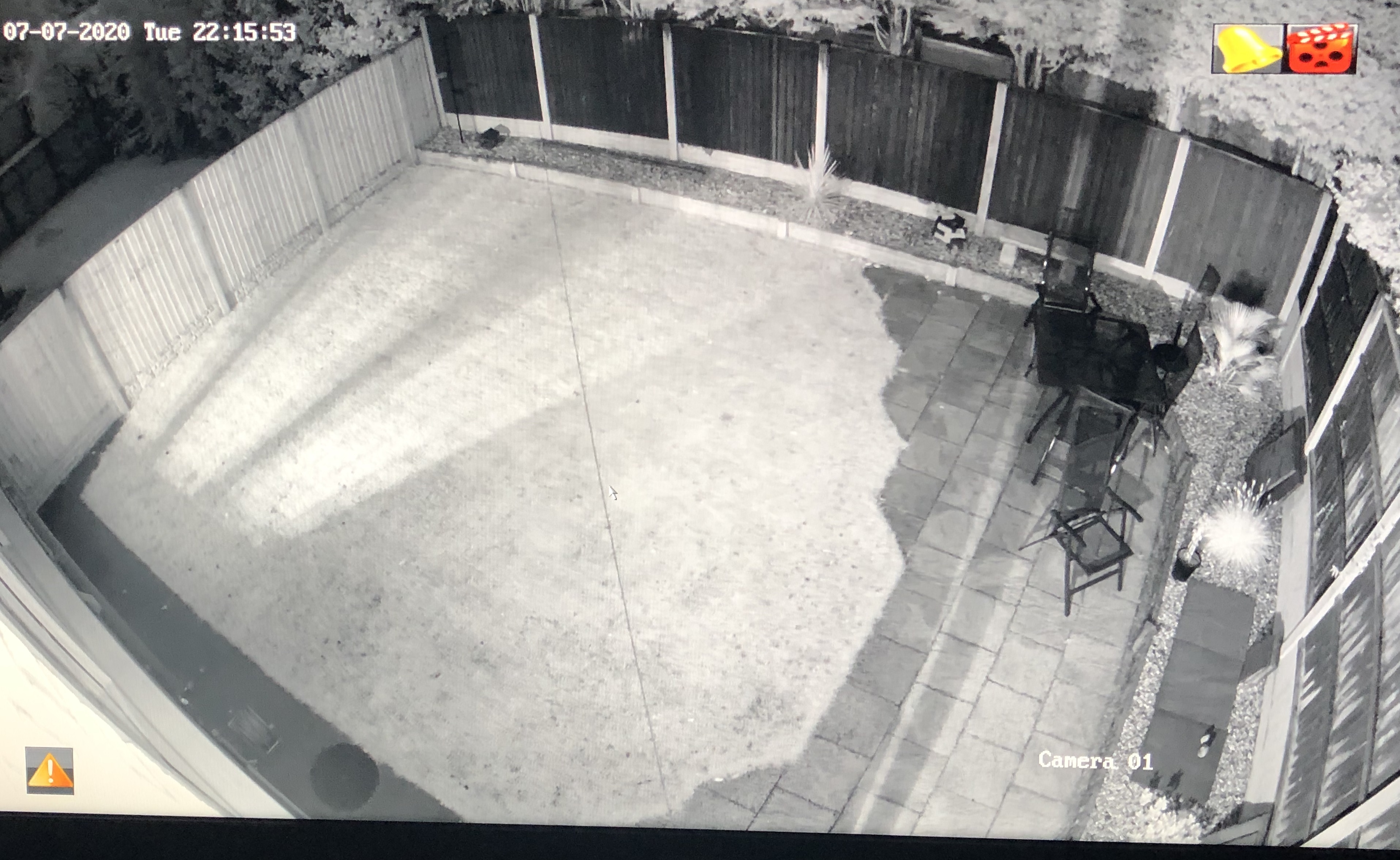

Also attached a day image and one of the front at night to show how I expected them all to be.

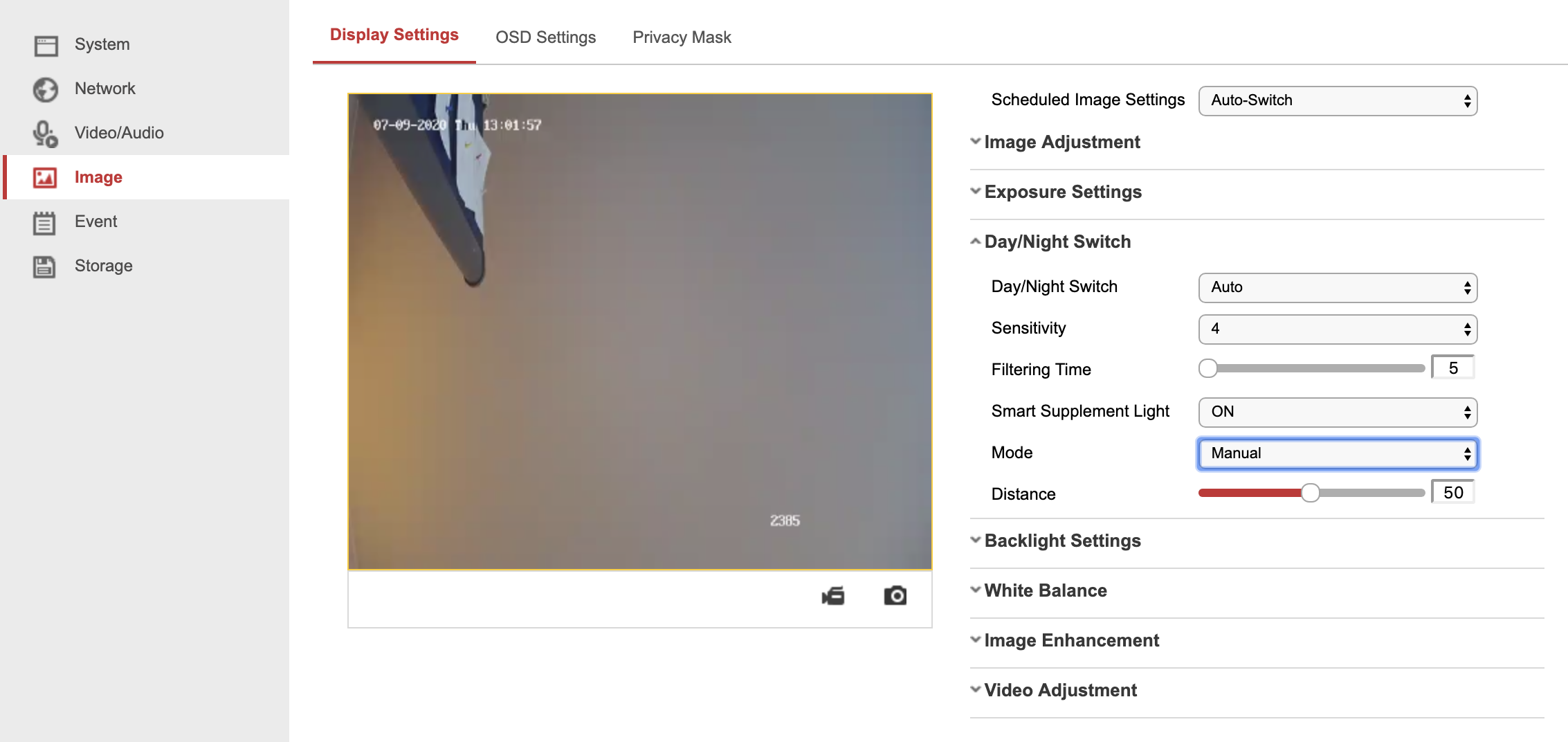

Hi @Woodyz82
You will need to adjust some of the image settings to improve the result you are getting.
The best setting to try would probably be the Smart Supplement Light setting which as you can see from the below screenshot will let you set the cameras IR LEDs to manually or automatically adjust the distance they need to cover. (We would start with auto and if that doesn't get it right on its own then you can try adjusting it manually)
By default the IR LEDs just shoot for the full 30m range they offer and so that would be why you are seeing it overexpose both the wall the camera is mounted to and the wall across the alleyway from the camera.

You will be able to improve the image a lot by adjusting the image settings but I don't think you will get exactly the same kind of results as your other camera position because the locations are so different, one has no obstructions for IR light is very wide & open, the other is narrow, much darker, and has many more surfaces the light can bounce off.
In a tight space like this, we would usually either recommend a 10m IR camera like the DS-2CD2545FWD-I 4MP Mini Domes or a much narrower focal length of around 6m to reduce how much wall is visible.

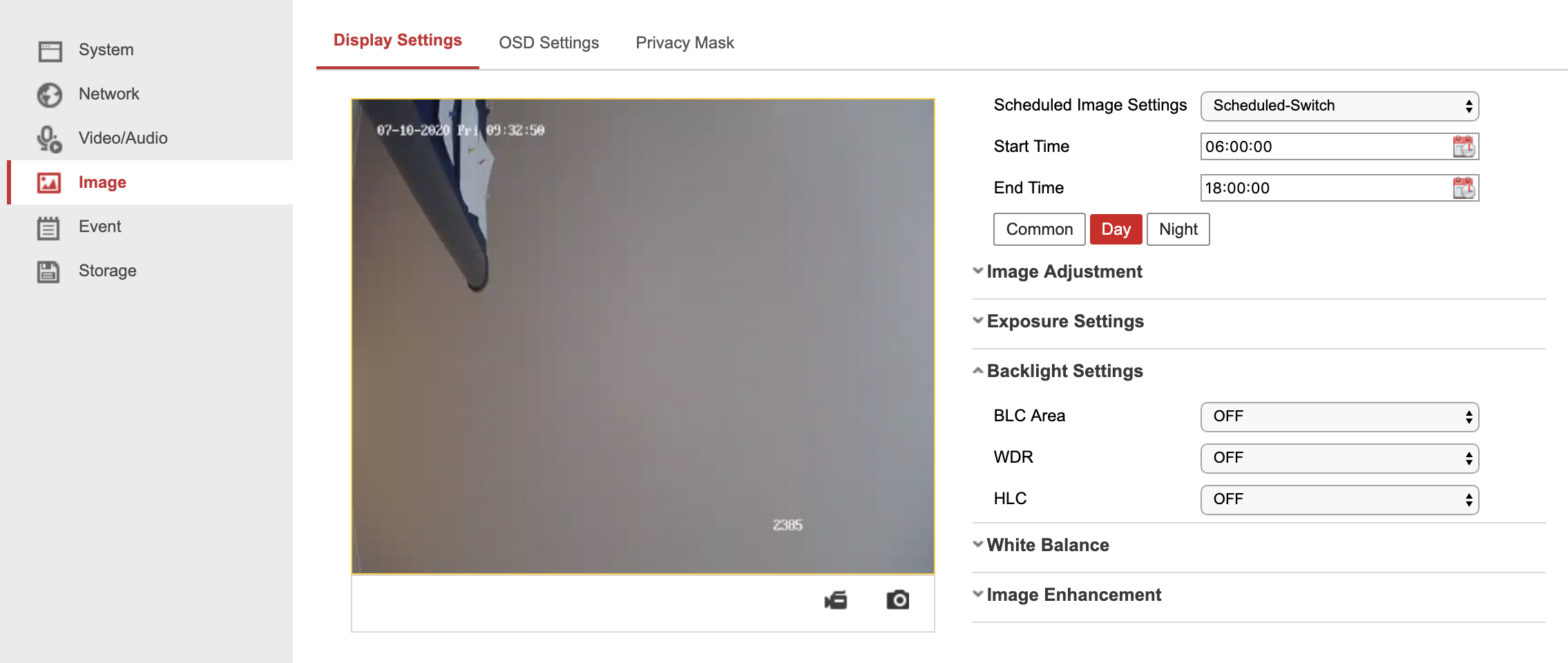

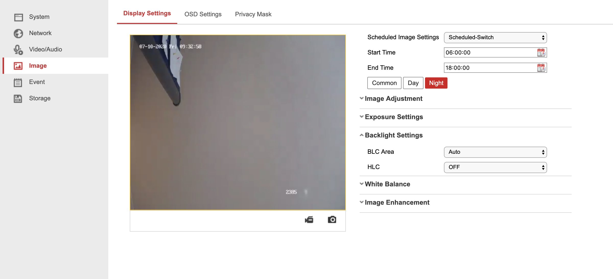

In addition to what @JB1970 has said, you can if you only want the BLC/WDR setting enabled at night set the image settings to Scheduled-switch instead of Auto-switch and this will allow you to set different image settings for day and night.

Here is how I got it last night.
