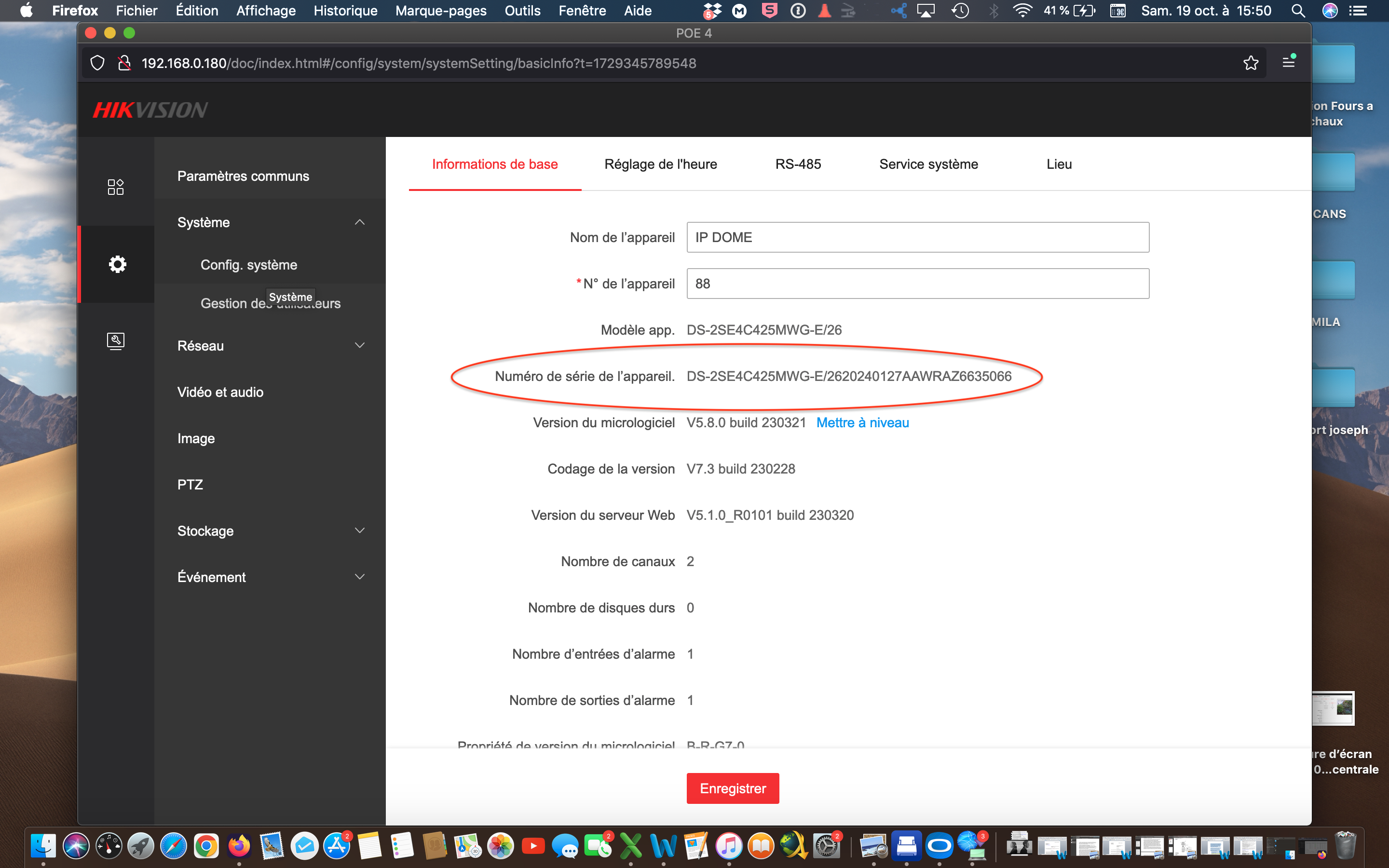

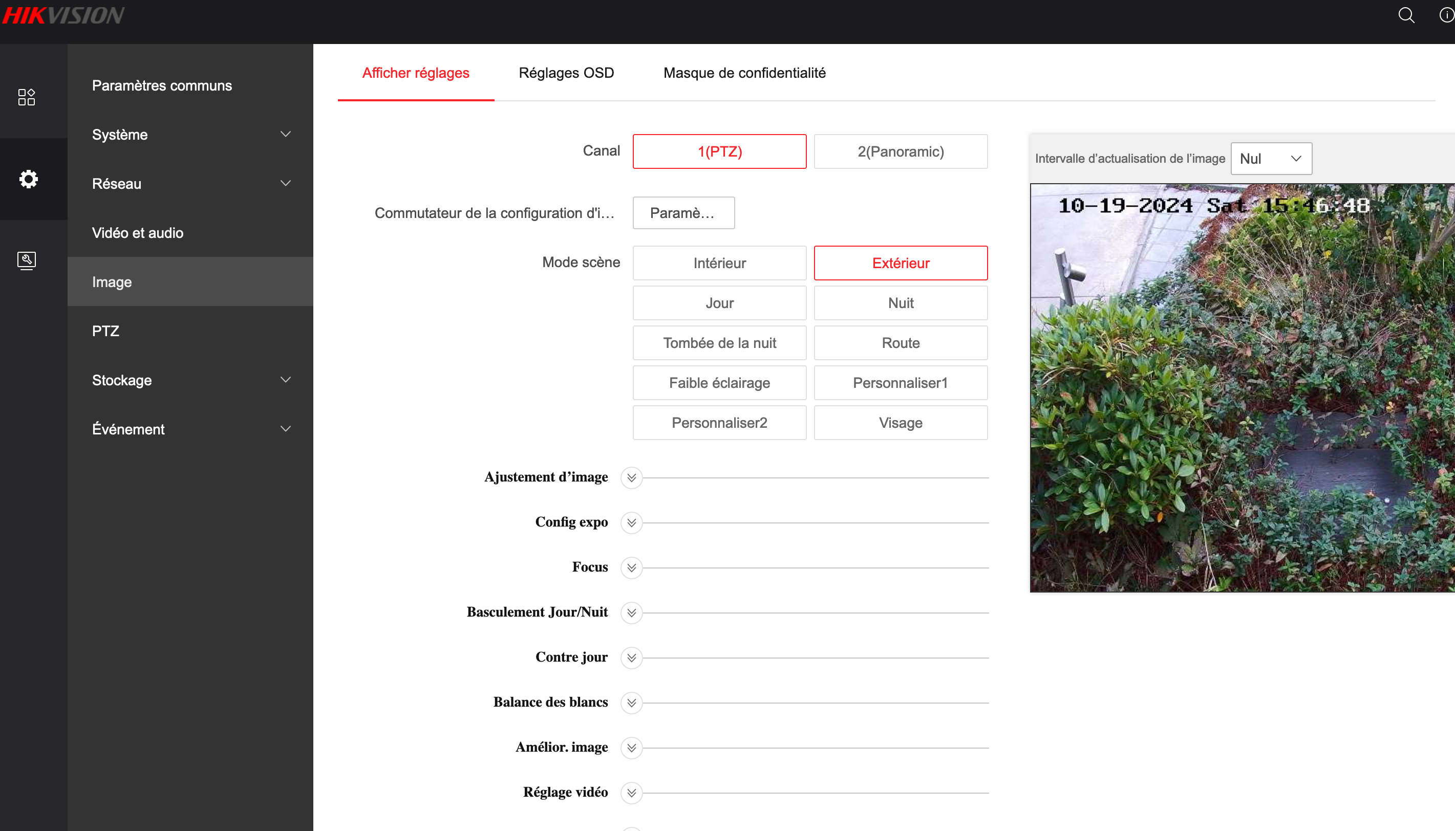

On the other hand, I finished today by installing my last camera, a TandemVu (DS-2SE4C425MWG-E/26(F0)) which combines a fixed panoramic camera with a PTZ camera. The camera, like the others, was immediately recognized by the NVR, the POE perfectly connected, strong signal but already I notice on the screen interface (I use the NVR with a remote screen) that the camera is recognized, gives an image by the PTZ camera, but does not offer me any possibility to switch to the other panoramic image or to remote control or configure the PTZ camera motorized.

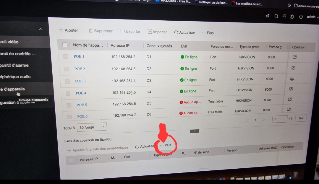

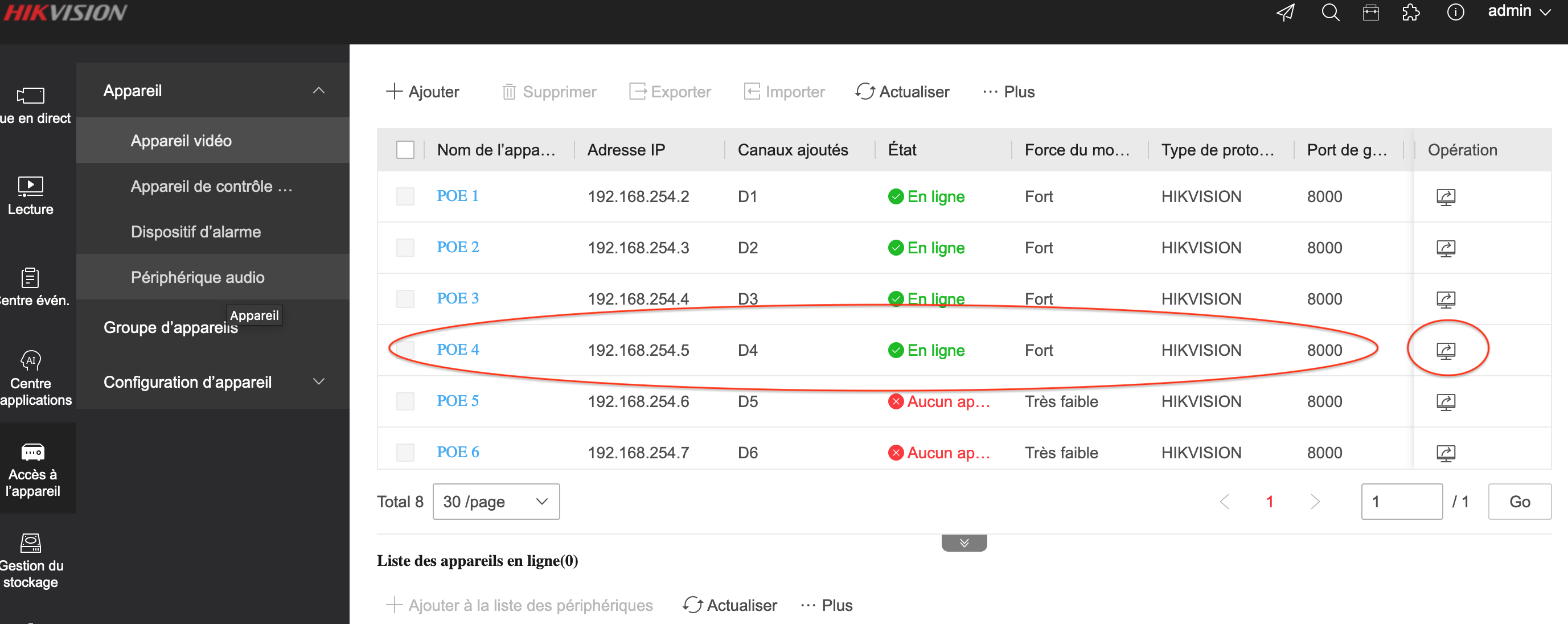

So I make an important parenthesis, at this stage, you should know that both via SADP Tool and IVMS-4200, only my NVR is recognized and not the cameras! I tried to connect my Mac via ethernet cable directly to a free POE port of the NVR, as I had seen on some tutorials but that does not change anything, the cameras are not recognized. The IP address of my NVR is 192.168.0.180 and it seems that the cameras are subdirectories managed by my NVR and not by my network modem. They have addresses assigned under 192.168.254.2/3/4 and 5
Probably the reason why when I type these IP addresses in my search bar, my network does not recognize them.

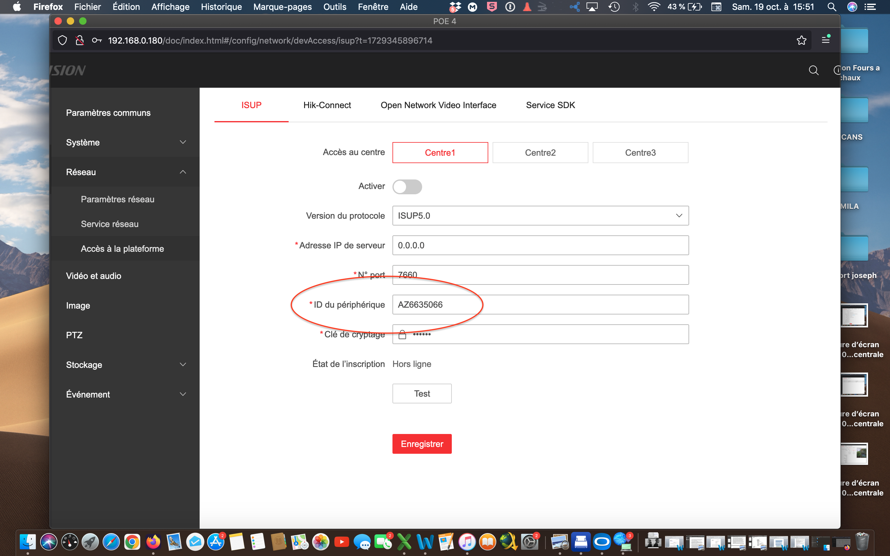

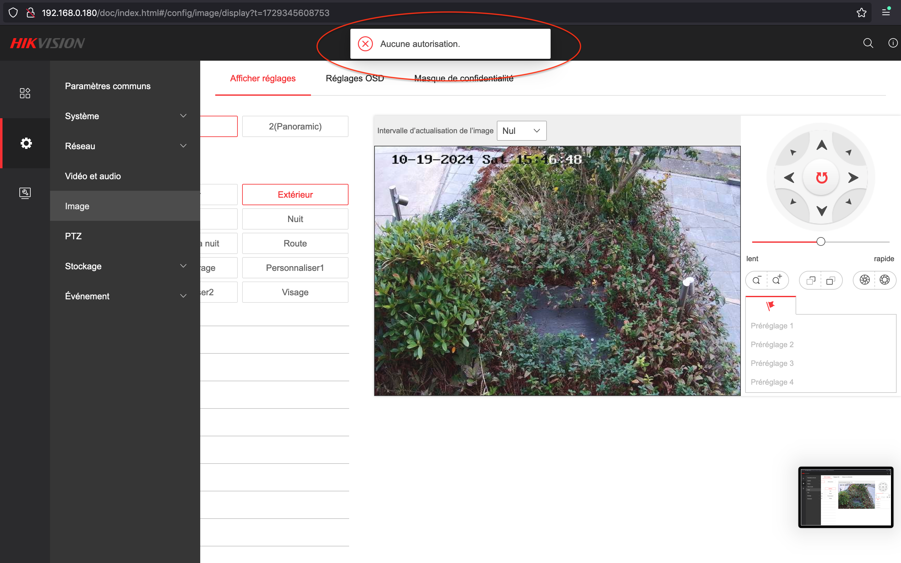

On the other hand, when I go through the network interface of my NVR, I open "access to the device/device/Video device" and I check the small "access" icon on the far right of the connected devices table (in fact it's what they call the "DEVICE REMOTE CONFIGURATION), it diverts me to the online interface of my PTZ camera and there, I can see ALL the configuration options, the switch between the two PTZ/panoramic channels/options, the PTZ remote control, etc.,....except that I can't use them because when I try, it tells me "no authorization"
it's enough to tear my hair out...well if I still had some :joy:....

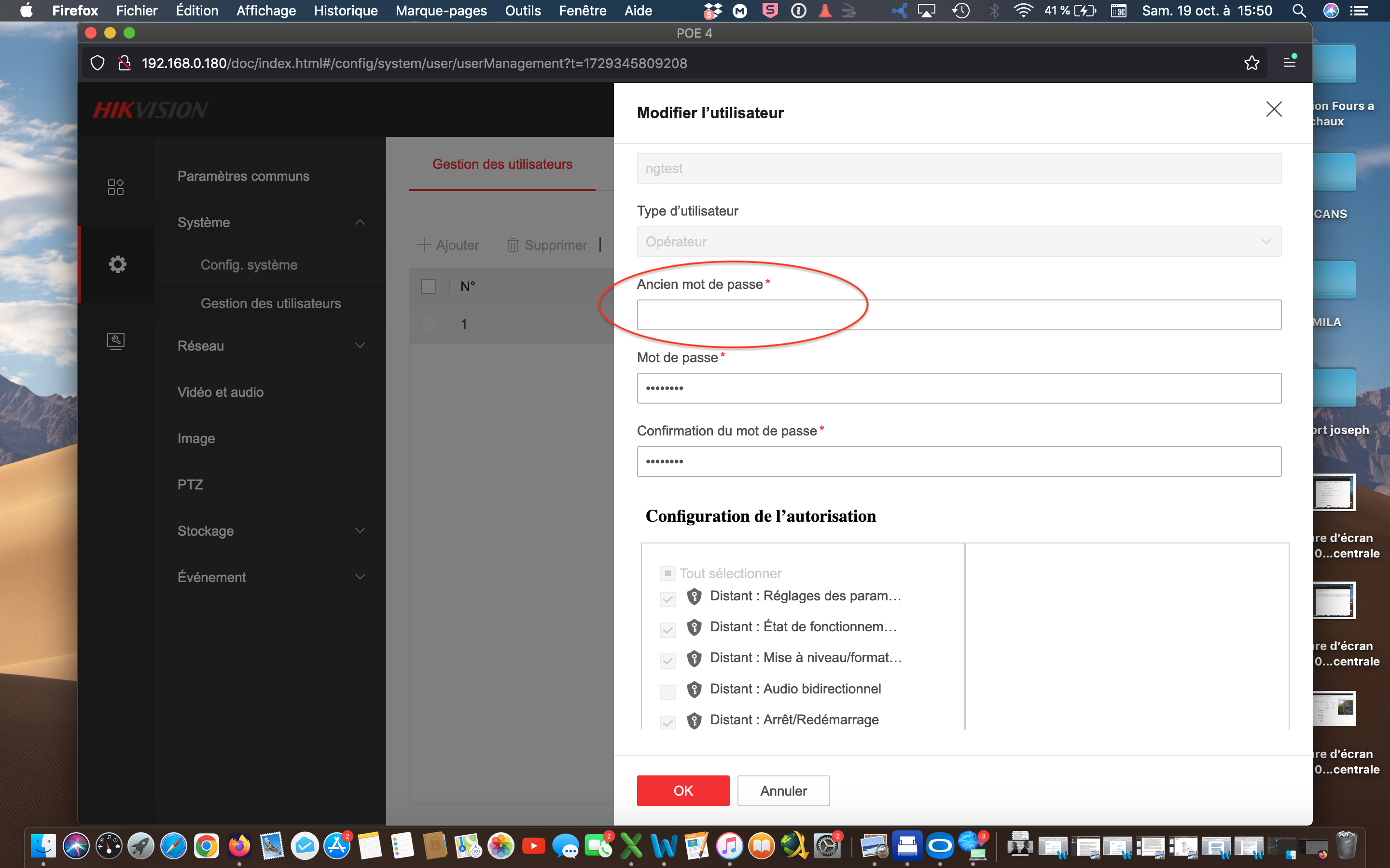

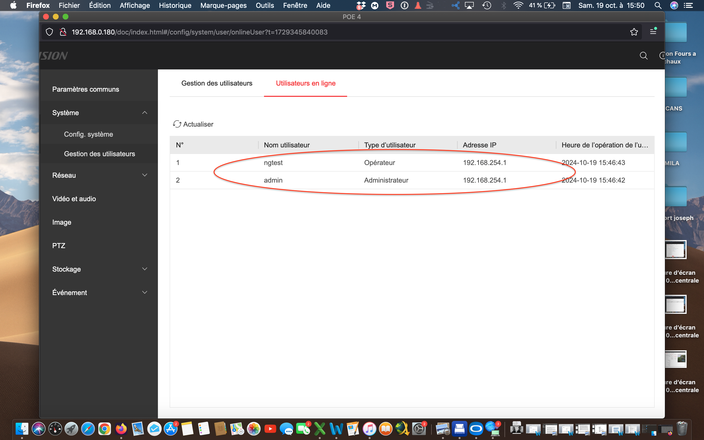

Anyway, I investigate further and I observe by going to "system/user management" that "ngtest" appears as the user name, instead of "admin" which is my login ID...well, when I go to "online users" it tells me "ngtest" in the first line and "admin" in the second, both with the address 192.168.254.1
so the problem is that to be able to unblock user access is that I think I need a password linked to the "ngtest" account that I never created, by the way, and so I am blocked.

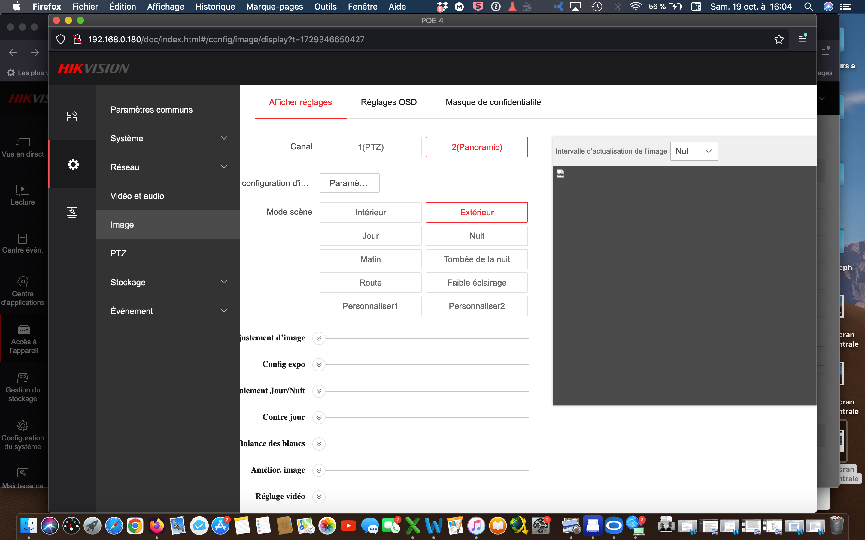

ah yes, it should also be noted that I can switch to the panoramic camera image but the screen is black, no image...

- I don't know why the panoramic camera gives a black screen;
-I don't understand where this "ngtest" account comes from... is it possible that it is an account created during a factory test of the equipment? Or is it a reconditioned product that was sold to me as new? Or is it linked to my method of connection to the camera interface (via remote configuration)?
