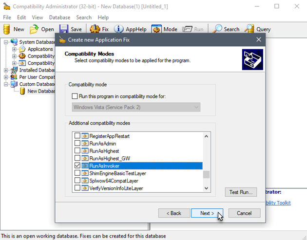

Same here with UAC prompts for iVMS. I've found that a RunAsInvoker shim works for us.
  1. Download and install the Application Compatibility Toolkit, which is part of the Windows ADK (scroll down on page for installer download links).
  2. Open Compatibility Administrator (32-bit) from Start menu > Windows Kits, or from a Command/PowerShell prompt on 64-bit Windows: 'C:\Program Files (x86)\Windows Kits\10\Assessment and Deployment Kit\Application Compatibility Toolkit\Compatibility Administrator (32-bit)\Compatadmin.exe'

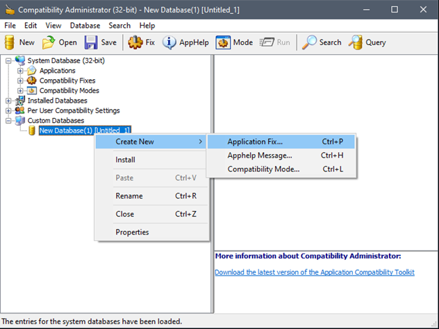

  3. Right-click New Database(1) [Untitled_1] and select Create New > Application Fix...

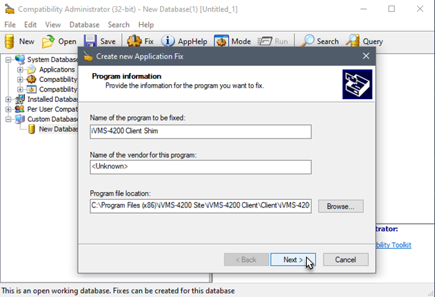

  4. Enter a name, something like iVMS-4200 Client Shim, then click Browse and select the C:\Program Files (x86)\iVMS-4200 Site\iVMS-4200 Client\Client\iVMS-4200.Framework.C.exe program and click Next.

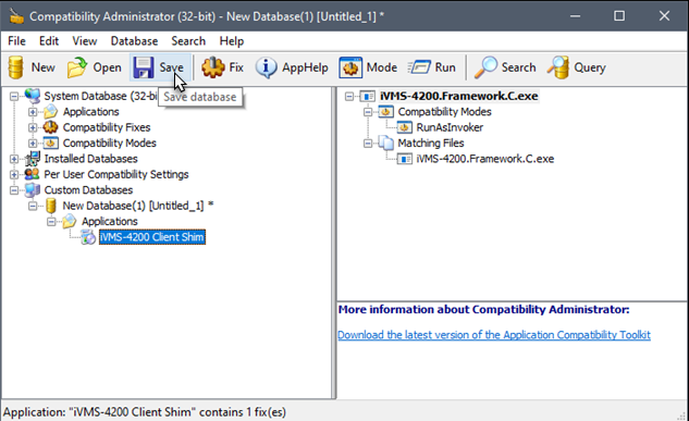

  5. Scroll down and select/check RunAsInvoker then click Next.
  6. Click Next.

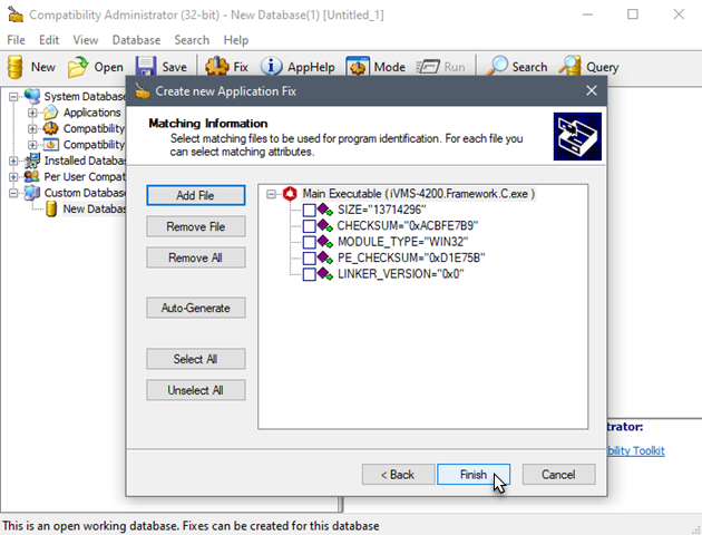

  7. Uncheck any items under Main Executable and click Finish.
  8. Click Save.

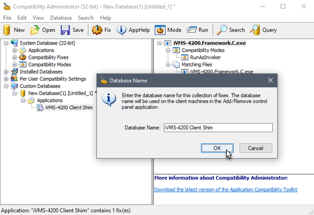

  9. Enter a Database Name and click OK. I reused the program name I used in step 4: iVMS-4200 Client Shim.

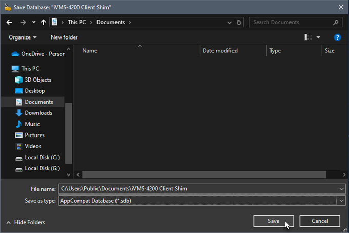

  10. Enter/select a location and file name for the AppCompat Database. and click Save. I saved mine to the Public Documents folder (C:\Users\Public\Documents) and reused the name I used previously: iVMS-4200 Client Shim.
  11. Install the application shim from an Administrator command prompt or PowerShell. Make sure you specify the path and file name you used in the steps above.
    sdbinst.exe /q 'C:\Users\Public\Documents\iVMS-4200 Client Shim.sdb'
    or
    C:\Windows\System32\sdbinst.exe /q 'C:\Users\Public\Documents\iVMS-4200 Client Shim.sdb'
    If you use PowerShell, you may need to append an ampersand in front of the command. For example:
    & C:\Windows\System32\sdbinst.exe /q 'C:\Users\Public\Documents\iVMS-4200 Client Shim.sdb'
Profit! :-) iVMS should now open as a standard/normal user, without a UAC prompt for elevated privileges.
If you install/use iVMS on more than one computer, you can copy and install the AppCompat Database (.sdb) file you created, on other computers. You can use the Add/Remove Programs utility to remove the shim, if you ever wish to do so.
