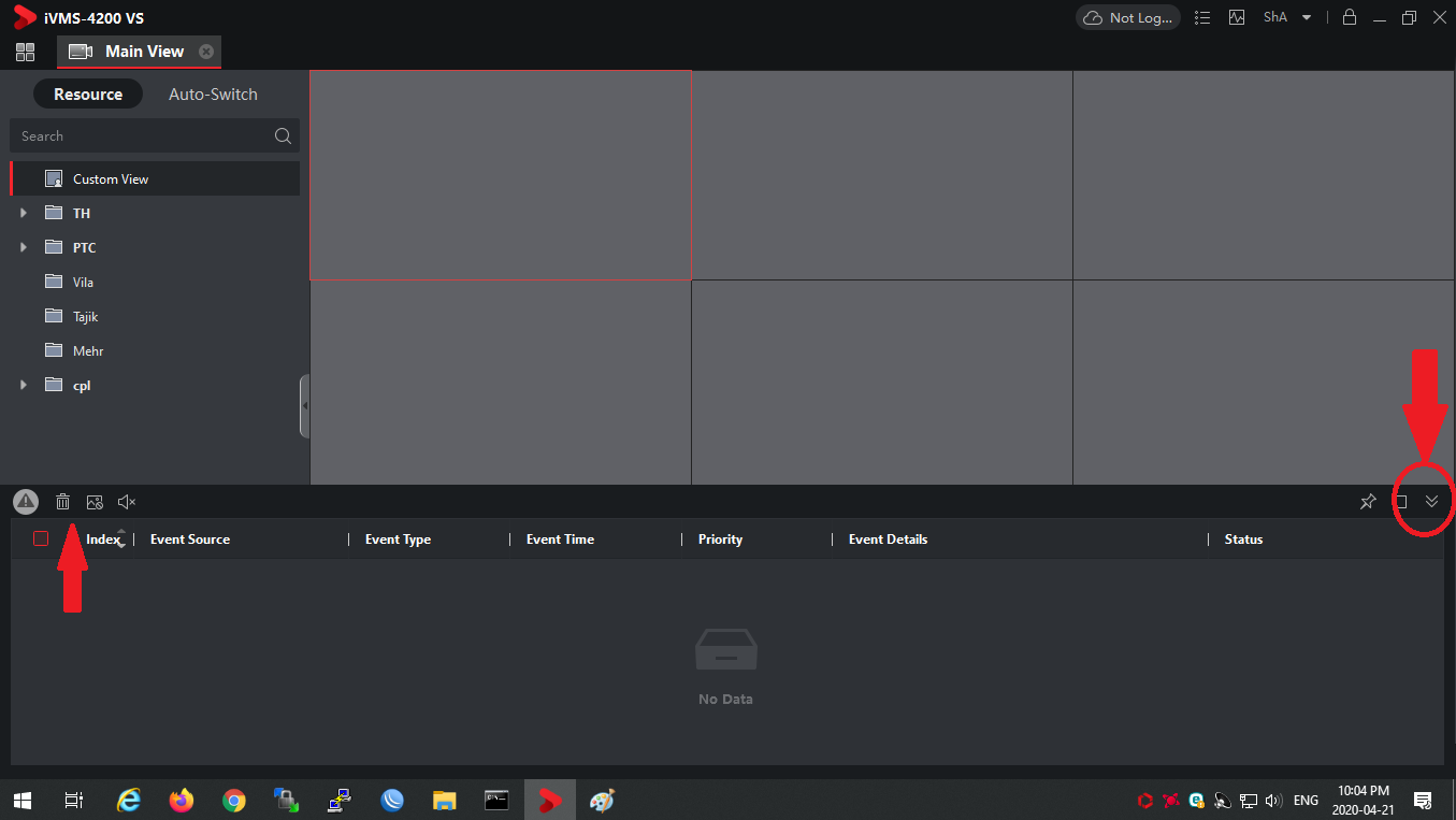

there is tab on the bottom of your ivms you can pulled it up by clicking on arrow by doing this it shows your event in main view you could choose the specific event and right click then clear or you could do this by pressing recycle button both work same way and red bell goes clear.

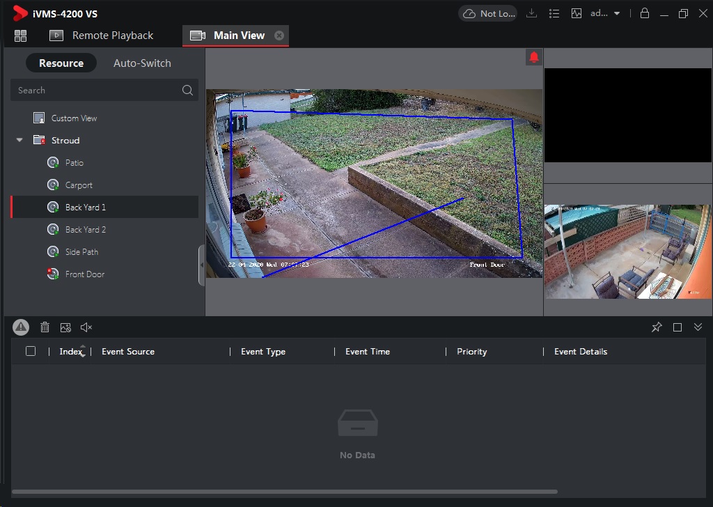

I have tried this (screen capture attached), but even with all of the events cleared... the red bell icon remains.
It is quite puzzling.

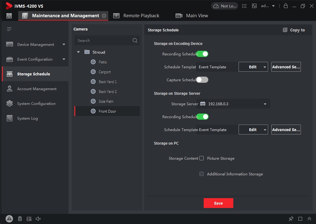

I have configured the camera to record on both the internal SD Card and also on the iVMS-4200 VS software (see attached). This is how I was able to determine that there was an issue with Basic Events on the newer DS-2CD2365G1-I camera. Originally I set it up the same as my older cameras but discovered right away that something wasn't working correctly. My vendor suggested I try different codecs and eventually suggested I upgrade the iVMS-4200 from V2.8.1.4 to the newer V3.2.0.10. I advised my vendor that the new version of iVMS-4200 didn't fix the recording delay with Basic Events on the new camera and how I found that Smart Events worked fine. I guess this was taken by them that my problem was "fixed" and I haven't heard from them since. I have found a nice combination of Line Crossing and Intrusion Detection that seems to work very well.

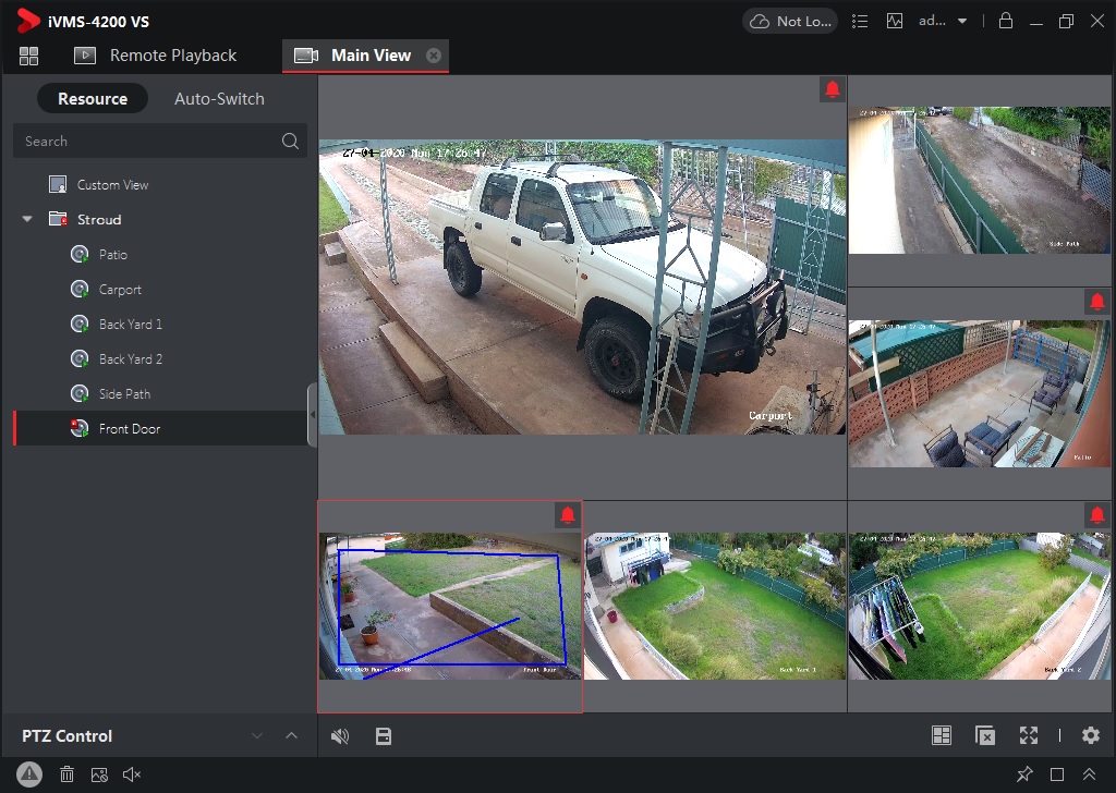

Strangely, when I shuffle the cameras around on the Main View, I get persistent red bell icons on my other cameras that cannot be cleared. The alarm indication in the list of cameras does go away after the event has finished (apart from the troublesome DS-2CD2365G1-I camera).
It's seems to be when I move a DS-2CD2342WD-I camera live view into the location where the new camera once was, this happens. More weird behaviour :-)
Restarting iVMS-4200 VS will clear them, but the newer camera (DS-2CD2365G1-I) still has a "sticky" Smart Event notification icon regardless.

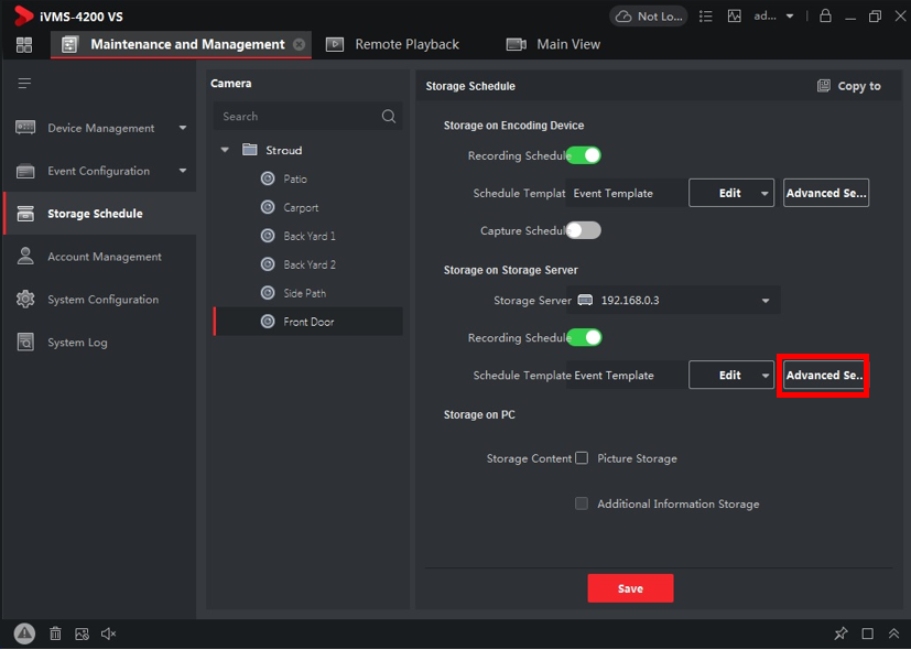

I am checking the second issue with R&D. And please also advise the customer to select longer pre-record time (like 10 seconds) in the Advanced Settings of Storage and see if it helps. (shown below):
