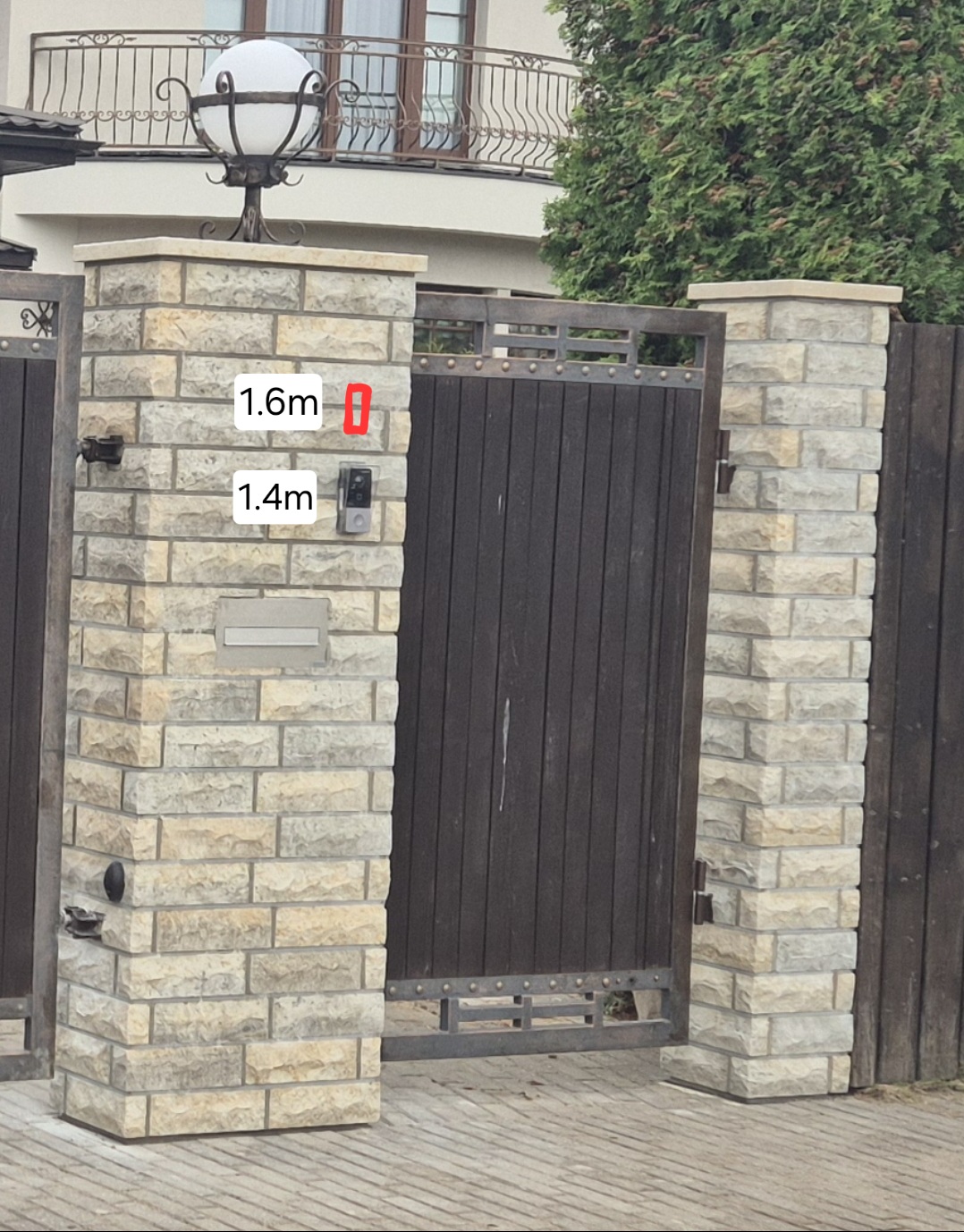

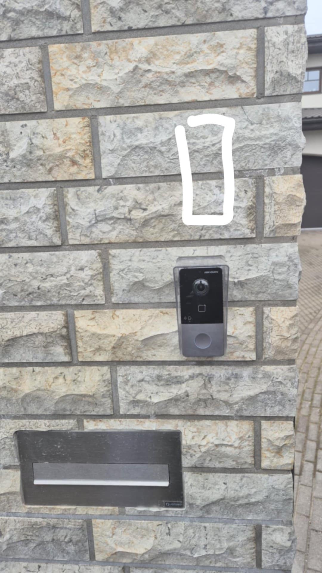

It seems the KV6113 was installed a bit low, with the camera at 1.4 meters from the ground. I'm considering relocating it to 1.6 meters. Do you think that height might be too high? What is the typical installation height for these doorbells? Unfortunately, moving it will require cutting out and replacing some bricks.
It should be fine at its current height and raising it would be a waste of time. Just go in the menu and make sure resolution is set to 1080P. There is a crop function in the menu that allows you to ‘zoom’. If that is enabled you get a much reduced viewing angle so make sure it is also set to 1080P.
You did answer yourself with installation manual.
Do you see person calling with the current setup?
If yes, i wouldn't change anything.
