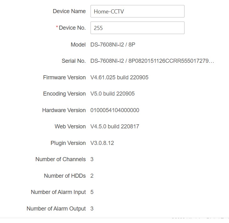

Hi Dan taken directly from my NVR
i have always since the day i had it installed the K51 firmware version do i need the K41?
Thanks @p5taylor
So it is a DS-7608NI-I2/8P and not a E2/8P, we will edit your post to correct this.
Do you know when you bought the NVR? (roughly what year/month was it)
