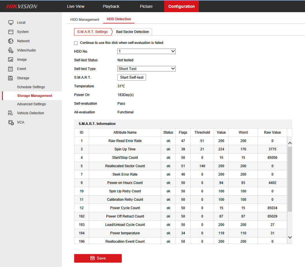

  4. Are you using a good HDD (security type e.g. WD Purple / Seagate Iron Wolf) - does your HDD pass its tests OK? Or show anything other than status OK? (below)
