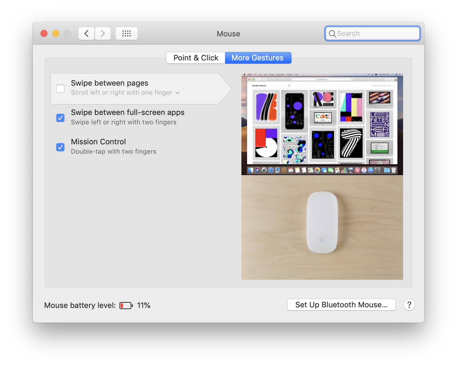

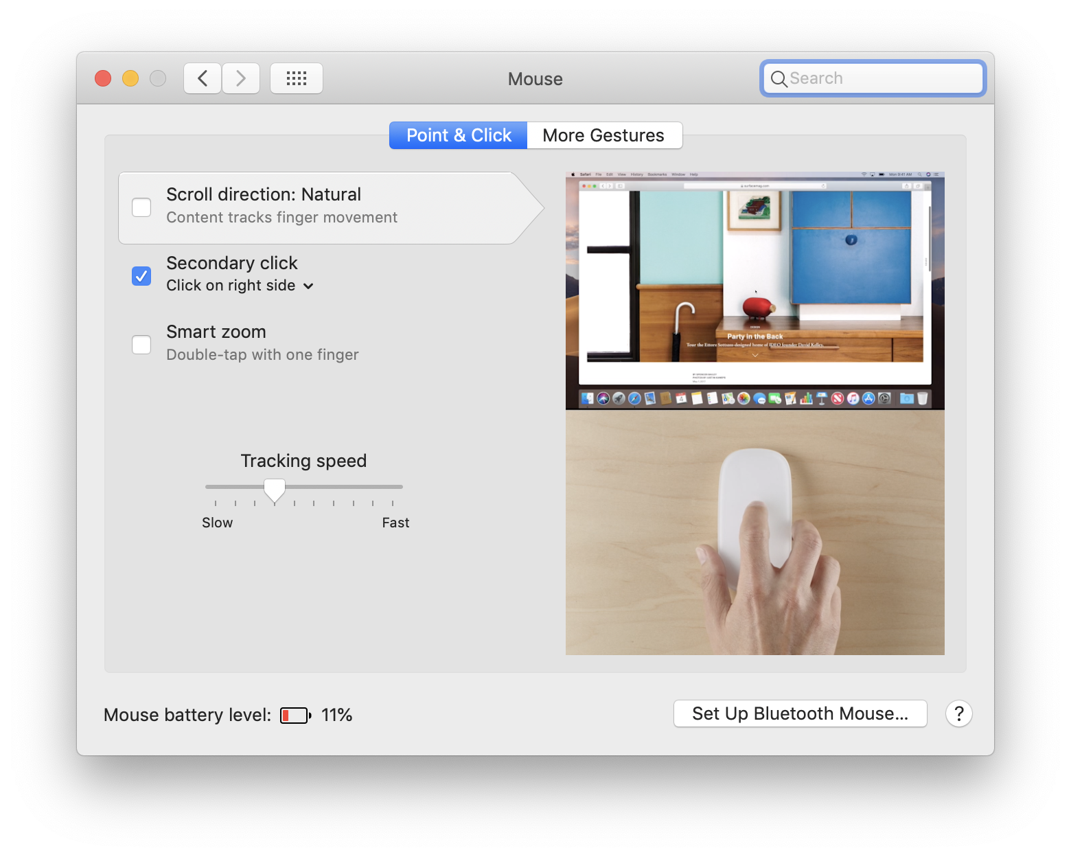

I've attached my current mouse settings for you to see how they compare as the magic mouse does support some unique features which if you have them enabled may be what is causing the issue.

Thanks @Dan. I have nothing enabled on page 2 but I do use the Smart Zoom function on page 1 as I often need to zoom in on my 27in 5k iMac. Disabling Smart Zoom didn't improve the tab behaviour but did make the eMap less prone to downsizing unilaterally.
I do have my tracking speed maxed out, otherwise it takes all day to get from east to west.
