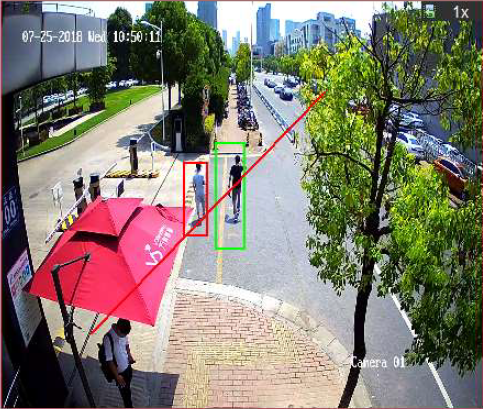

In your Hik-Connect app - Me > Settings > Display VCA Rule. The overlays will allow you to see what's happening while you wander around in your detection area.
Green target in rectangle is detection and tracking.
Red line or region(area) and red target rectangle is an alarm as set in your Configuration.
(sensitivity high up ;
If there is no detection at all, unfortunately there is no real Sensitivity adjustment for detection and tracking(possibly hidden in an advanced menu, but not for us) on Smart Events.
The so called Sensitivity, is about percentage of target entering your region or crossing the line so that to give an alarm. 90 means that 10% of target size has crossed the line or entered the region.
