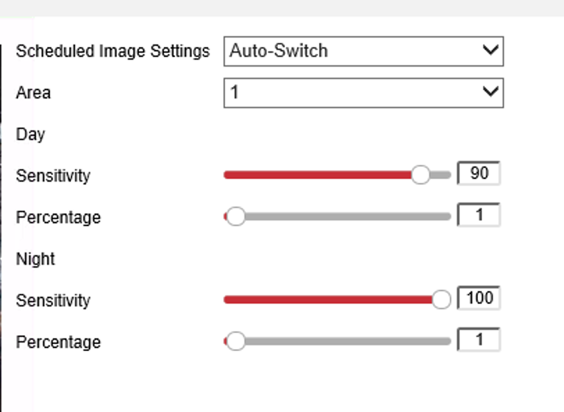

During live view:-
In the live view screen I see lots of small green squares flashing around, these are visible regardless of the sensitivity and percentage settings I have set. They used to adjust with the settings giving a good indication of what would trigger a recording without having to watch recordings back.

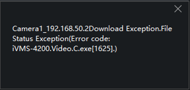

Can you download the footage in iVMS-4200?
Or, right-click on the shortcut IE and select "run as administrator", which should let you download it.
When downloaded, drag and drop the file into VSPlayer.

Hi,
Attached is a screenshot of the squares and my settings for the biggest zone. I will try the ivms download and let you know how it goes.

I cannot download via IVMS either.

I have managed to get a file via IE now. It still only shows the green rectangle and not the smaller squares. It also appears to be missing loads of motion even though my current settings are quite aggressive.
