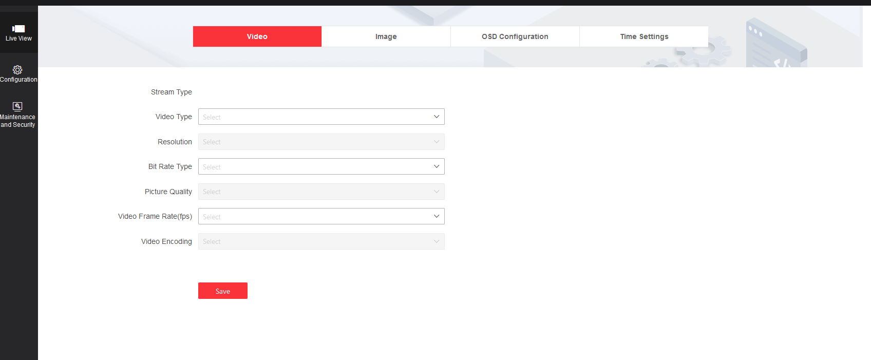

So I updated my camera firmware, but the UI is now acting really odd. I can login fine but the UI isn't working after that most things can't be clicked and it doesn't show the feed. Screenshot below.
The good news is that the stream still is behaving as normal so my NVR/Recordings aren't affected.
Does anyone have any suggestions on where to go from here ?
Thanks.
Camera is a DS-2CD2387G2-LU-2.8MM-BK and the firmware version was Firmware__V5.7.18_240826_S3000597013

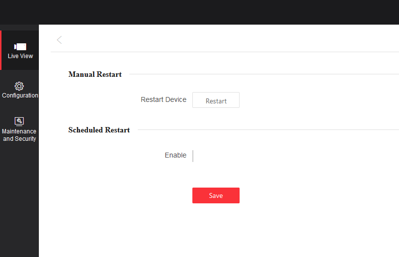

Hi Kyle, I think we might have different issues looking at the all I can see on the Maintenance and Security page.
Yep, it looks like lots of settings aren't loading properly - which browser are you using? Is that up to date? On Windows or macOS?
Using HiTools Delivery like @alfaclvi mentions should allow you to reset the camera to factory defaults and then try again in a browser (once the plugins are reinstalled).
