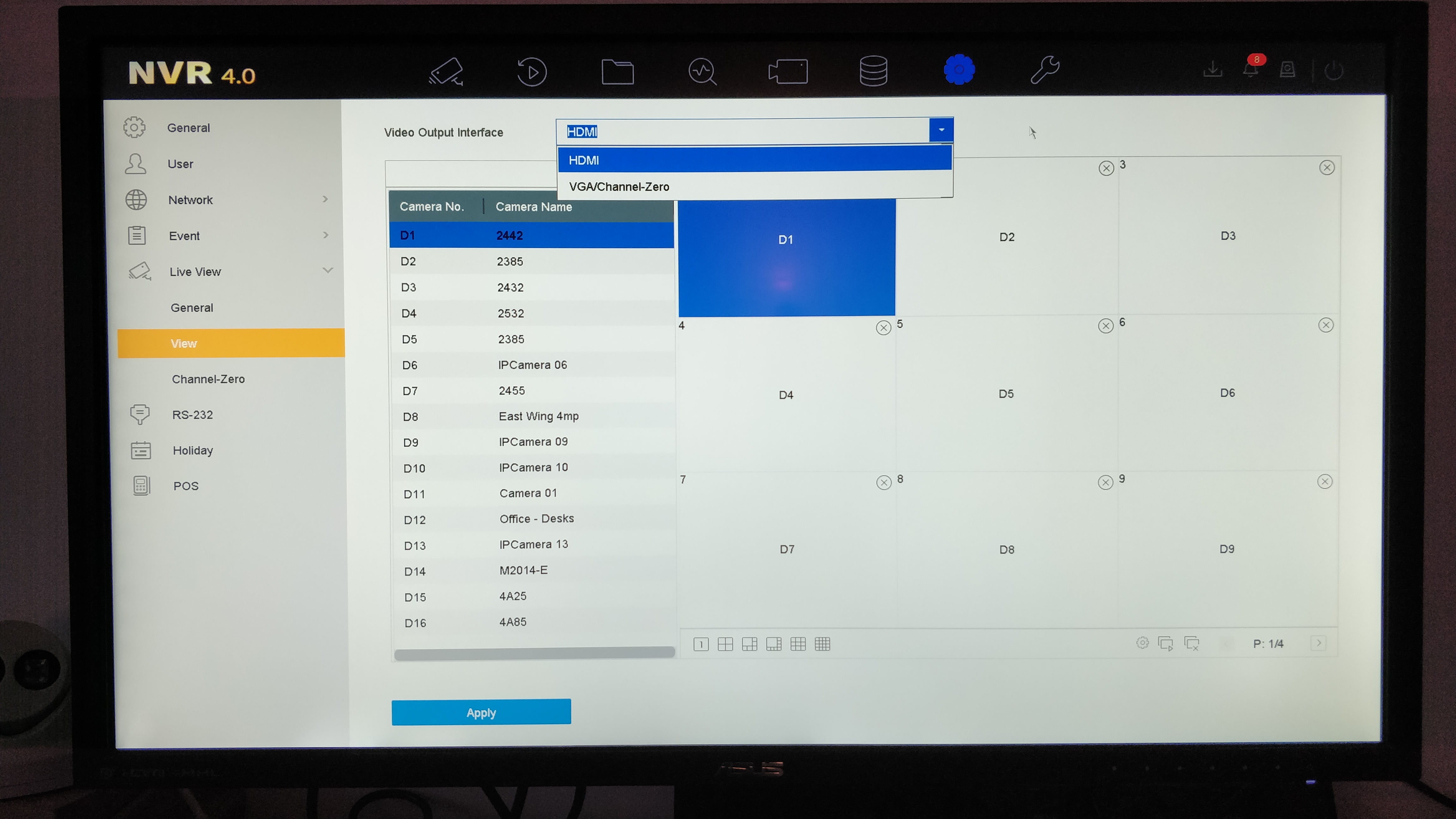

I-series (DS-7608NI-I2-8P / DS-7616NI-I2-16P / DS-7716NI-I4-16P /DS-7632NI-I4-16P / DS-7732NI-I4-16P)

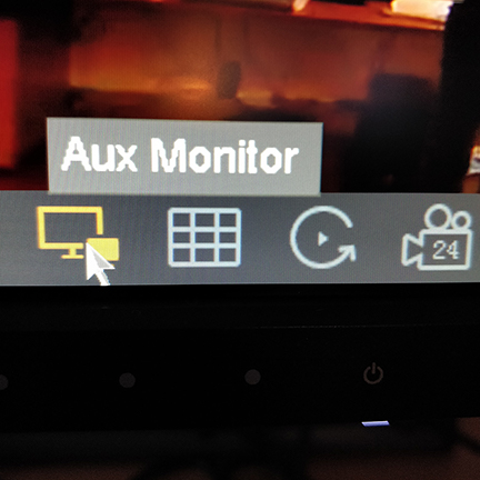

We have a 7716-I NVR as part of our demo system in the office and when we connected two monitors to the VGA & HDMI connections on the back we got the live streams displayed on both monitors just like we did with the K-series NVR. The difference with the I-series NVRs is that they use the latest 4.0 GUI, and on the live view page of this new interface you will find an icon in the bottom right of the screen labelled 'AUX Monitor' (see image below), clicking this icon allows for you to switch control between the HDMI & VGA screens and allows you to move through the NVR menus on one screen whilst keeping the cameras streaming on the 2nd screen.

Now that you have the ability to switch between and control multiple screens you would obviously want to be able to set each screen up with their own camera stream layouts, to do this simply go to the System page (cog icon at the top of the 4.0 GUI) and then click the Live View tab and select the view page from the dropdown options. On this page you can switch between the HDMI & VGA screen and set the camera stream layout for each monitor (see image below). There are limitations to how you can set the layouts, you can set the same camera to appear on both screens in the same place or in different positions and you can also spread all 16/32 cameras out across the 2 screens, the main thing you can't do is have a camera appear in different positions when using different live view layouts on the same screen (e.g. if you put camera 1 in the top left position for the 2*2 layout it will also appear in this top left position when you switch to the 3*3 layout).

Hi Dan,
I want to use HDMI & VGA output together. How can I set duplicate screen ? (I mean both of HDMI and VGA are display same stream)
Hope to get your reply soon.
Thanks.
Ok, see the I-series instructions in the first post of this thread.
You can set the same layout for both the HDMI and VGA outputs via the Live View settings.

Hi all, i have DS-96128NI-I16. Two monitors are on site and both are working ( HDMI/VGA and HDMI2).
Does anybody know how can I use mouse on second output? For now i only have live view on HDMI2 but without possibility to use mouse ( or I don't know how).
Hi @KamirZG
Do you have an "Aux Monitor" button on the live view of your main monitor as is shown in the I-series section of the original post for this thread? If you do that should switch your mouse control between HDMI1 and HDMI2.
Interesting thing about that. It's not supported before v4.40.500 on that model.
First thing i went for was Aux, but there was none.
