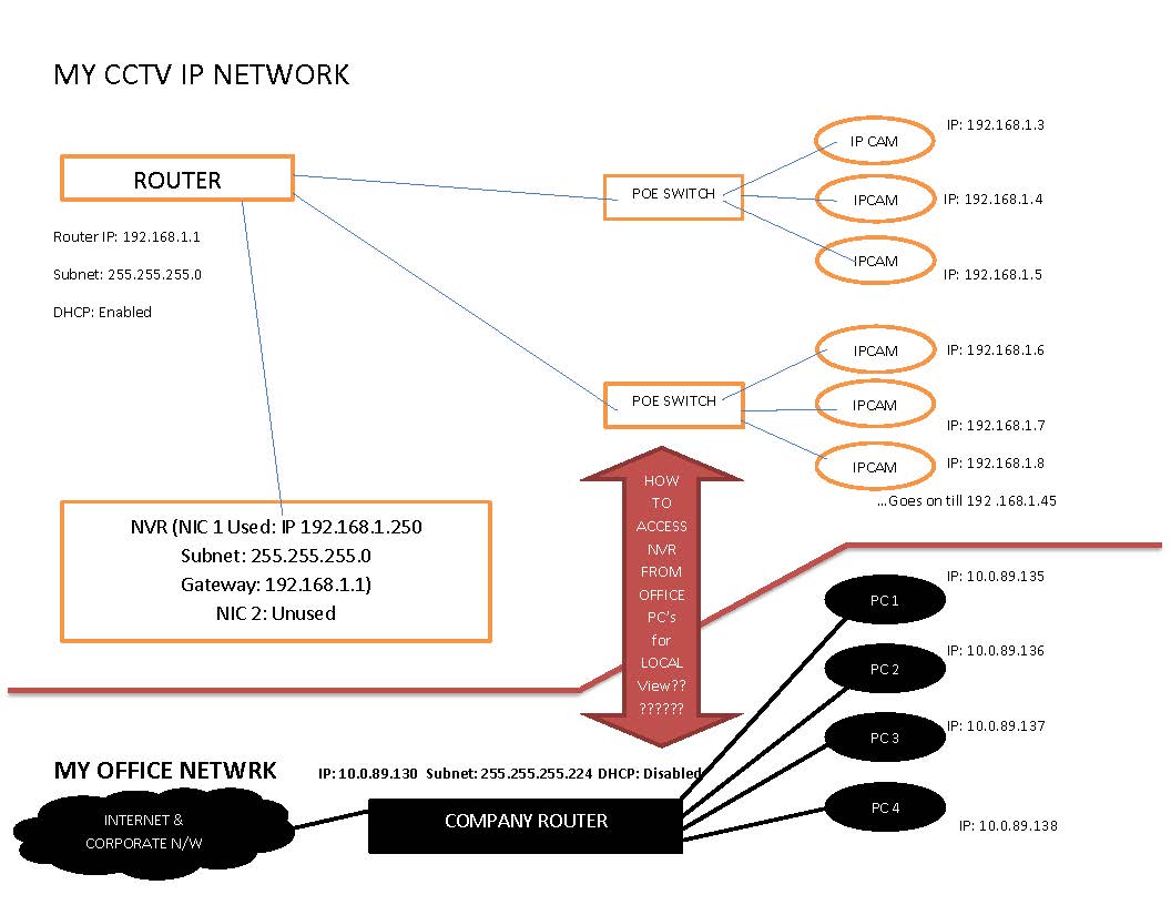

This is the the first time i m posting a query in this forum, i have a IP CCTV network installed,
i need to access the NVR from my local network PC's for local viewing. both the networks have routers and different network settings(IP, gateway, subnet).,
Sorry, But i m a rookie in computer networking & i m a learning cctv integrator. So, it will be a great help if some can guide me through this in laymans language.
I am posting an image below depicting how exactly existing networks are present & some details that i could notice. Hope to find a solution here ASAP. Thank You

Hi, Do you mean that your IP CCTV is at a different site/location to your work PC network?
