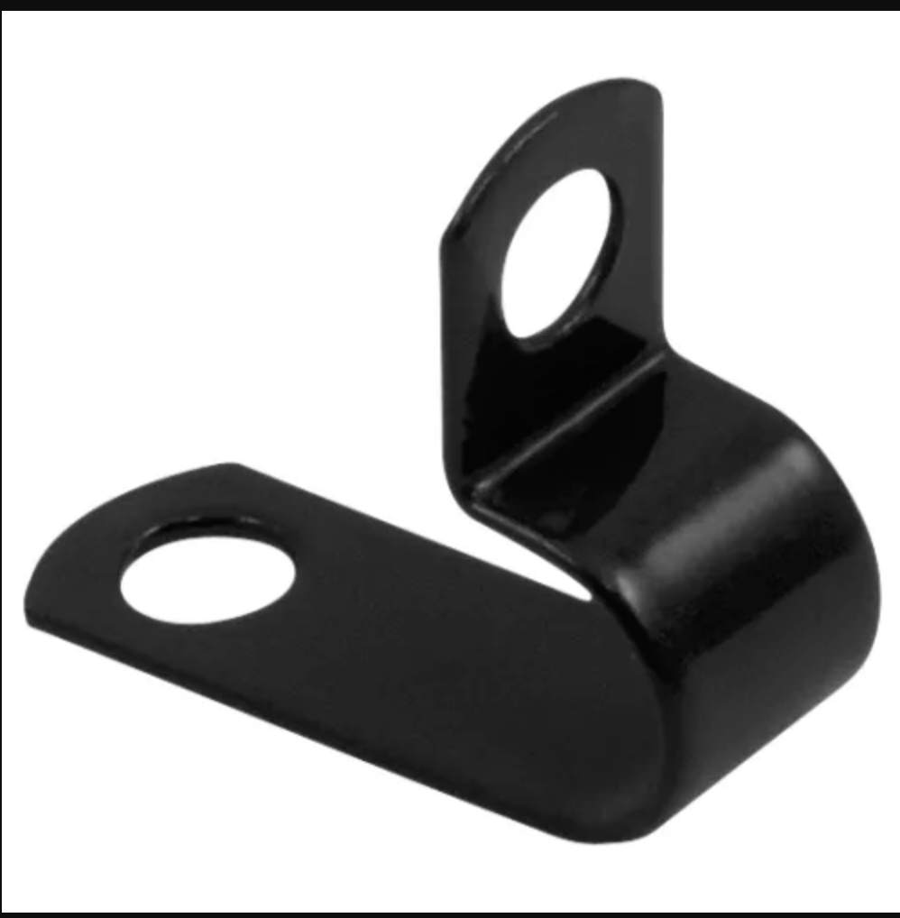

Out of interest if as I think it is - a block of flats/apartments - has the building owner given permission for you to mount the cameras? You might face a hefty bill if you haven't (I'd hope you would have sought permission though of course) I've never tried to attach anything to EPS board before - is it strong enough to hold a rawplug? If it is - you could use these powder coated copper cable clips - they fold over the cable then screw them into the wall/rawplug.
Otherwise a long straight piece of black circular trunking with very long screws to reach the inner wall.
