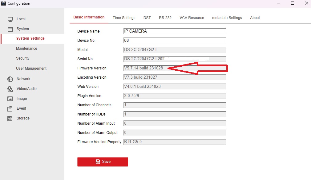

I upgraded my DS-2CD2047G2-L camera, but I don't see any visible changes in the camera interface. What I noticed is that, during human motion detection, I receive notifications even when cats are detected in the area, which is not normal for a professional camera, as cats are not humans

Interesting you should mention cats as I've noticed a few more notifications and when I look it's a cat!! Will have to see how annoying this gets and may consider a downgrade.
