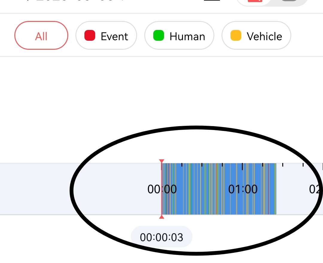

A simple question, in Hik-Connect app when watching Playback, do the colors appear? The event-human-vehicle, like picture
Yes - the latest version (4.63.000) introduces those. However there is a bug and it's no longer possible to disable/enable notifications from the app (the bell icon or the setting that it switches). Hikvision have said that the bug will be fixed in the next version when released.
