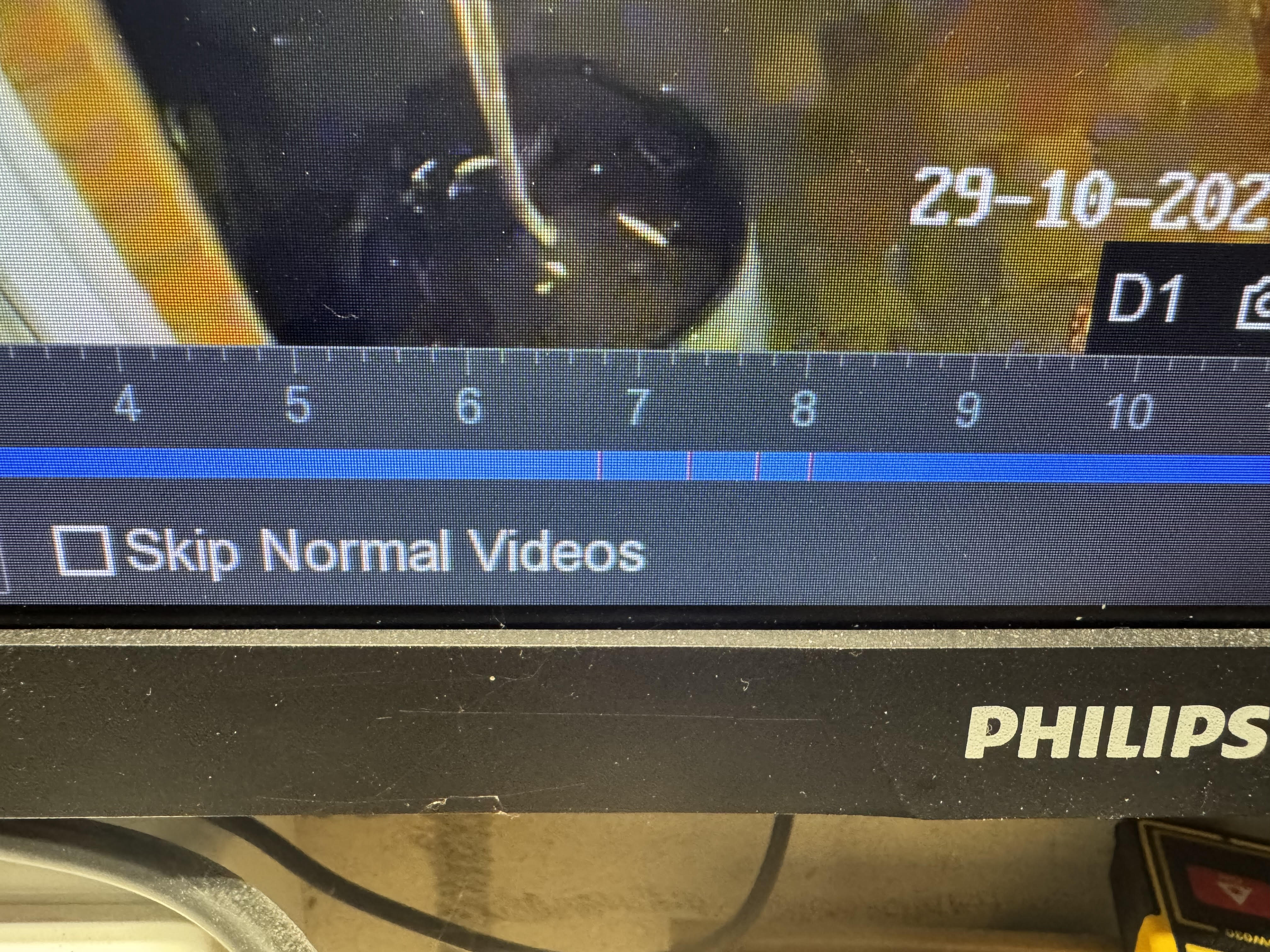

  • Initially, under "playback," I could filter by persons and vehicles (red bars in the blue recording bar, see attachment), which worked brilliantly compared to my previous LTS NVR, which triggered events for every moving leaf. However, after adjusting some settings, I can now only view "normal events" and no longer have the option to filter by persons/vehicles . Could you advise on the correct settings to enable this filter again?

A quick update – I managed to resolve most of the issues:
The option to filter by persons/vehicles reappeared after selecting VCA-mode → by NVR rather than by Camera.
