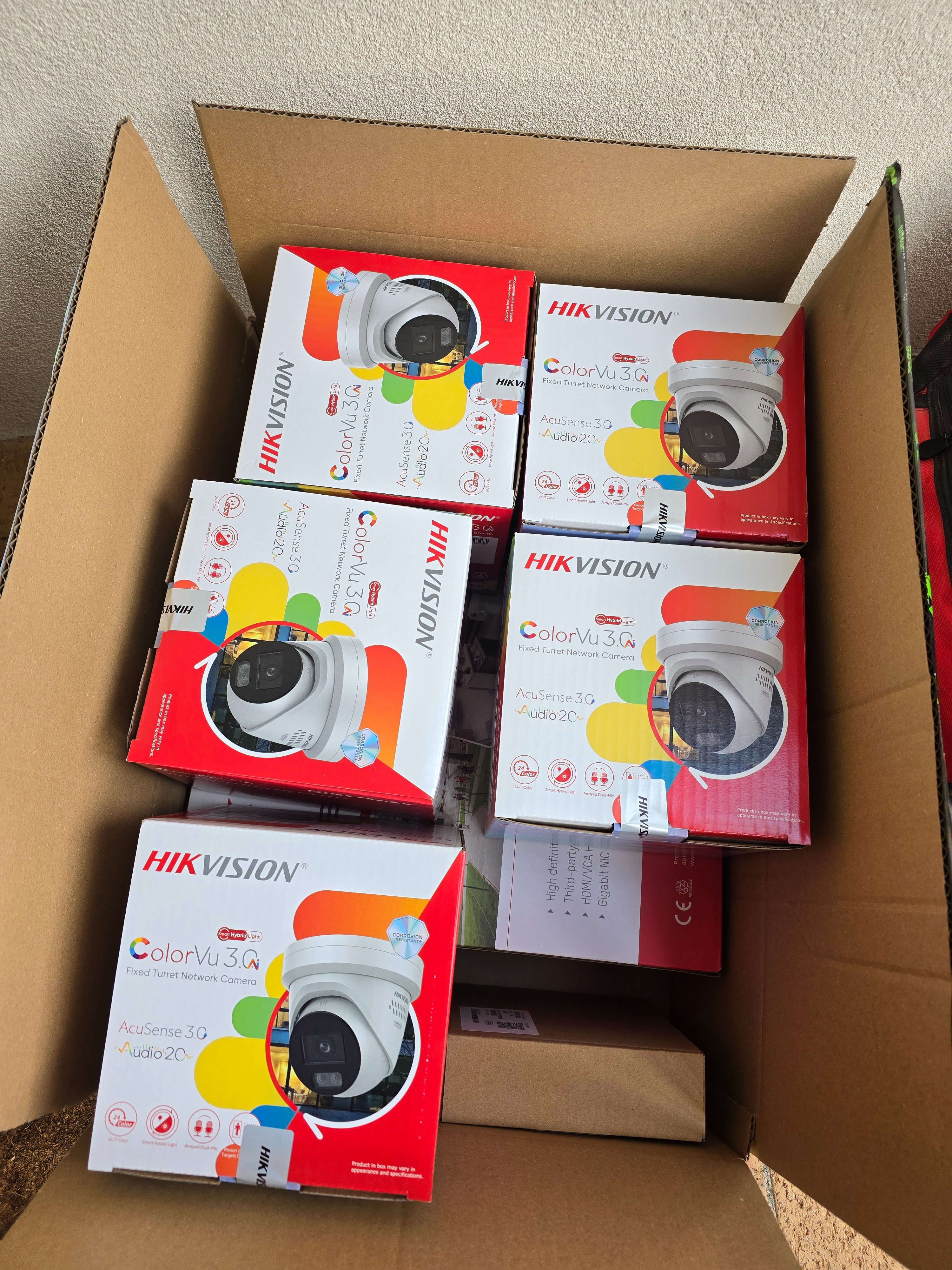

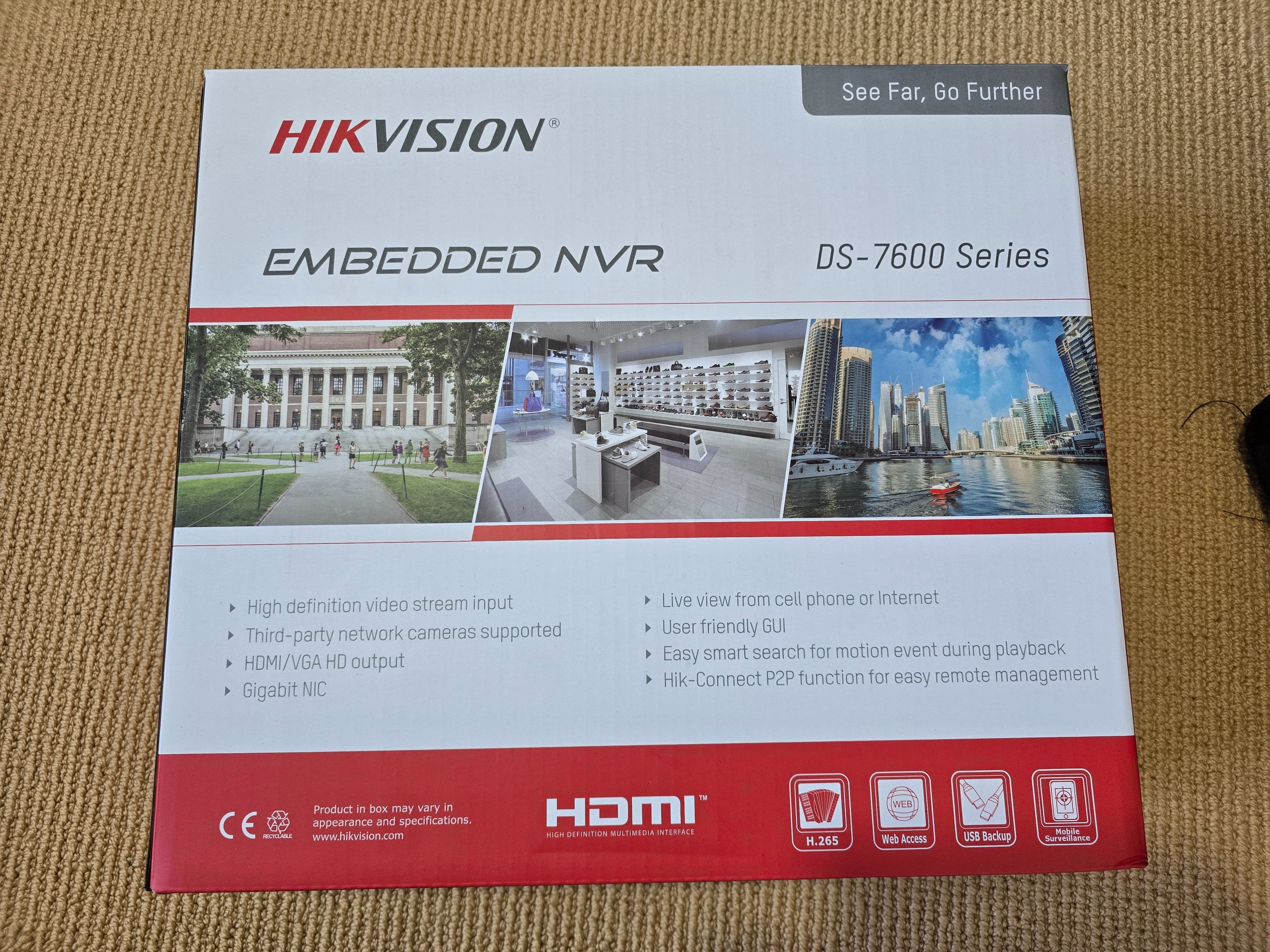

I've recently sacked off my ring system and put in a new hikvision. 4x Ds-2cd2387g3, 1x Ds-2cd2367g3 and a ds7600 server.
