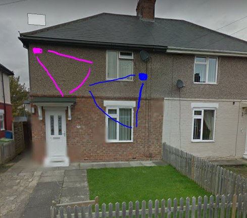

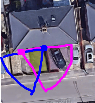

Can turret cameras be mounted vertically on a wall? and would I require a junction box to do so? Also, would mounting this way restrict the turrets movement/field of view? My thought process being that mounting a cam lower down the wall would increase the likelihood of capturing faces of people approaching the house.
I've used a generic house from google, albeit similar to illustrate what i was planning.
Any comments/suggestions greatly appreciated.

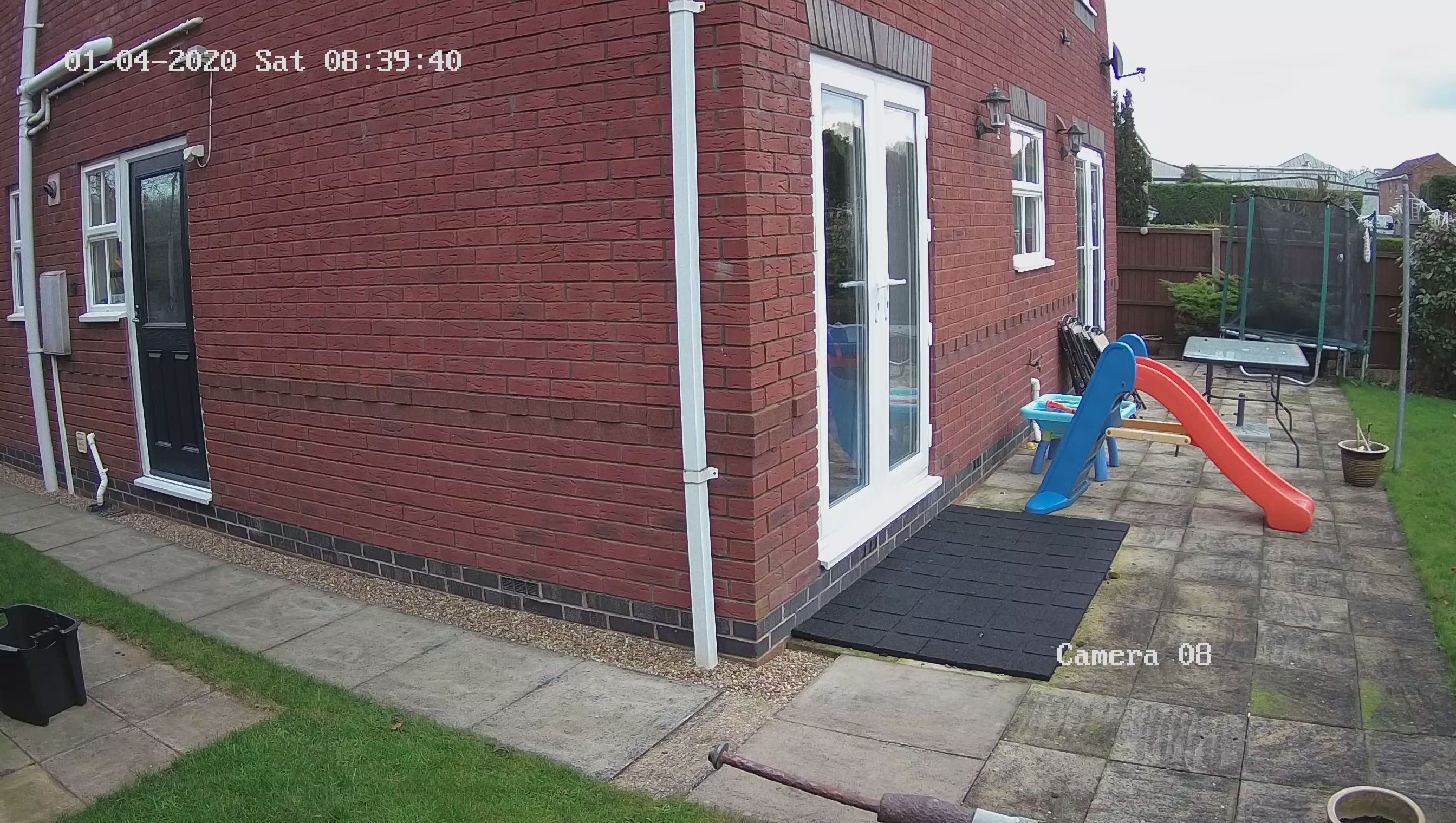

I ran the cameras around my outside fence so they were actually looking back at the house.
Work out the field of view but at least 4mm lens best for catching a face.
As per picture below my cameras are around the perimeter fences, gives a great view of house at a decent height.

Cabling was a cinch. I just purchased a drum of armoured CAT5 cable in and dug it about 8 inches down into the flower beds around the side of the fence. I have a switch in the garage and just one CAT5 cable from the garage back to the house connecting everything to the NVR
