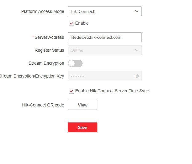

Is your Hik-Connect phone app logged in to the same account that you added the NVR to? Is the NVR showing online and bound in the Hik-Connect Platform Access page on the NVR?
The Register status is Online.
I am not sure about the first part? I only have one Hik Connect Account and it shows the NVR and older Events (Events prior to the moving)
