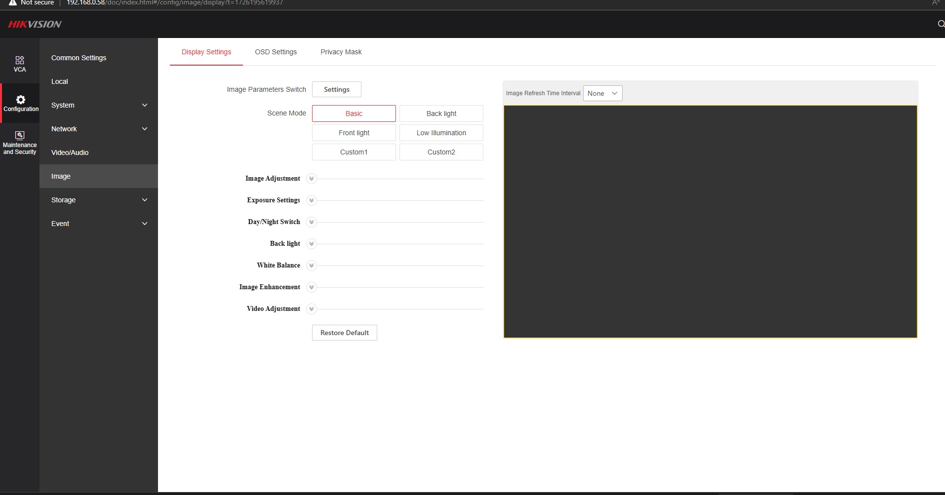

No image through browser on camera settings page?
dpruk
7
Does anybody know how to get image to show through browser on camera settings page?
Browsed to my nvr then camera settings page but no video:

Does anybody know how to get image to show through browser on camera settings page. Browsed to my nvr then camera settings page but no videoView attachment 11640
Which NVR and firmware version? Which browser?:
  • If it’s Safari, forget it; support for Mac users is woeful.
  • For Windows browsers you may need the latest localservice or plugin installed.
  • If it’s a mobile device it’ll likely not work
NVR
Firmware Version
V5.03.020 build 240904
Browser Microsoft Edge (also tried in explorer mode) I have also installed the latest plugins

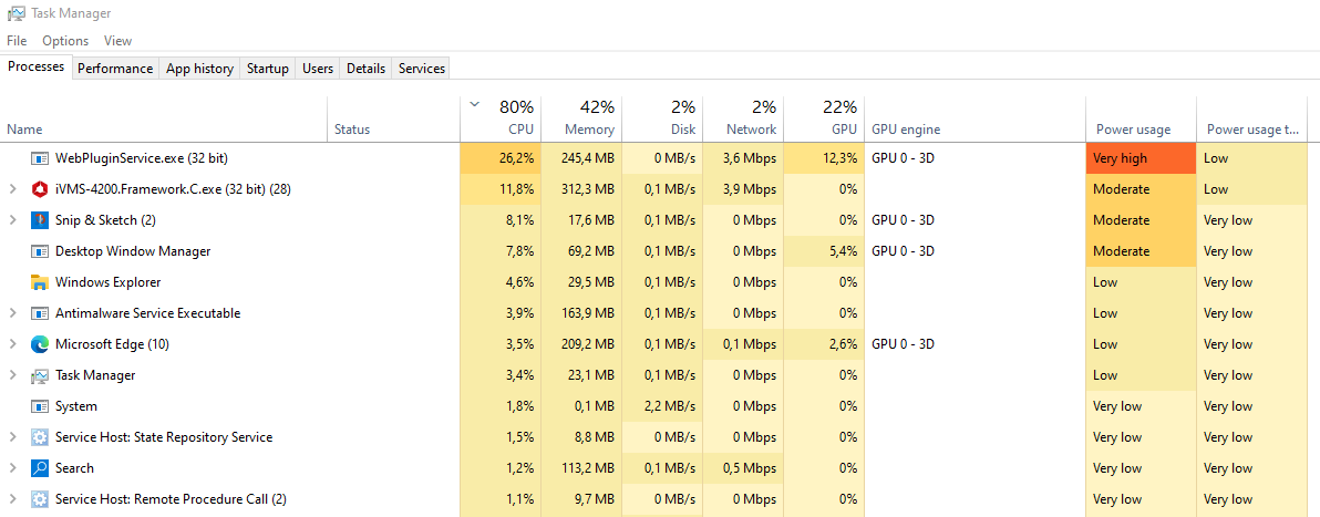

For Microsoft Edge to work, you must see this in Task Manager. WebPluginService.exe(32bit) with high CPU usage:
