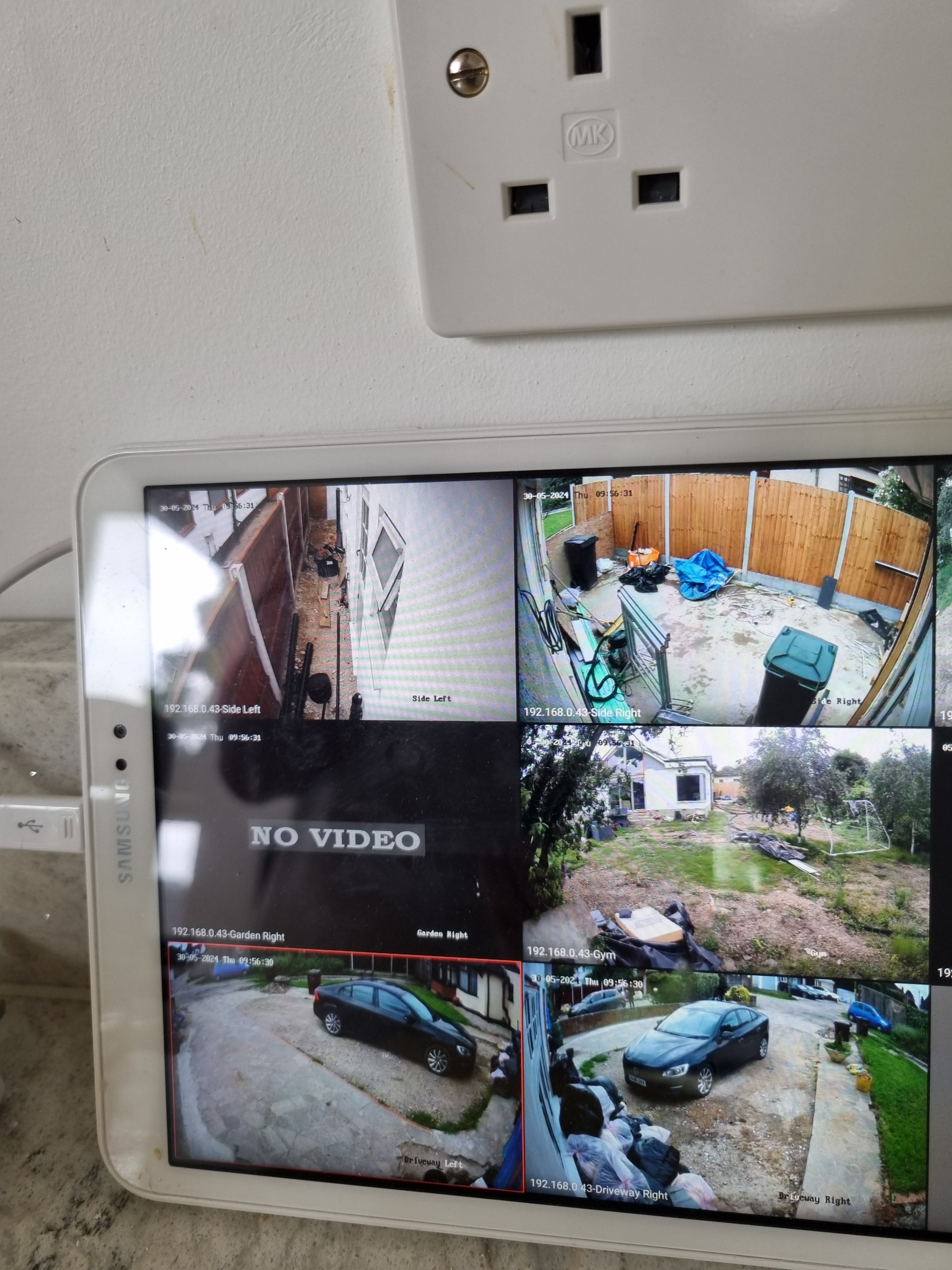

Can anyone help, I have an intermittent no video issue on one of my 8 hikvision cameras?
I've unplugged and tried another camera which didn't fix the problem. I then plugged the original camera back in and it worked
However, after a few hours it went back to no video. It seems an intermittent issue and I'm struggling to resolve it.
On other occasions I get black and white images.
Any help would be appreciated.

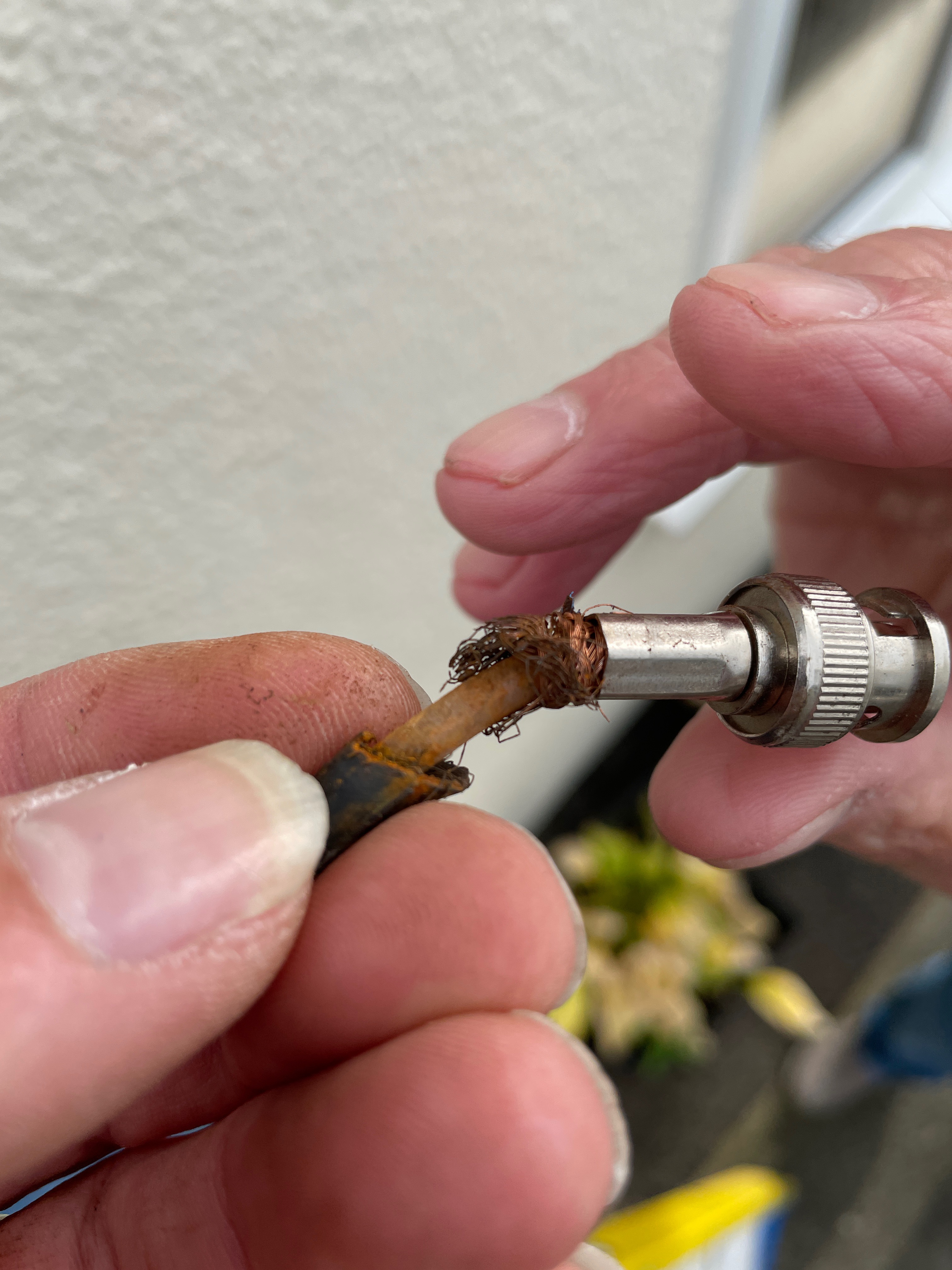

  • Poor termination. The BNC is poorly fitted at one or both ends of the cable. Moisture may have got to the connector at the camera end. When this happens it creeps between the outer sheath and braid screen of the coax, corroding it and massively increasing its resistance until it fails completely. Here's an example of a poorly fitted BNC causing that issue (an electrician had fitted the connectors incorrectly using pliers and as usual muggins here is the one who has to tell the customer they were robbed by an amateur):

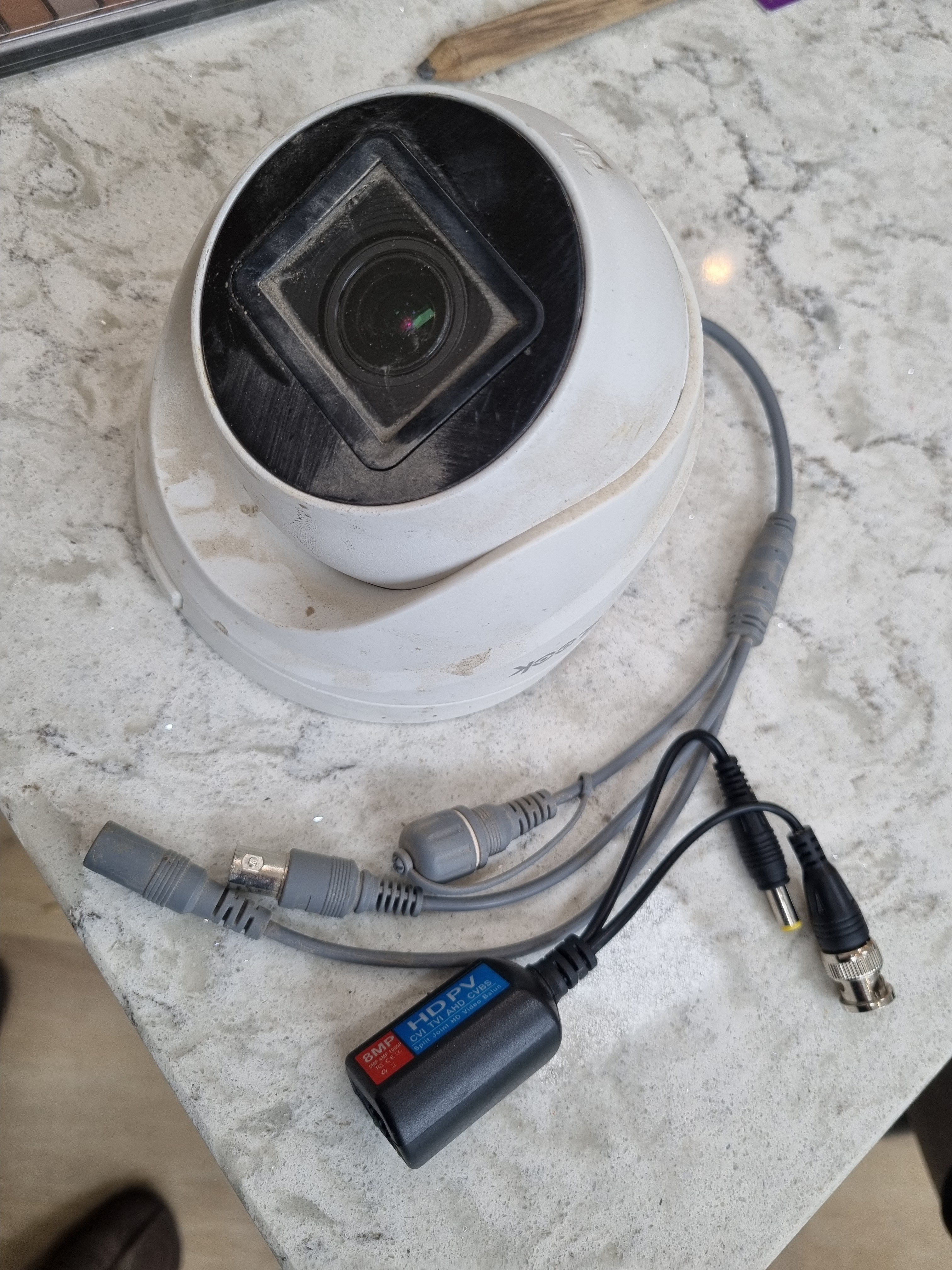

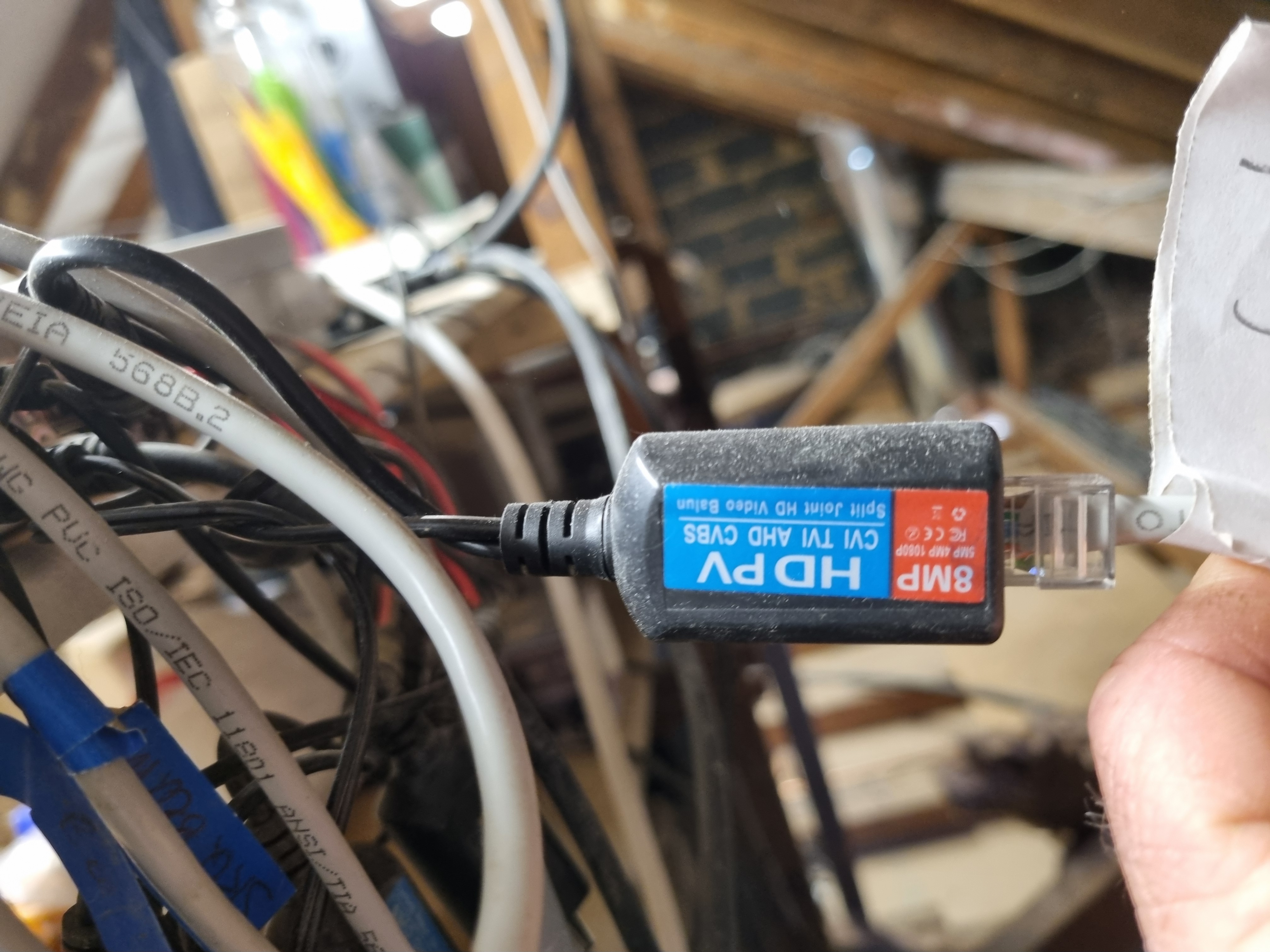

I've got 6 analogue and 2 ip cameras through DVR It's one of these cameras. I use a power supply and then one of these cables, see picture.
I will try and change the power output in the power supply to see if it resolves the fault.

Ok so it's an analogue camera that's causing the issue. I see you're using video baluns to convert the coax to CAT5E cable...The most likely issue so do this before going any further:
Take out the two wires from the balun (make a note of the polarity) strip them back to the correct length and re insert them. Do that at both the DVR end and camera end of the link. If they're not stripped back far enough, they can appear to connected securely but the bare wires aren't making proper contact with the terminal in the balun.

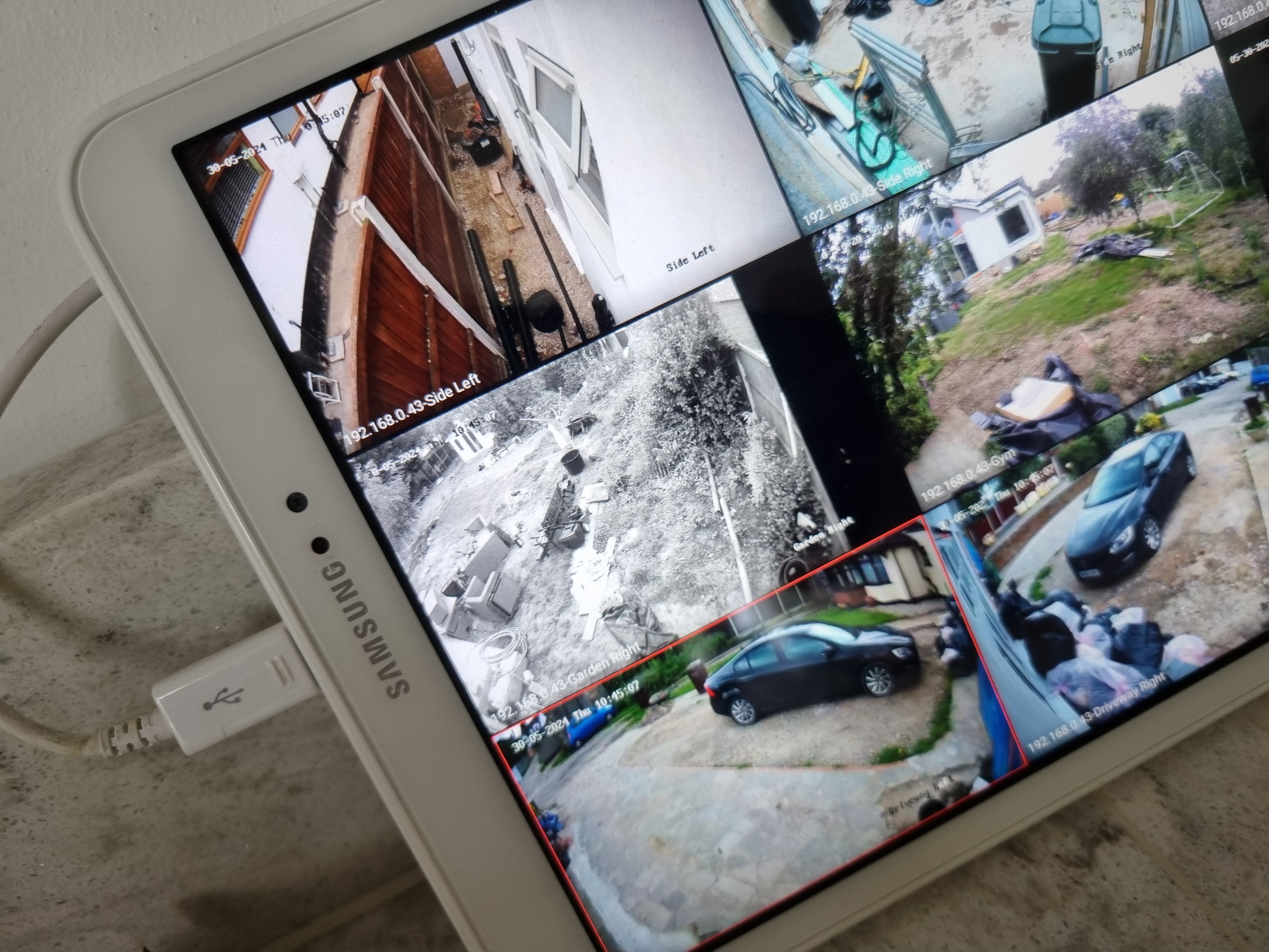

The issue has now moved onto another camera and it's gone black and white. Does anyone know what's causing it and the fix?

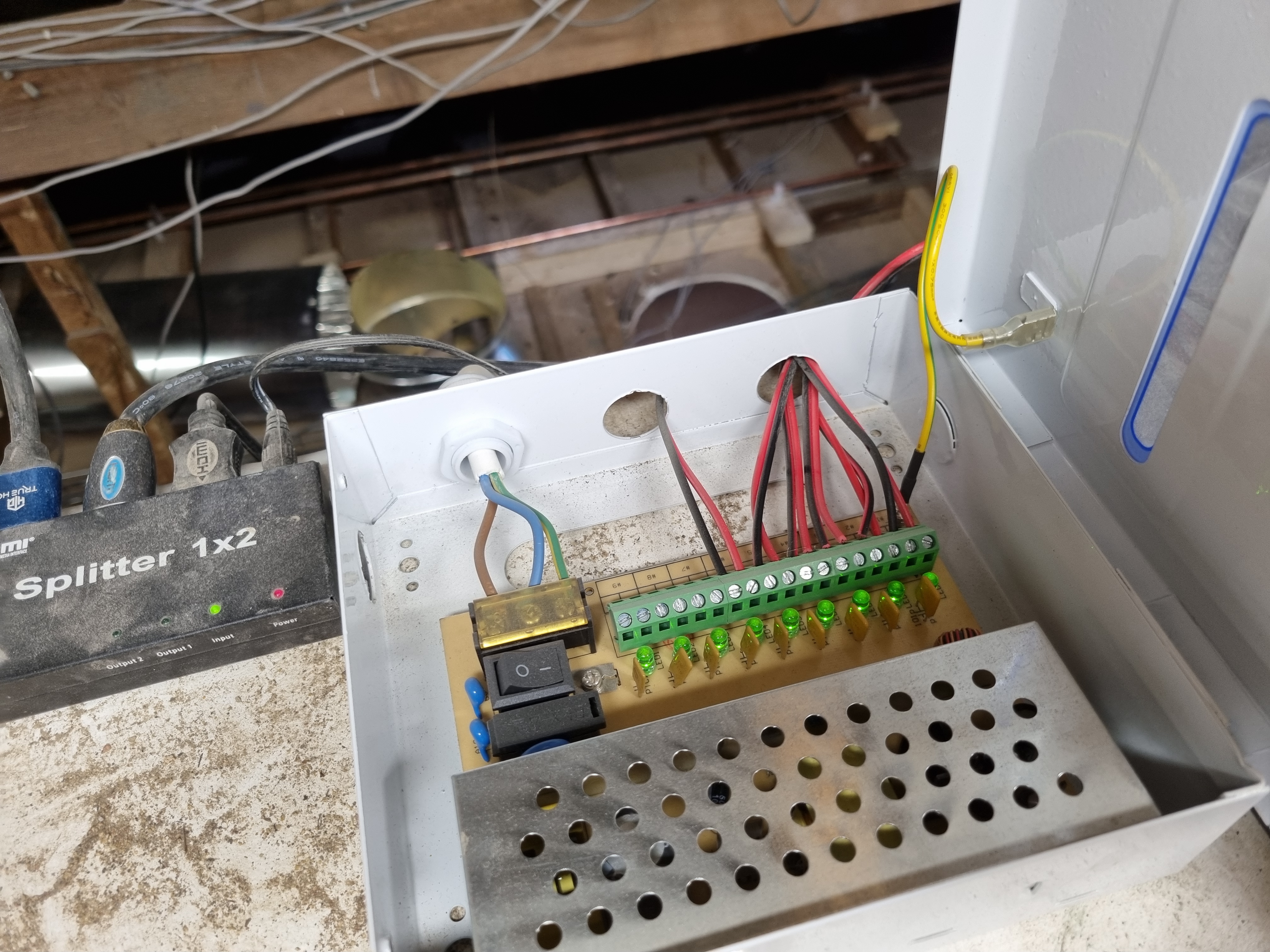

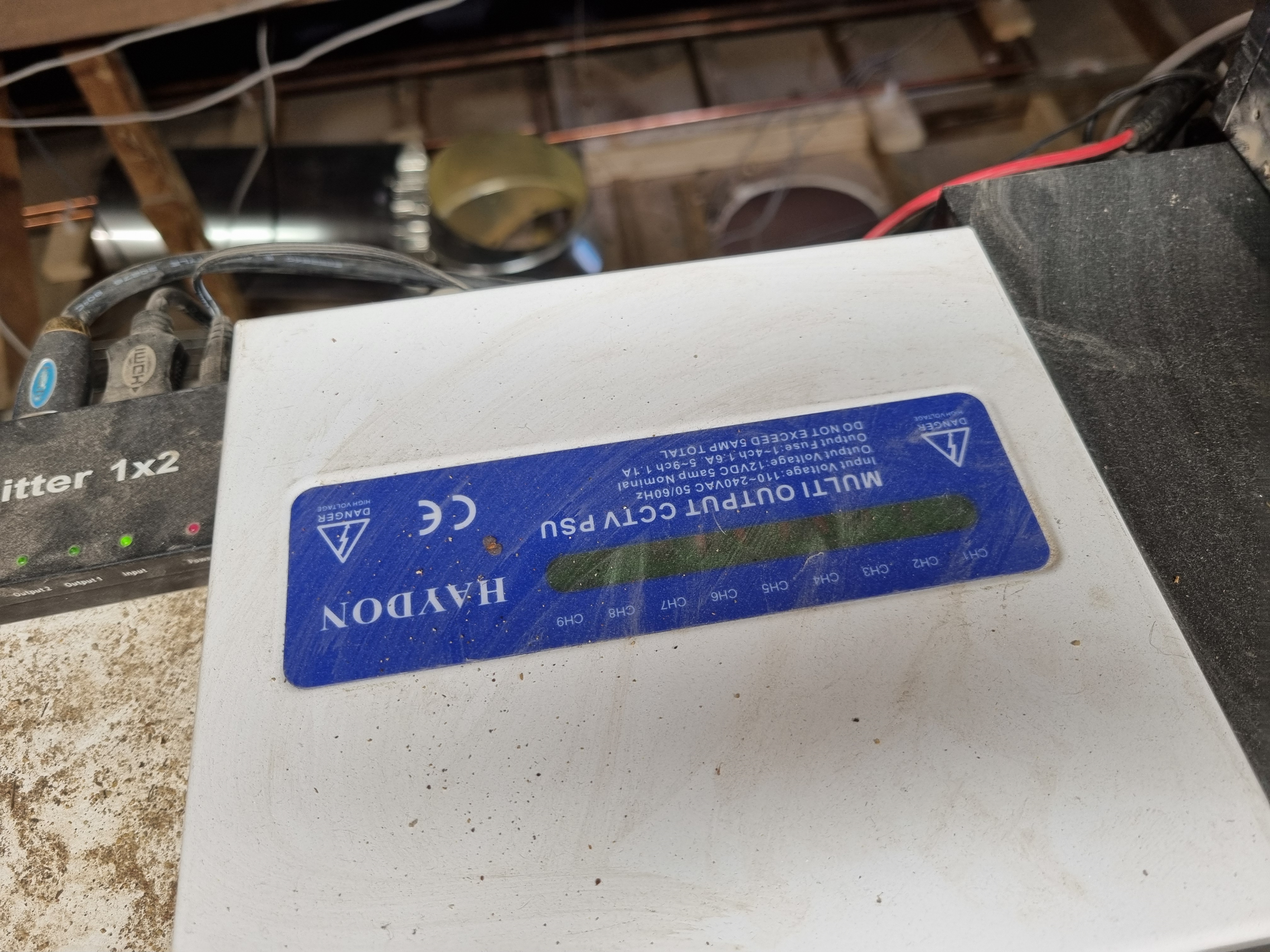

Hi, I'm using one power supply and then Baluns for each camera. 6 in total that are analogue.
I've added photos.
Thanks for your help

If you haven't increased the number of cameras that your single PSU is powering, then perhaps it has degraded and is struggling.
You could test by disconnecting one or two cameras and seeing if all the others continue to work well, and whether issues return as you reconnect those.
As per @JB1970 comments above, cabling issues can also result in cameras not receiving sufficient power e.g. damage to the cables or corrosion, so it is worth checking / re-making the terminations also.

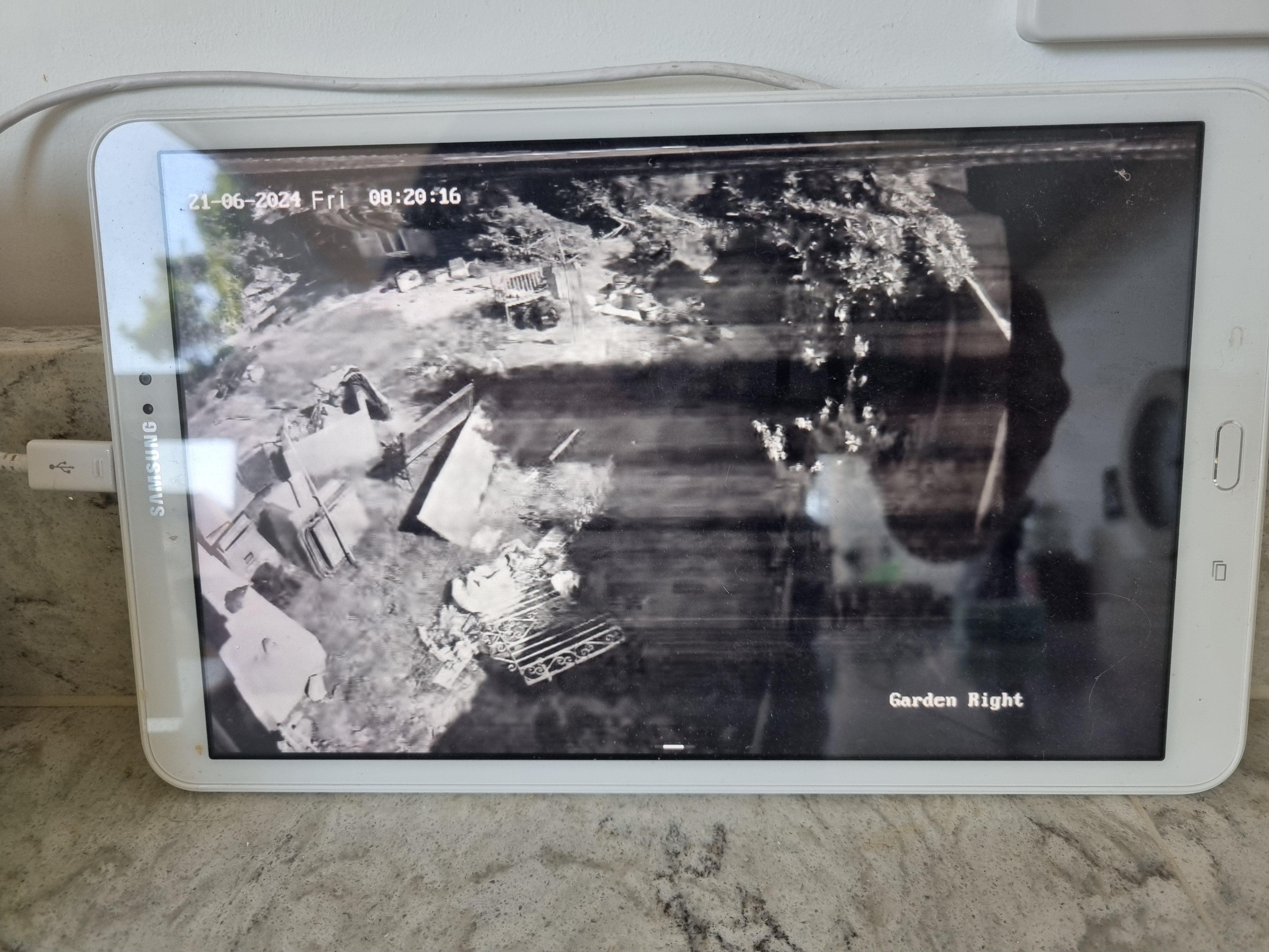

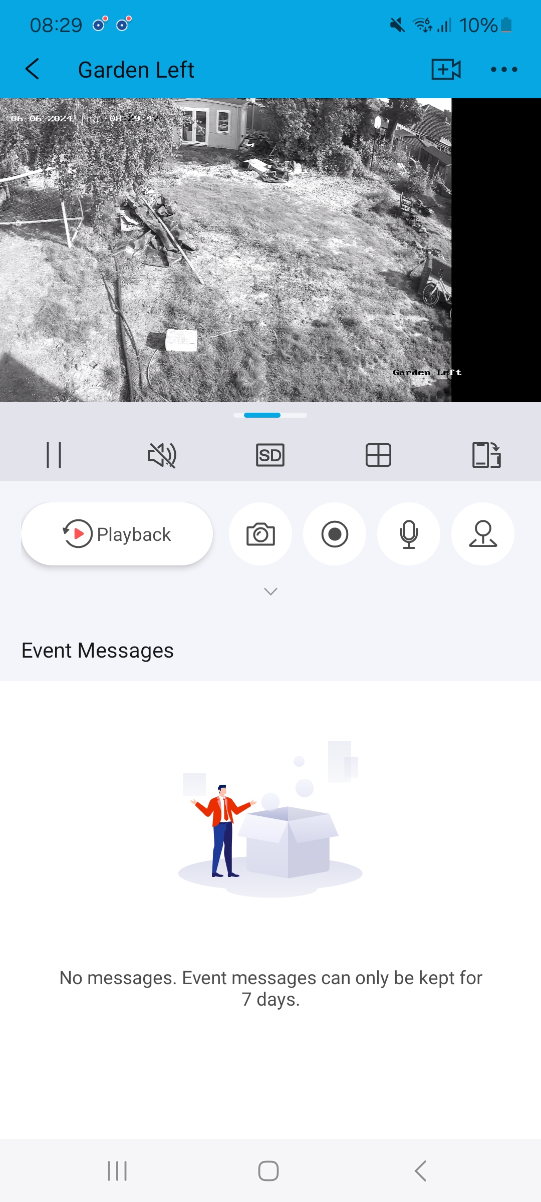

Anyone able to help with an intermittent issue. 2 of my analogue cameras are either flickering black and white, solid black and white, or no video.
I have 7 cameras in total, 2 are IP accusense and 5 are through the DVR. The analogue ones run through a power supply.
Any help would be really appreciated
