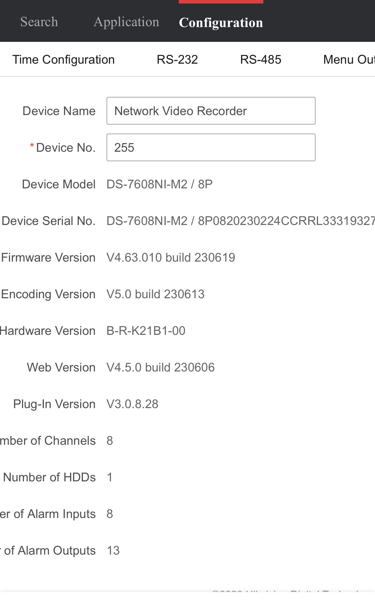

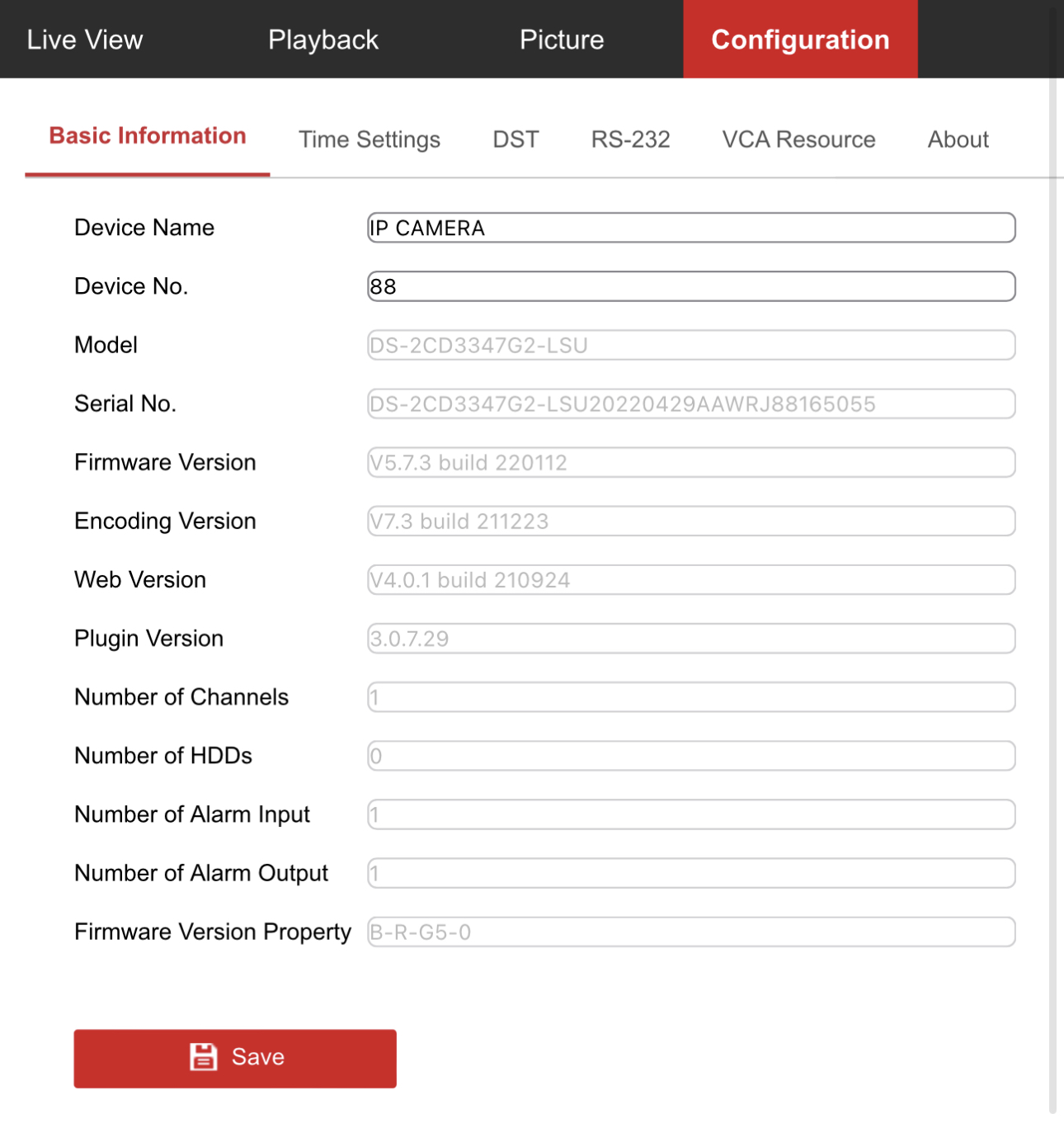

I hope someone can advise on the following issue I’m having with the Hikvision cctv system at my daughters house as below which is less than two years old.
DS- 7608NI-M2/8P with 4 x Colorview DS-2CD3347G2-LSU 4MP IP which also records all different events such as person/vehicle etc 24/7
2TB Seagste Skyhawk hdd installed.

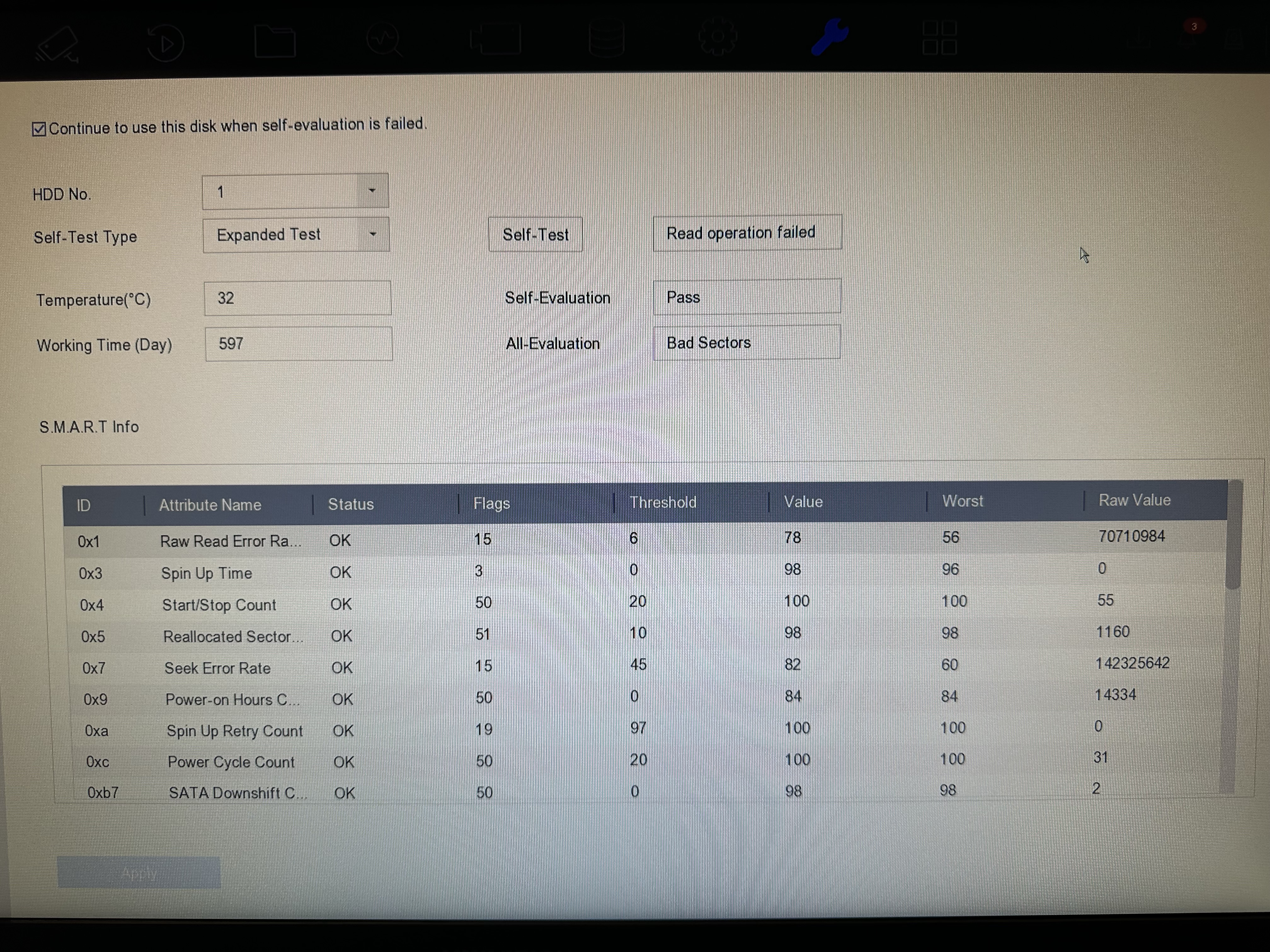

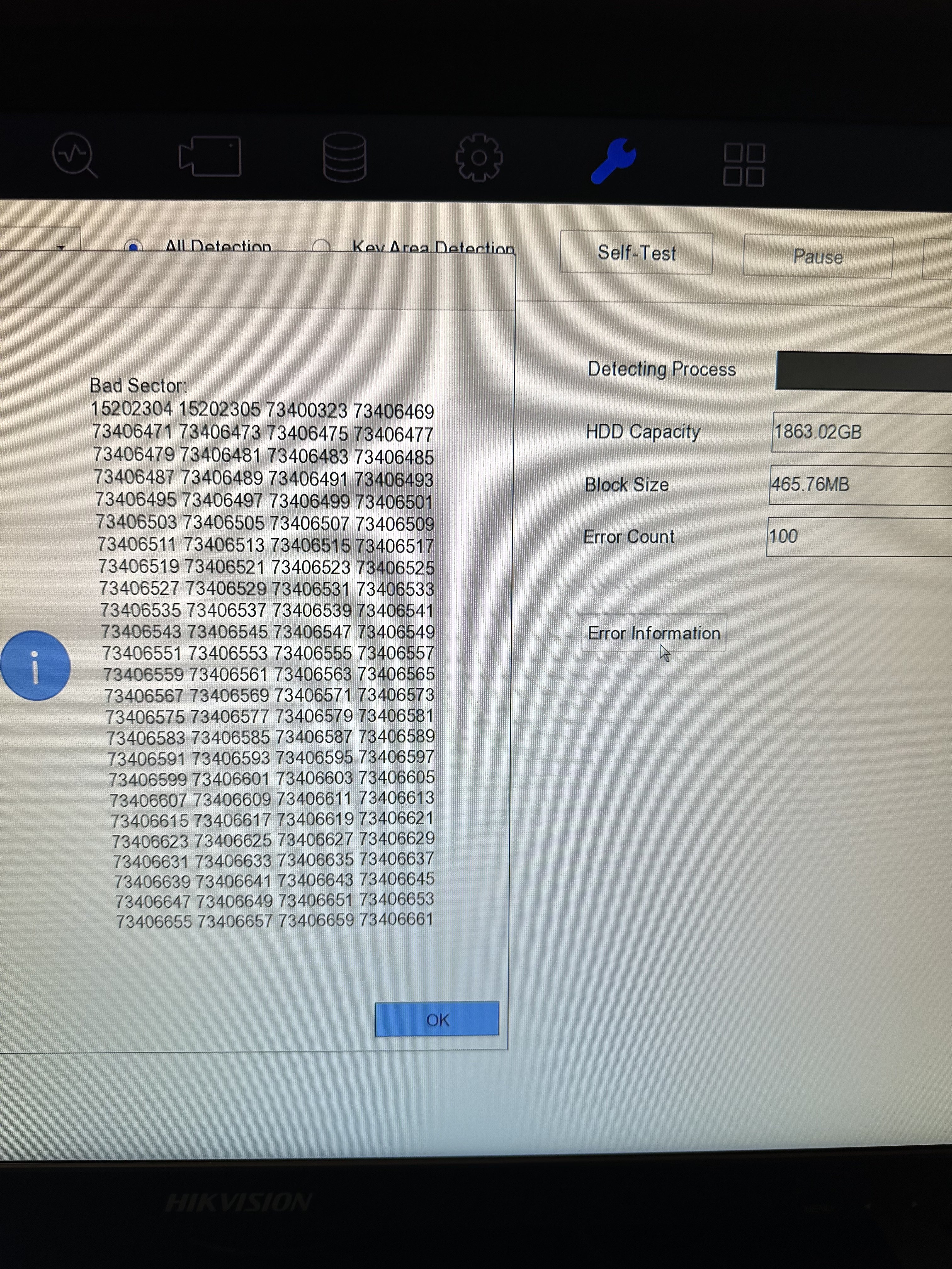

The disk status has been showing Exception but if you reboot the system the status goes back to normal and you can also see all the previous playback recordings for the last two weeks. Sometimes if you reboot the NVR then only some days are shown for playback.
I am wandering if this is a hdd failure issue and why it’s happened so soon. I’ve not been over yet to actually do a SMART or full format test before deciding to replace the hdd as not sure if it’s still under warranty.
