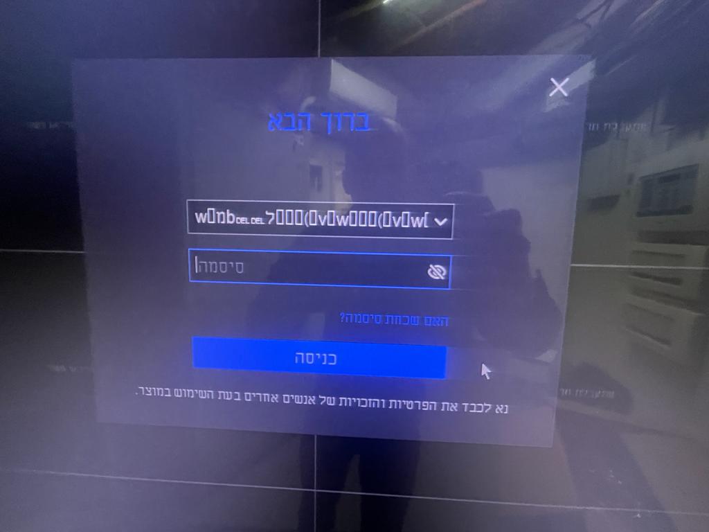

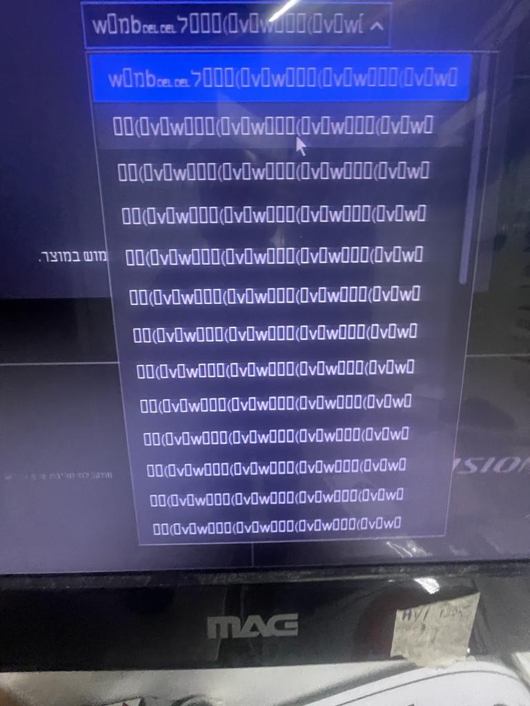

hello, i have 4 NVR ds-7616ni-k2 i just updated 1 for version v4.72 all worked fine in the 1 nvr the update good, but when i tryed to update the sec nvr (same as the first NVR ds-7616ni-k2) i get all installd but after he power on i get in the open window for "username" wrote in "gibberish"
when i try to put my password its not worked tryed to restart it from hikconnect tryed to use tftp - dont know why not working, iam really stuck how i get him to work again and from where came all 19 users thet in there, hope anyone could help thnx.

it showes active on sadp, cant show on web for some reason, it now run the last update 4.72.
and again i have 4 nvr wanted to update all 4 one go well with the update and the sec do this so i was stoping from update the rest of the 2 nvr
what can i do? how can i reset thet nvr i cant log in via password even hik connect beacuse all those users popup
Did you try switching it off and on again since this occurred?
thets what iam asking how i can update it again? he go into loop of transmitting, on tftp this is the only way to update? i read the updte via usb from tftp is only frimware under 32M how can i update it again, thx for trying to help
