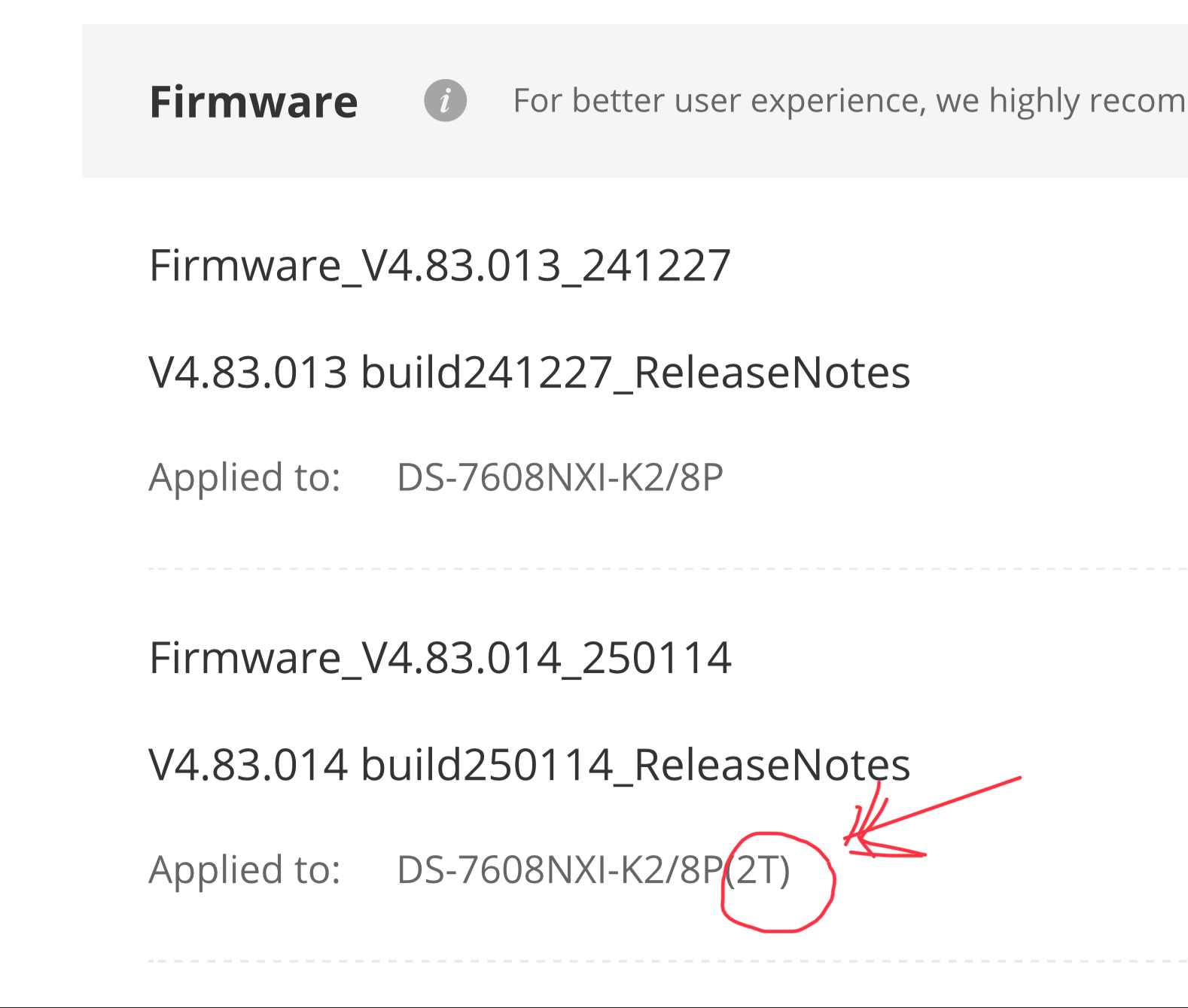

Hi,
My question is can i use the firmware for DS-7608NXI-K2/8P(2T) to my NVR DS-7608NXI-K2/8P ,
After i google i found both are very similar the only key difference between them:
This model comes with 2TB of pre-installed storage (hard drive included)
Hi
First of all, on release notes, they don't say what they fixed, which is usually nothing.
As you have mentioned on a previous post, which I also confirmed, there was a serious issue with Hik-Connect, which was fixed either by going back to v4.83.011 or going back to a version of Hik-Connect v6.6.500.1107
Same issue exists on Hik-Connect for some users of the (D) version that loaded this latest firmware v4.83.014 build250114. You can find this on Youtube.
Also some new issues on 1xx3G2 cameras, where Motion detection areas are reset by themselves after every NVR reboot. So your previous issue is possibly not fixed and it's not worth the risk. I stay on v4.83.011
Another thing that I noticed, is that your NVR is not EOL as a POE one, in contrast to mine which is the same without the POE. I don't know what to say anymore about them.....
