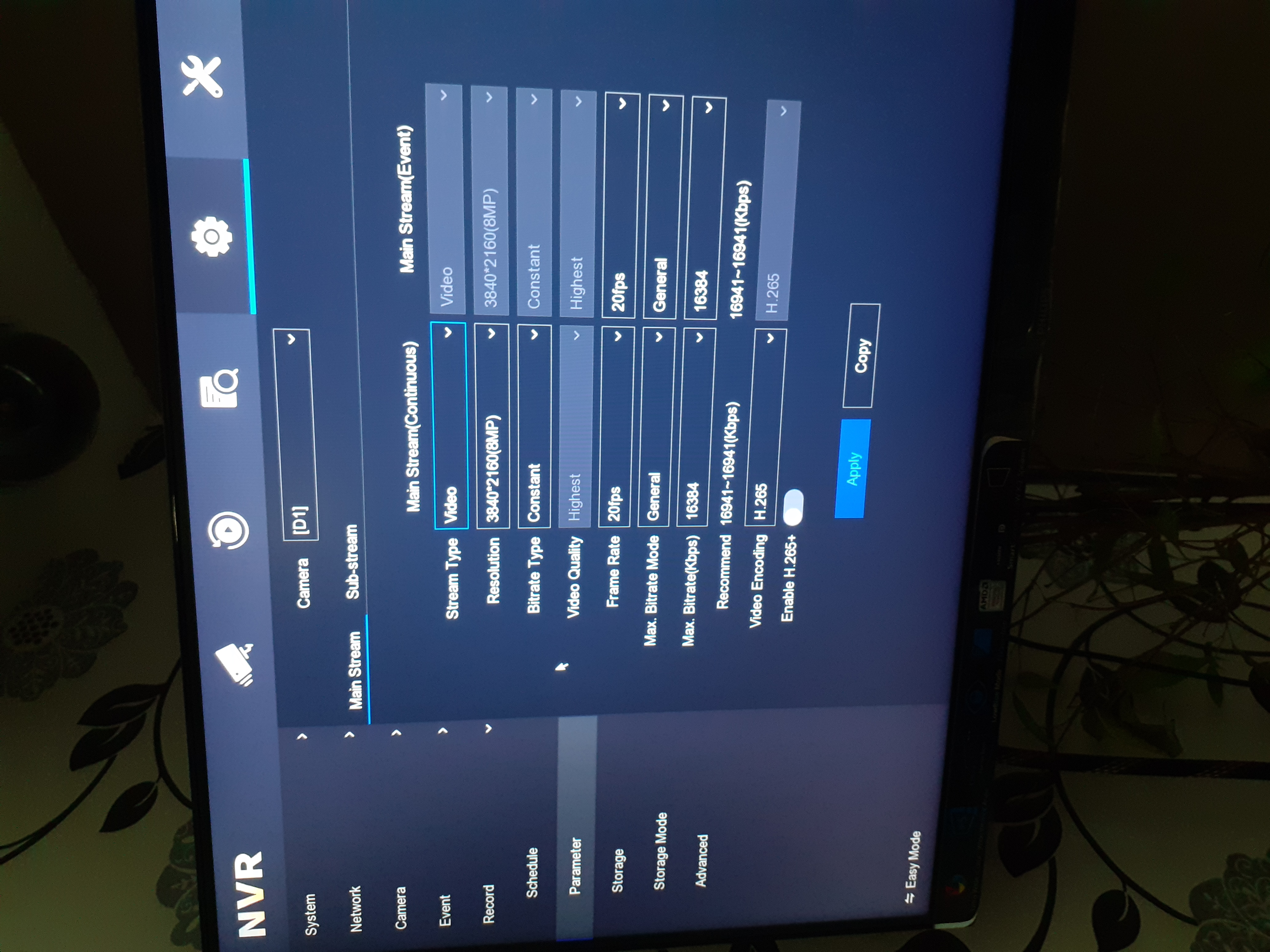

My issue is that that live view and recording is losing a lot of frames in Main stream i have set it to 25 but the actual frames are from 1 to 15. Most of the time it is 1 or a bit higher.
Live fiew feed freezes loses a lot of picture when objects are moving or don't even pick them up at all.
Even if i select
3072*1728 It gets better, but not by much.
If i want full 4k and full frame rate with max bitrate being 16mbps (maximum for the box i think) the picture is nearly never live just freezing all the time and mostly 1fps
It says that it is recommended to select 25mbps bitrate but the box doesn't offer me that.
It is set to record only on events
Nighthawk 4tb brand new.
I am fuming i can't figure out what why it wouldn't work properly with 4k i am thinking to return the box as i have had enough with this freezing. Any help will be appreciated

Exposure is set to 1/50
WDR off
If my settings are off i welcome anyone that could lead me to the right direction.
