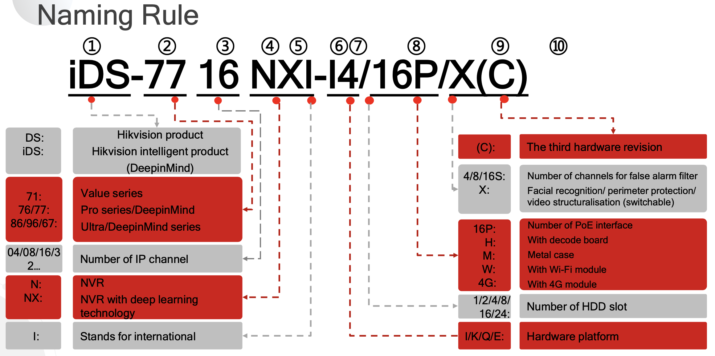

- what is the difference between the NI and the NXI range? not clear to me.

Both NI & NXI I-series NVR will support AcuSense cameras, the main difference is that the NXI AcuSense NVRs will allow you to add AcuSense features to a small number of low-resolution non-AcuSense cameras (there are some other slight spec differences explained in the above post).

I think it's just the standard I series that's discontinued and the NXI I series is still current.
It's the bit after the hyphen that dictates whether it's an I, K or M series so 'I2' denotes I series with 2 hard drive bays. The 'I' in NXI and NI just means 'International'. See below for the NVR model number details (E series obsolete, Q series not available in the UK and M series not mentioned as the slide has not been updated as yet):

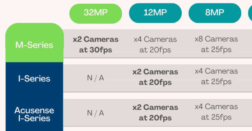

Regarding specifications and what differs between models, you're best off downloading the Hikvision pdf data sheets to compare features in greater detail. you can get those straight from the Hikvision website product page.
Decoding capability is more important for playback than live view.
Live View - When you're in a multi screen view, you're unlikely to view all cameras at their full 8MP resolution as there's no need due to the image size on screen. Depending on the screen layout, the NVR will show the lower resolution sub stream for multi screen live view. When you double click one of the images to show that camera full screen, it will automatically switch to show you the main stream. On the 8MP cameras, you can now run the sub stream up to 720P resolution so multi screen image quality won't be compromised.
Playback - This is where decoding capability matters if you want to playback multiple channels simultaneously, as you'll be viewing the main stream. Again it's rarely necessary to view every camera at once - if you're viewing footage of someone breaking into your car at the front of the house, there's no need to be simultaneously viewing the back garden. Also 'smart playback' (when you're filtering to show alerts on the timeline) is only available for single camera playback regardless of model. If you go over the decoding capability, one or more screen segments will show 'no resource'
So to expand on this, JP Colin is correct about the NXI’s only supporting 4 8mp’s cameras at 25fps. After this if you add any more cameras then the cameras in streamed playback will become choppy as hell and appear to freeze for upto 5-6 seconds at a time especially when streaming to hik connect.
