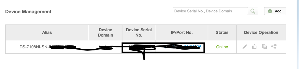

See the screenshot?
OK - this proves that the camera is able to phone home to the portal.

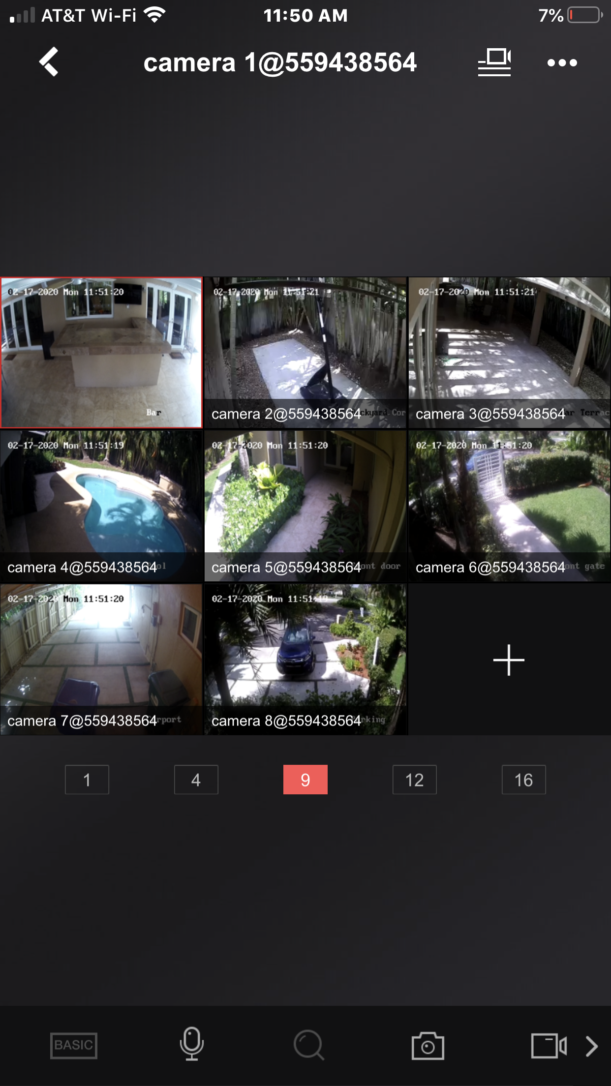

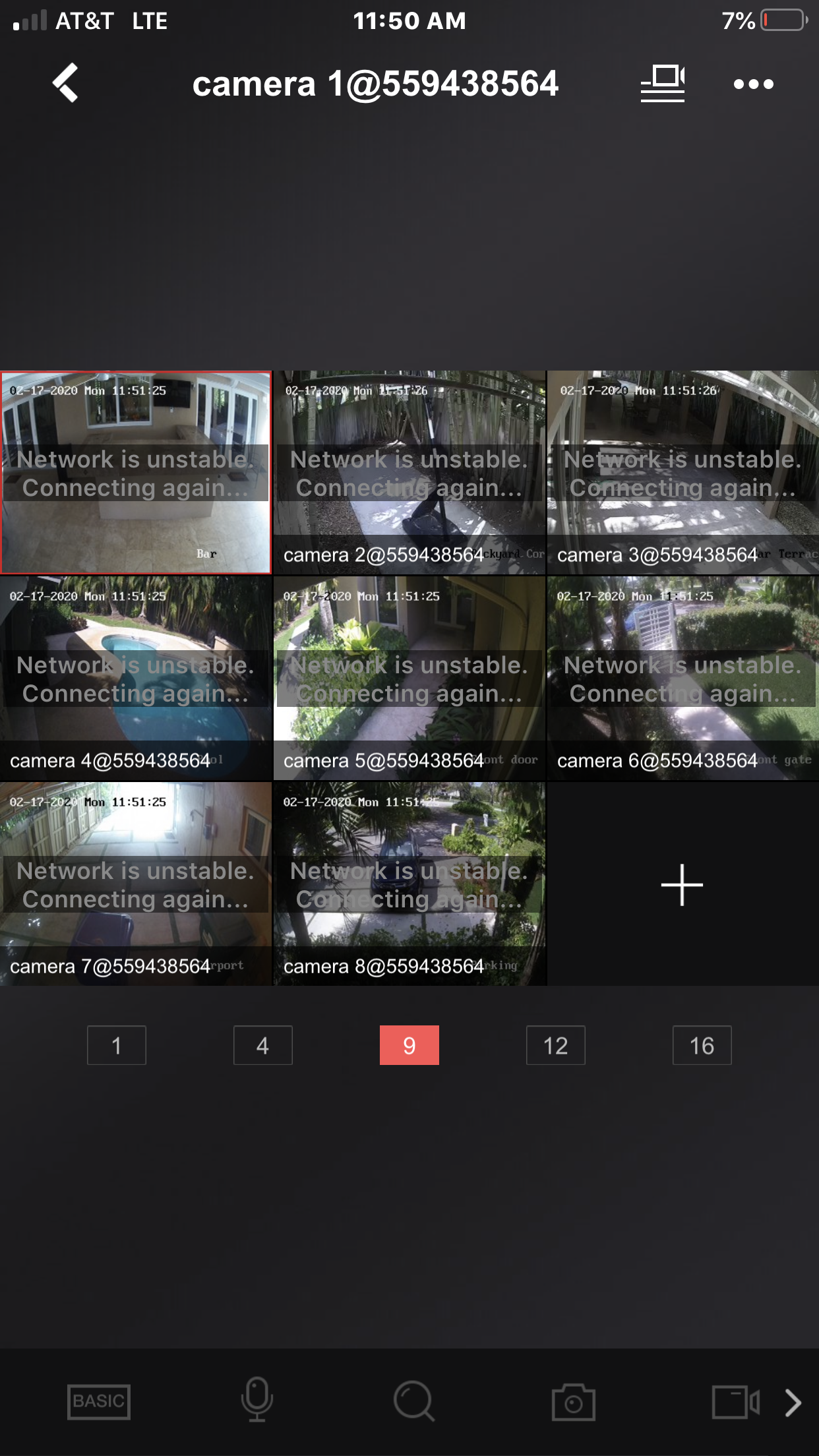

here are two app screenshots... one on WIFI, then the other switched to LTE.

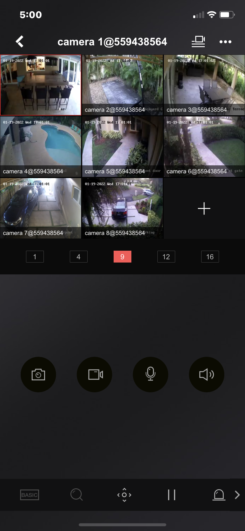

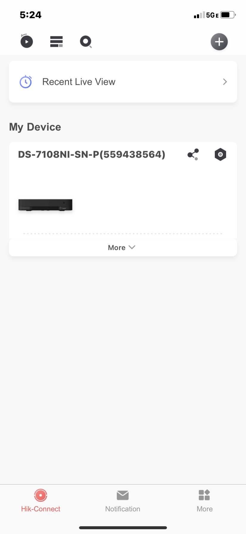

Cannot see on mobile, only when my phone is on the same wifi as the hikvision server. Once i leave my house, i cannot access remotely on phone.
Hikconnect shows ONLINE.
My server is a DS-7108NI-SN/P
it has 8 cameras plugged into it.
It is hardwired into my router
When I am on wifi on my iphone, I can see the cameras via the hikvision app.
When I step out of wi-fi and into 4g/5g mobile service, I can no longer see the cameras.
Again, hikconnect shows ONLINE.
Help me please!
