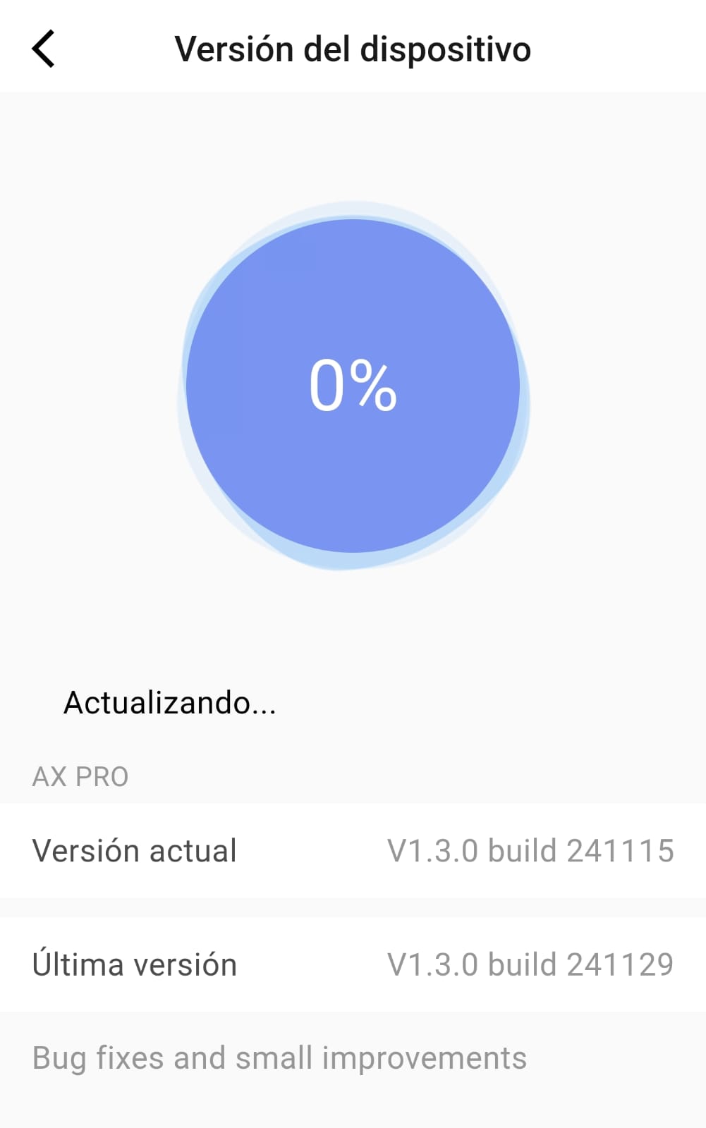

My alarm wants to update to the latest version 1.3.0 241129. The problem is that it is stuck at 0%.

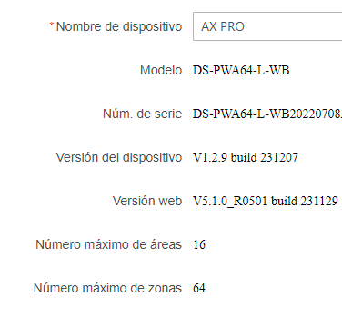

In addition, the current version displayed, 1.3.0 241115 IS NOT the one that the panel currently has. According to the website, the version installed is 1.2.9 build 231207.

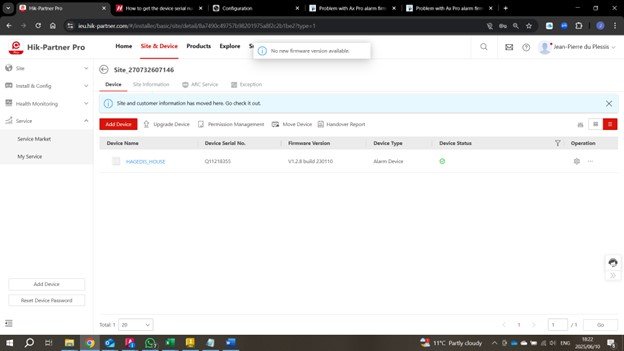

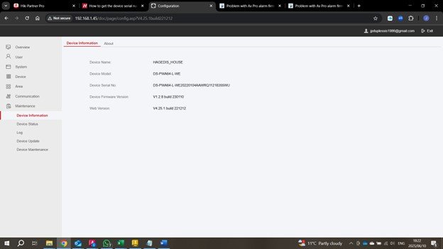

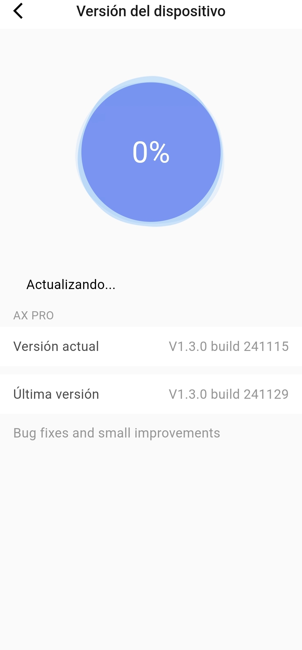

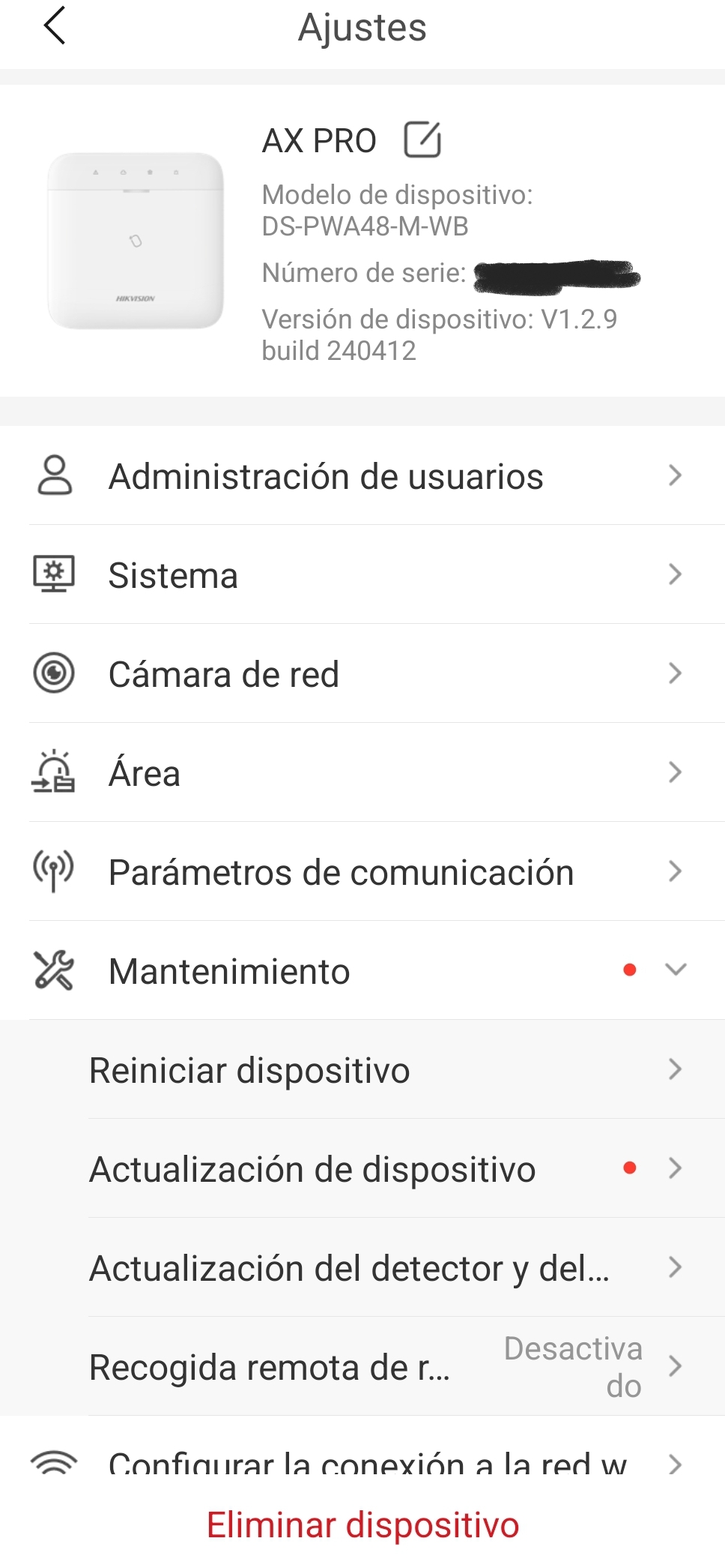

I had the same problem when upgrading to version 1.3. 0 build 241115. I searched and downloaded firmware 1.2.9 on hik partner pro and downgraded manually from pc browser, it works fine now but it says sim card has been removed all the time. Now the funny thing is that in system settings it says i have version 1.2.9 but when updating it tells me that i currently have version 1.3.0 build 241115 but that it needs to be updated to build 241129 but, like you, it doesn't go past 0%. Hope hik can soon release a version that fixes all this.

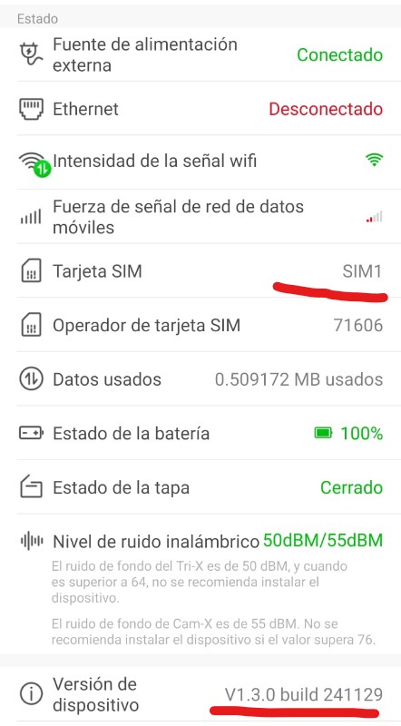

I have good news for you. I was able to solve the problem that the Sim card was not detected. What I did was disconnect the power and let the battery drain all day until it shuts down.
The next day I turned the power back on and apparently that reset everything. As soon as I connected it, the system sent me an alert via SMS. Now the device is updated to version 241129 (the latest) and the Sim card works perfectly.

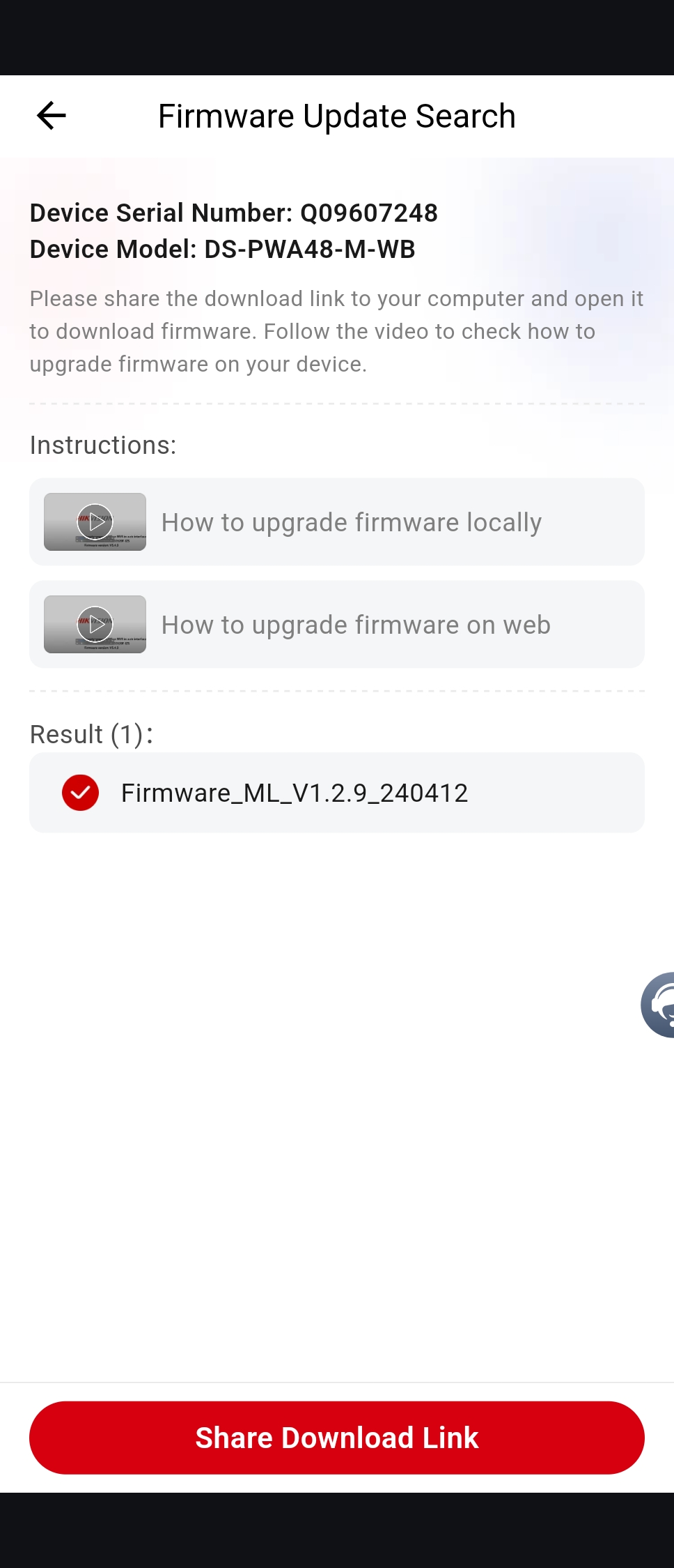

To me, the latest version available to download at HikPartner Pro is 1.2.9, the same I downgrade manually. Does the newest one appear to you? 1.3.0 build 241205?

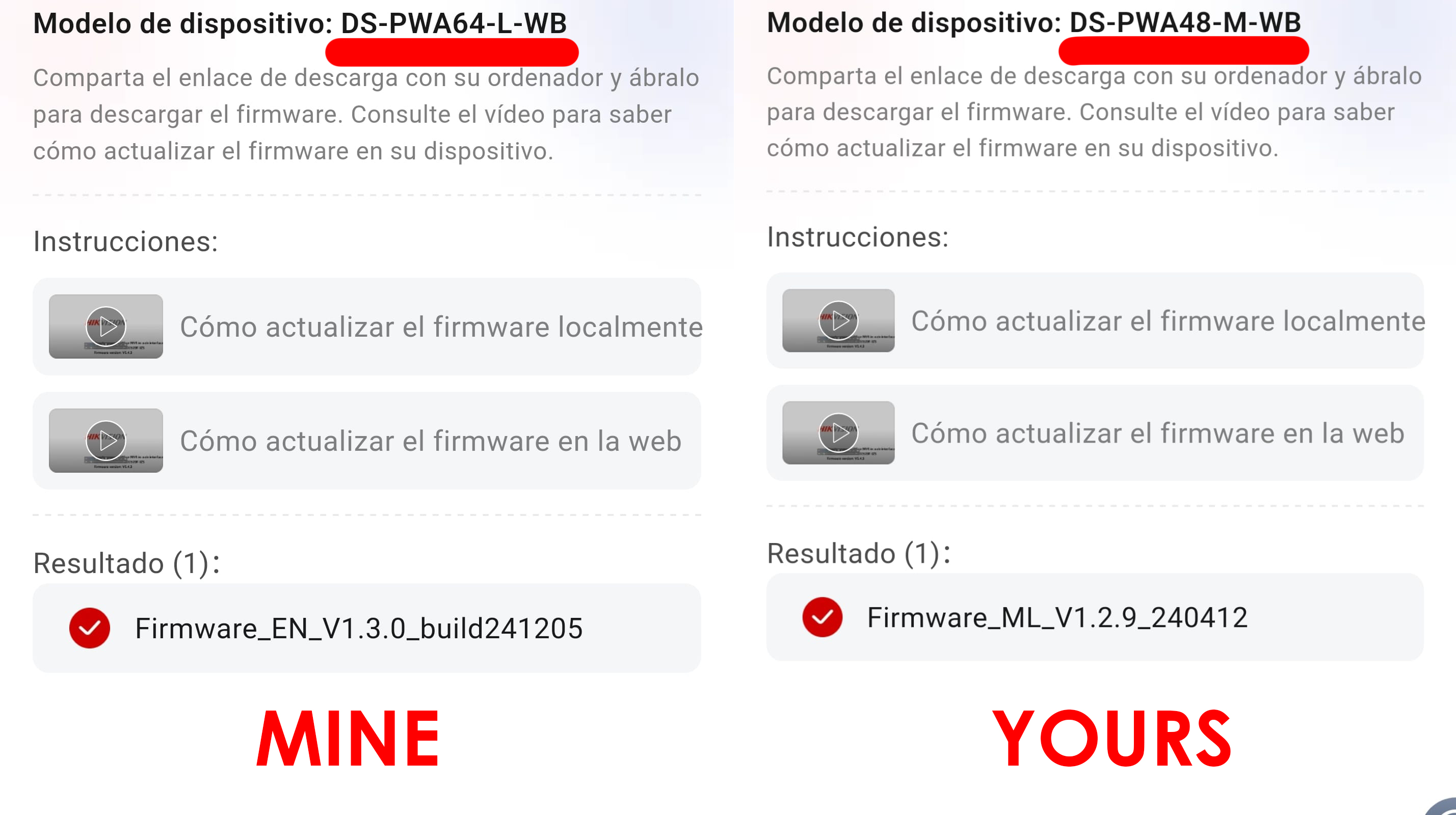

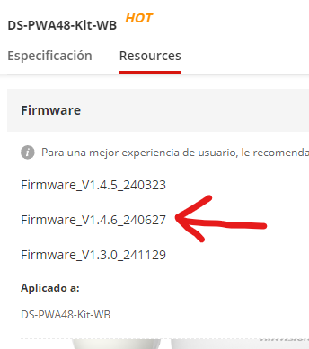

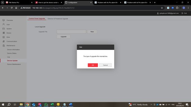

I just realized that our devices are not the same model. That's why the updates are different. Mine is DS-PWA64 and yours is DS-PWA48.
I understand that the DS-PWA64 and the DS-PWA96 share the same firmware, but not the 48. An update just came out for my device, 1.3 build 241205.
I just did a search for your model and there is an update 1.4.6 build 240627 for you.
It's confusing though, because the build number is supposed to be the release date. It says 1.4 build 240627, but version 1.3 says build 241129. I would recommend that you download 1.4 and try it.
https://www.hikvision.com/es-co/pro...Intrusion-Alarm-Panel/ax-pro/ds-pwa48-kit-wb/
