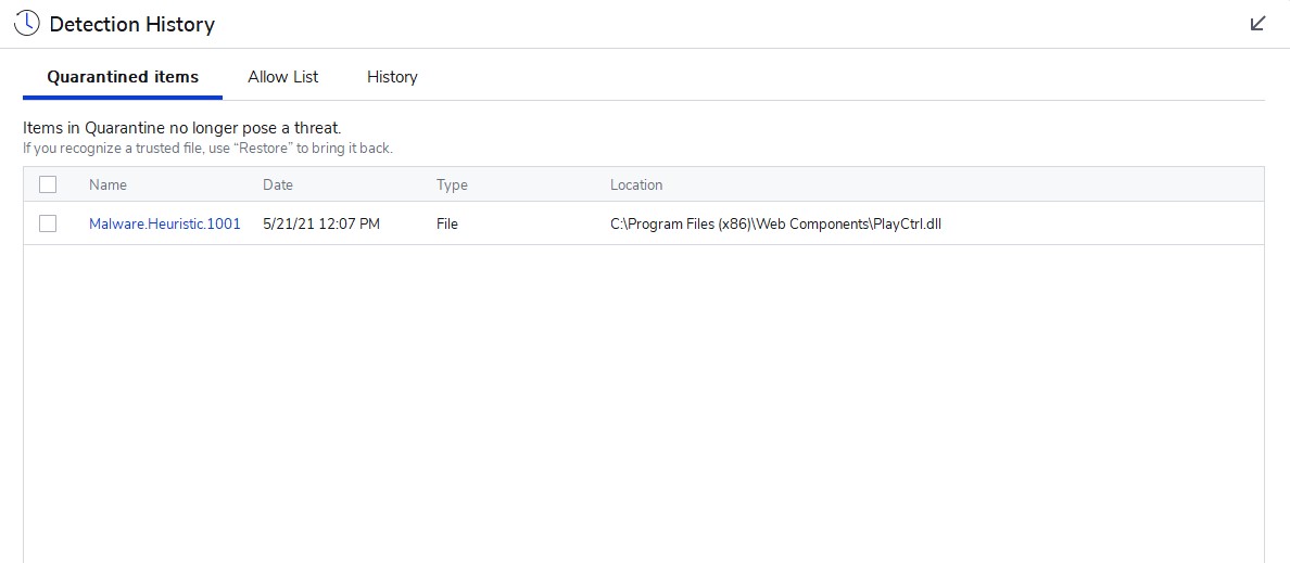

If I should be doing the formatting via IE, I have a problem in this regard because I just cannot get at my system through that anymore. When I try to get in, I keep getting a message to say that an updated plugin is available but, when I try to install it it just gets blocked by Malwarebytes.
Which way should I go about the formatting procedure please?
I have (hopefully) attached an image of the plugin that is being blocked. I have tried adding it to the 'accept' list in Malwarebytes but I can't get over that hurdle either.

Is there any reason you can't disable Malwarebytes in order to upgrade the plugin? Or add it to the whitelist?

Also, I've found the Easy Mode' and 'Expert Mode' in the bottom left hand corner but still haven't found the 'format' option. I did manage to format the HDD yesterday via IE but, as I've mentioned in another thread, I can't get fully into that at the moment (no Live View available) as the system keeps asking me to download the latest plug-in which is being blocked as Malware by Malwarbytes. Someone has suggested i disable Malwarebytes whilst downloading the plug-in but I'm a little reluctant to do that. It's a shame that we can only access Hik-Connect via IE and no other browser.
