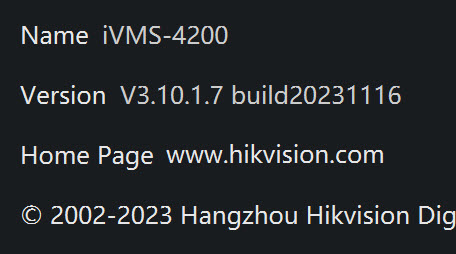

V3.10.1.7

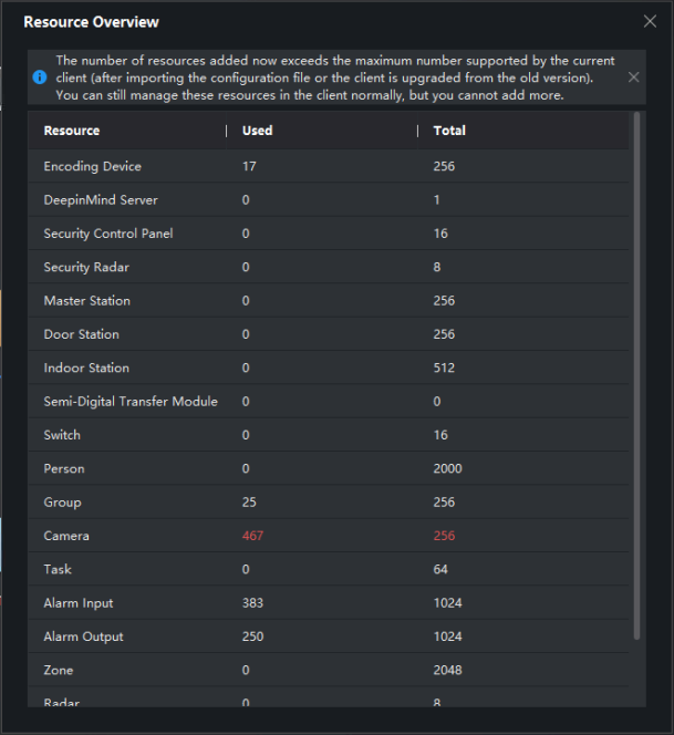

I've used multiple IVMS versions over the years and lately I have an issue with the latest version 3.11
I have over 440 channels and when I tried to import a new NVR, the NVR was imported but no Live view group was imported. I've tried to create a group trough various ways but unfortunately nothing... Then I remembered about the 256 cameras limitations and had a look in resource overview where surprise! I can see that I clearly have over 256 and the info message says I can "handle them" but i cannot add more!
I've downloaded the 3.5.0.9 E version from the above link and played with it a little but the strange part is that in resource overview it says that it supports still 256 maximum cameras...
The question is... For those who were able to add up to 1024 cameras, did you all used the 3.5.0.9 E version or is there another 3.5.0.9 version ?? I had a look online but I can only find the same 3.5.0.9 E exe that was posted above...
Appreciate any kind of input! Thanks!
