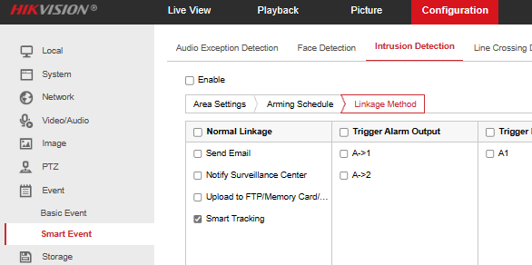

Hi @shaunj187na ... I have this setup using a DS-2CD2387G2-LU line crossing event to send an old model DS-2DE4A320IW-DE PTZ to a preset... but, when the PTZ gets to the preset, it seems to take several seconds before it's ready to start smart tracking... so, I have the PTZ preset adjusted to where I expect the target to be several seconds later... then, it smart tracks, but only as well as it smart tracks overall :) ... works ok. I imagine newer model PTZ's would work better.
There is a possibly better method where you have an intrusion zone (or some other smart event) set up on the PTZ where the preset lands, and smart tracking gets enabled then... I think it's supposed to pick up the target better... but again, with my PTZ the delay after moving to a preset complicates things.

It seems my tinkering has broken the smart track on the line crossing, it still works on the intrusion detection which i find strange. I have done a factory reset on the PTZ and have only logged into the PTZ's web interface to enable smart track, set initial position and the Max zoom depth.
I have been told to set all events via the NVR only. Even though i have had more success from within the PTZ itself.

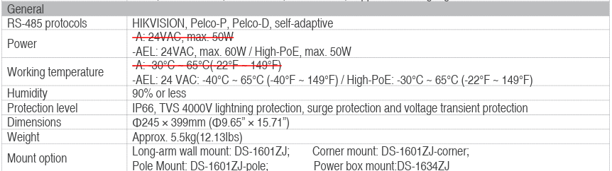

Have you or anyone ever used a 60w POE to power the DS-2DF7286-AEL ?
This Link Suggests it can work...
Howdy @shaunj187za ... I don't have that camera... my old PTZ is connected to a PoE port on the NVR and only draws about 10W... from the specifications you provided it looks like a 60W PoE injector should work?
